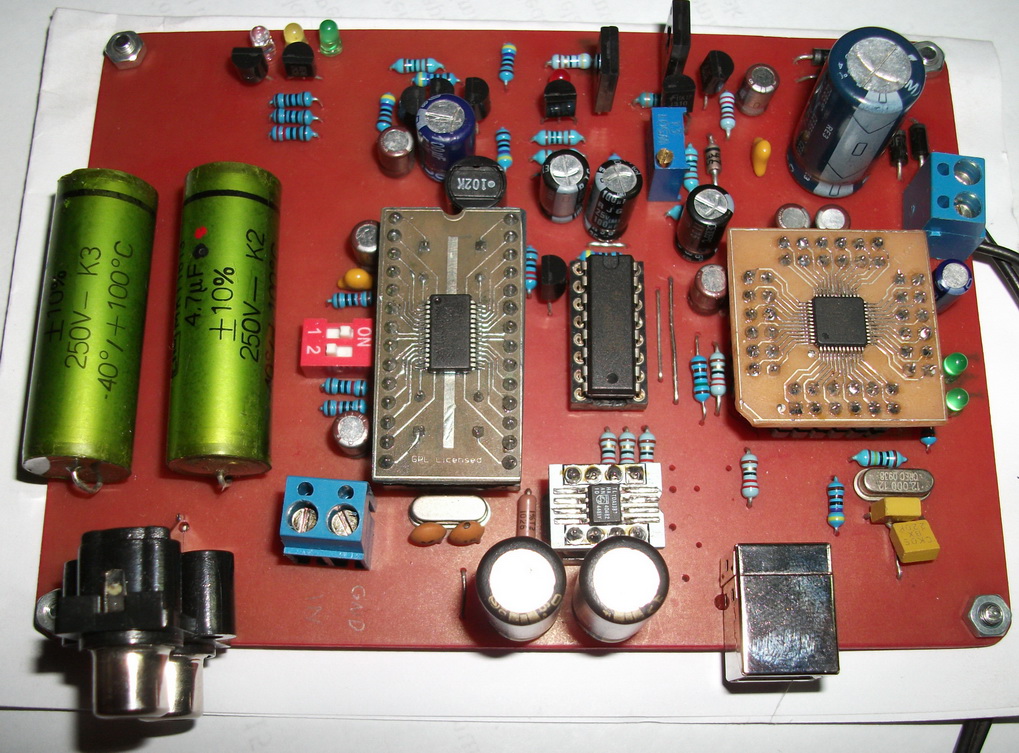

What are you using to solder this smd board?I don't have solder paste
So you soldered parts by hand?
Valery what are you using for smd soldering?
Yes, by hand. This is only the second SMD board I've built. The parts aren't difficult but I didn't like trying to solder the electolytics. Those would be much better as through hole.
Hi Thimios,
I use the flux paste - the picture is >HERE< - and a sharp iron. I also soldered everything by hand so far, electrolytics went pretty much ok - just applied some paste, aligned the pins and touched the edges of the pins - solder goes further, covering the whole pin, as a liquid.

Any cheap toaster oven works. An easy to use temperature dial is a plus as you need to adjust the temperature as it cooks. Digital push button controls are a pain for this. I'll post a picture of my oven when I get to the office.
Yes you cook smd electrolytics. If you look at their data sheet you will see a chart similar to what I posted.
The whole concept of SMT was to speed board production because of little through hole stuffing and one shot wave soldering. The only real learning curve is how much paste to use. You usually use too much and get blobs and bridging on small parts but thats quickly fixed with a solder sucker or some wick. The most time consuming part of assembly I find is digging through all the boxes of parts. I haven't found a way to organize pieces so I leave them in their tape it their shipping bags for labling. It's slow sorting through 100 bags of resistors.

This is paste with solder mixed in. A tube goes forever. It usually dries up and gets thrown out. I don't think I've ever finished one.
High Tech SMD Oven
This is my oven complete with old Sesame seeds and bagel drippings. As my SMD ovens die I reallocate me food duty ovens to SMD and buy a new one for food. Cheap controls are best. It seems the more expensive ones are prone to hard failures in the element drivers and they don't shut off. They grow a layer of goo from the solder smoke that's impossible to clean so they get pretty nasty looking.

I did use the Flux paste from Mouser for the electronics. It is just flux though so I really have no idea how well the solder flowed under the pins. There is only the tiniest tab sticking out past the edge of the part. Not much to get the tip of the iron onto. They feel solid so I'm probably OK. The resistors and small caps were easy. I simply tinned one pad then heated it as I placed the part with tweezers and then soldered the other pad. I have one of those large lighted magnifying glasses to look through. It's a huge help for these tiny parts. I do want to try the toaster oven trick. I will hit some garage sales. Those things show up all the time for cheap.

All I've ever seen is a fill date on the tube. I run it until it become too thick to pump out without getting huge blobs of it. That's usually a year or two. The little needle needs to be flushed out every time you use it. I've got a gun coming today to put the syringe into. That might make it a little easier to control.

Another caution, pop-corning, that is when the plastic package takes on too much moisture. this is why you get parts in a sealed bag with desiccant and a humidity indicator. if you leave parts out for extended periods of time in a humid environment and then process them, you take the risk of damage or failure. you are supposed to store in temp/humidity env or pre-bake to drive out moisture. one of the first thing you check at a mfg location for qc. no risk if you hand solder. so there you go, some smt 101 for you today.
