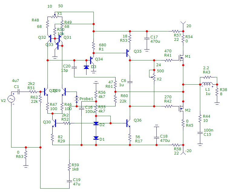

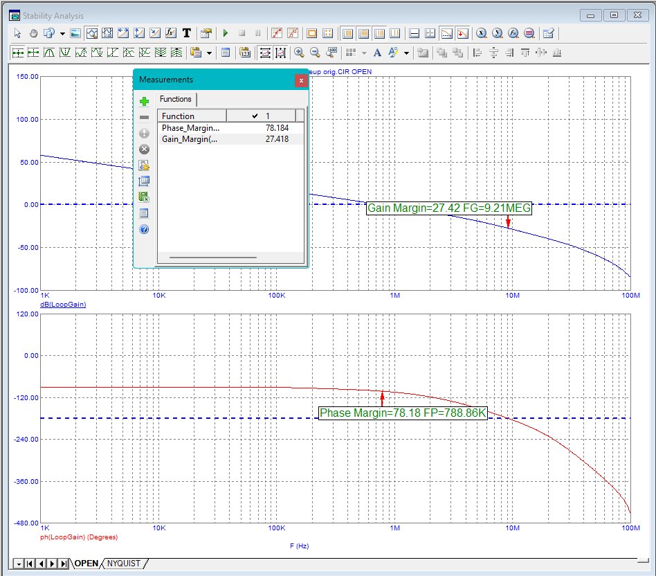

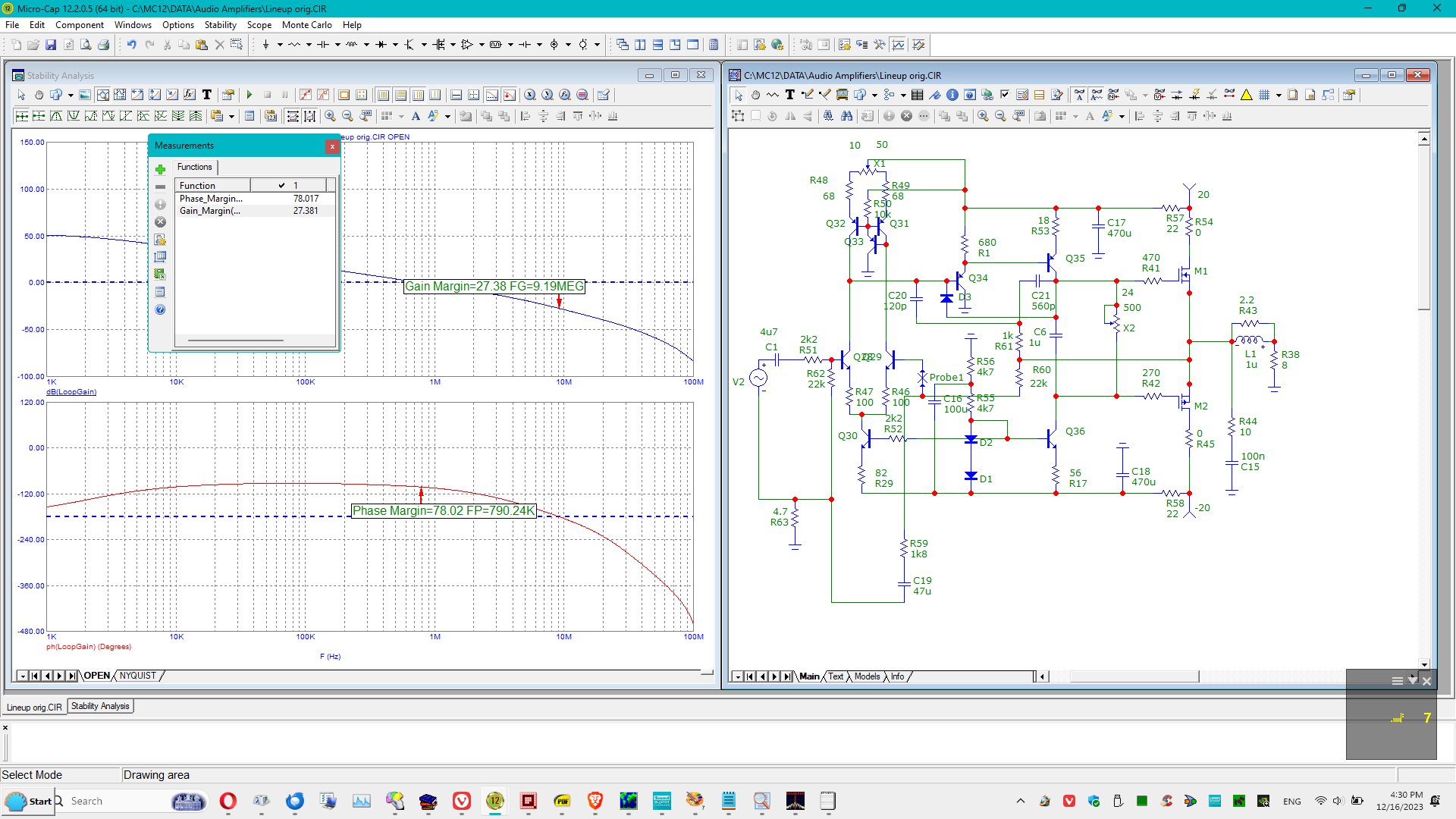

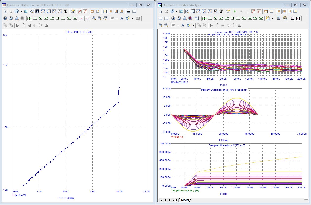

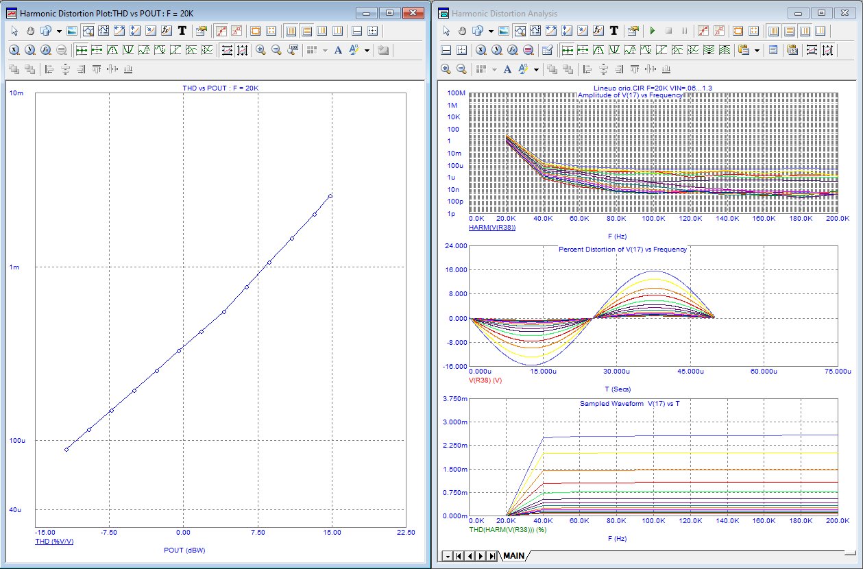

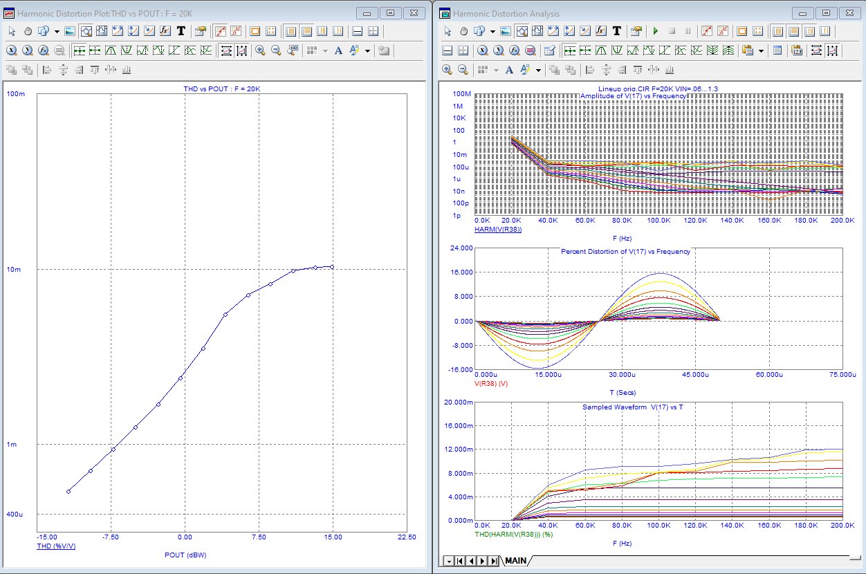

I took the liberty to sim the ~original amp in ucap and applied some modifications. First was to remove the 4.7 ohm "hum" resistor (mod 1, see stability pic). Next was a mod of the compensation: changed compensation to what strictly speaking is a change to nested feedback (mod 2). With MOS output devices this is stable and even enough so to allow a phase margin of 45 deg. Mod 3 shows what happens to 20k THD w/o the clamp diode: single digit ppm territory, good enough for most. My presentation might be a bit messy but maybe lineup can use it.

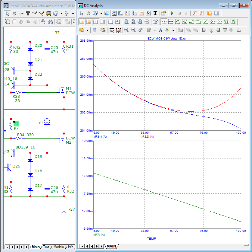

BTW quiescent current as f(T) can be controlled with the current source topology of the LTP, but will depend on the value of Iq through the mosfets. I get this curve with current regulator diode J511 which might be OK at 20V but implies ~20W per amp at 37V.
Reactions: Alexandre
I have simulated the circuit (in post #366 above) in LTspice, using the Tian probe method.
Gain Margin is about 21dB
Phase Margin is about 74 degrees
Distortion at 1watt @ 1KHz =0.000047%
Distortion at 1watt @ 20KHz = 0.0073%
If you want to use a smaller output inductor say 1.5uH the phase margin increases to about 75 degrees, gain margin stays about the same and distortion increases to 0.0084%

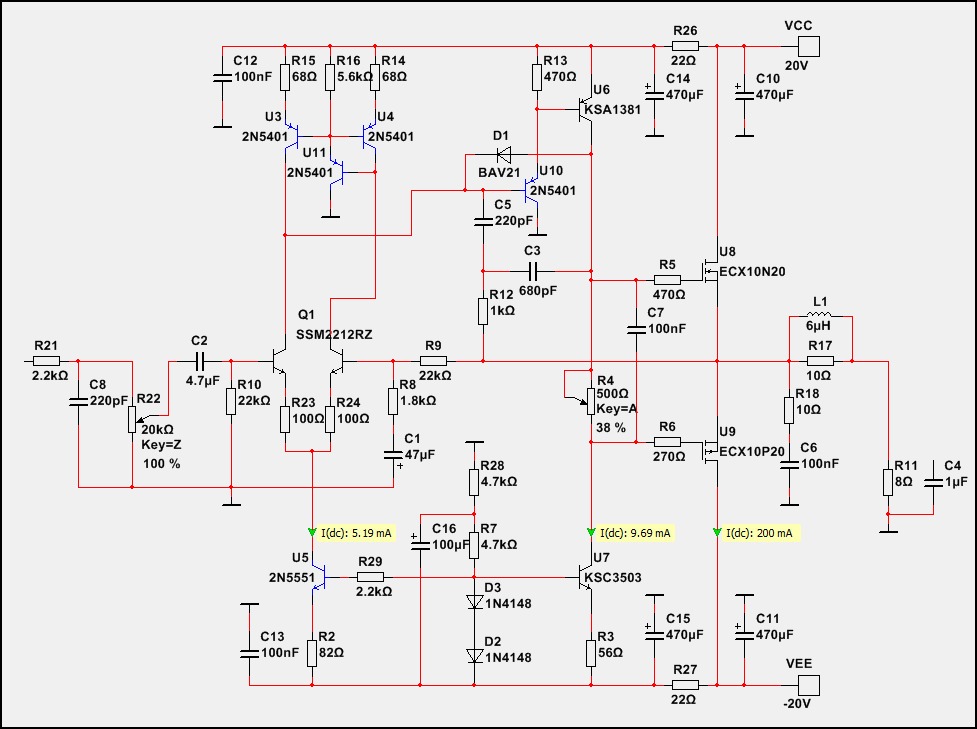

This is my new circuit.
Hum Breaking Resistor was removed.
DC-offset adjust was removed. As we use dual matched transistor in the input there is very low offset anyway.
TMC was set for lowest distortion. THD is now 0.00005%
Lineup, why do you not want to do a Loop gain plot per post #354? PMA has also explained to you why you should do this. focusing on distortionn without an understanding of how the amplifier control loop is behaving is flying blind - loop gain analysis is the most important design step in any amplifier design - what is your ULGF? Phase marging, gain margin, closed loop step response, behaviour with capacitive loads etc - these are all questions that have a critical impact on amplifier performance.
If you do the plot, people here can show you what to look for so no need to worry about that 🙂

Anyway here is the latest which fixes 20kHz squarewave.
This was done by changing the TMC.
Input filter was also changed.

Regarding loop gain, I learn something new on this forum nearly every time I visit. I would encourage you to do a bit of research on this - there are many threads discussing it. Bonsai, myself and others have provided examples of how to perform it. It's really not that complicated.
  1. Run the AC sim as illustrated on the numerous examples. My post #337 shows the Tian method in LTSPice. @Bonsai's post #354 describes another method for assessing it. @ItsAllInMyHead provided a link in post #333. @PMA provided a pdf in post #335. I'm sure there are other posts with guidance that I'm missed.
  2. From the plot, find the frequency where gain is zero. This is the Unity Loop Gain Frequency (ULGF). This represents where the level of feedback to reduce open loop gain has reached zero.
  3. Now, find out how far down the 180 degree crossing. The minimum for stability is often quoted as 10 db and 45 degrees down. However, as others have stated, having a bit of cushion helps. I think most designers would like to see at least 15 db and 60 degrees, if not 20db and 70 degrees. Look at the plot in my example at post #337. This first cursor is the ULGF (@Bonsai provided guidance on this in post #358). You can see it crosses around 1MHz. You can see that the second cursor is positioned where the phase has dropped to -180 degrees. The difference between the cursors is your gain and phase margin.
Hope this helps. And if you have a chance, Bob Cordell's and Douglas Self's books on Amp Design discuss this at length. They are excellent reads for those interested in Amp Design.
