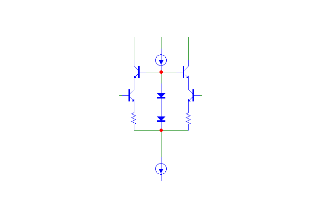

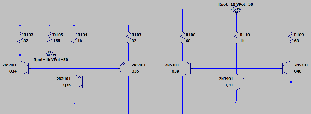

Hi all.
I just noticed that the ltp is running at ~7mA, which is all passing through the wiper of the trimmer..
Personally I think that seems like a lot. I would like to suggest a small change to the current mirror.
I think this should be about equivalent to what you have now. And in case of a trimmer fail, it wont kill the amp.

I haven't done a sim to see if it has other side effects. I just think this is safer.

Other than the benefit of well behaved DC offset, having the bases see the same impedance makes for a better harmonic profile at low frequencies, believe it or not. Ratios between harmonics and their overall levels. At least I remember seeing this in the simulator a while ago.
What are the mechanisms that affects the harmonic profile particularly at low frequencies, and how low frequencies are we talking about?
Besides the DC offset which is a given, are these claims in the above quotation based on simulations only?

Hi all.
Edit:
IT is 5 mA through the pot.
Yes I see what you mean. I might try your suggestion.

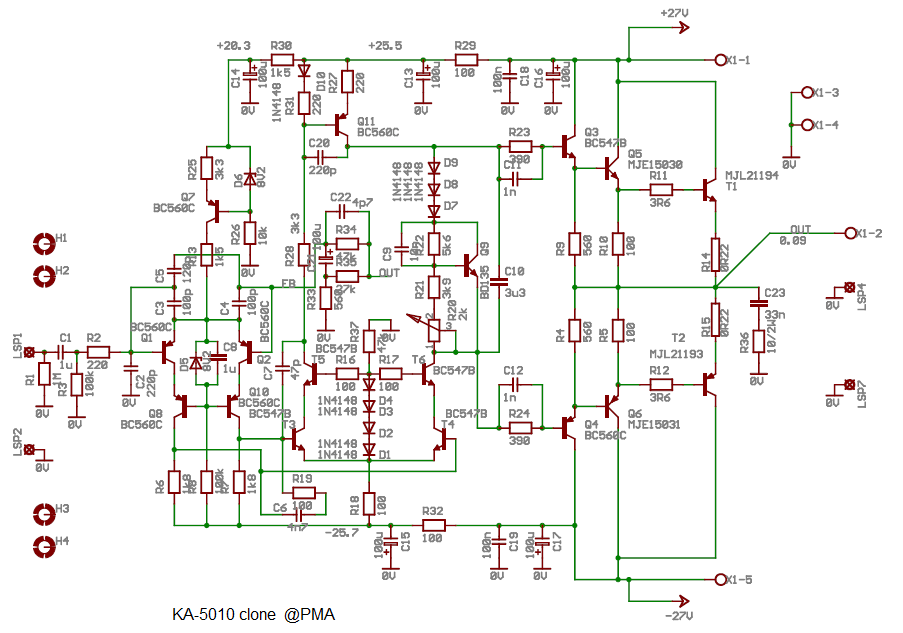

It should have three diodes instead of two... above. To give a decent Vce for the differential.
I might try cascode.
Do I simply use 1N4148 diodes or what?

But I have changed the DC-offset potentiometer as suggested.
This was done.

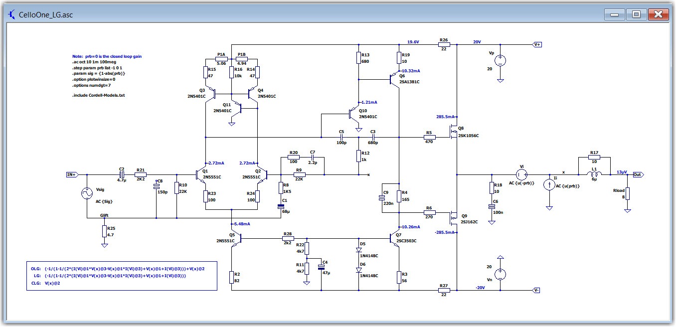

Is there an LTspice schema for this amp - I'd like to run a loop gain plot.
Loopgain analysis is absolutely necessary when designing any feedback amplifier. No designer can can be considered serious if he does not use and does not show loopgain analysis. Sorry @lineup that I am that open or maybe harsh, but it is the naked truth. You cannot be considered serious unless you do not learn what is loopgain and how to test it. You have been here about 20 years and it was time enough to learn. It was discussed and lectured in dozens of cases. Anyone these days can put some components into the simulator. But, without a proper knowledge, it does not make him a designer. Just a mere user of SW tool, and that is the big difference.
Reactions: brianco

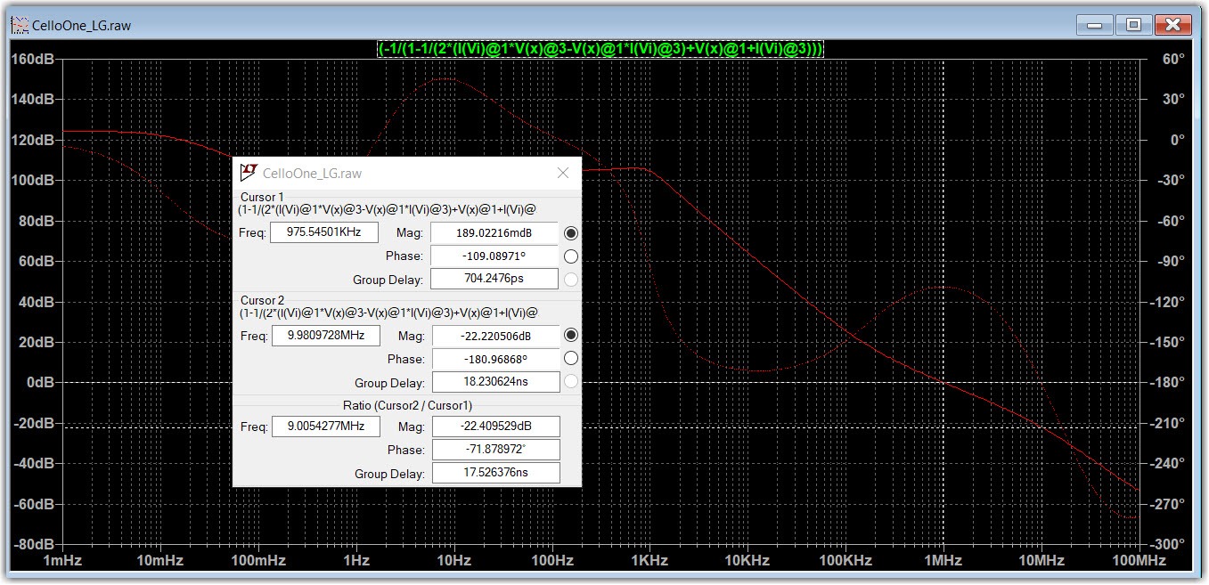

Here is how I perform Loop Gain analysis using the Tian probe method. The LT Spice asc, plot and include files are included in the zip file. Hopefully this helps out those trying to learn the process.
From this example, the gain and phase margins are 22db and 71 degrees with a ULGF of 975KHz.
Disclaimer: I have no formal electronics training and am far from an expert on this. I welcome any input on this approach.

Question for the experts:
Douglas Self mentions in the Amp Design book in Chapter 3 that his experience suggests 30db of feedback at 20KHZ is safe and more than 40db is "distinctly risky". What are your thoughts on this?
In the example above, margins looks healthy at 22db and 71 degrees, ULGF looks reasonable at 975KHz, but the feedback at 20kHz is 51db. Is this something you typically look at, and is this an indicator for potential stability issues?
