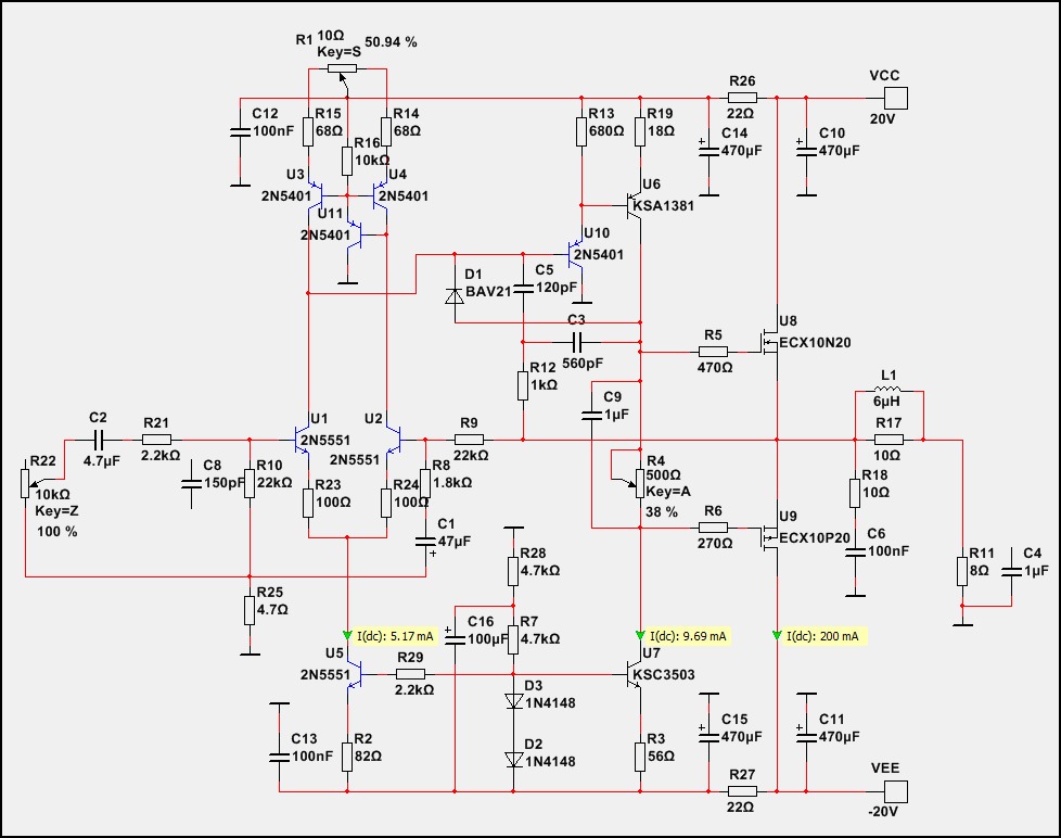

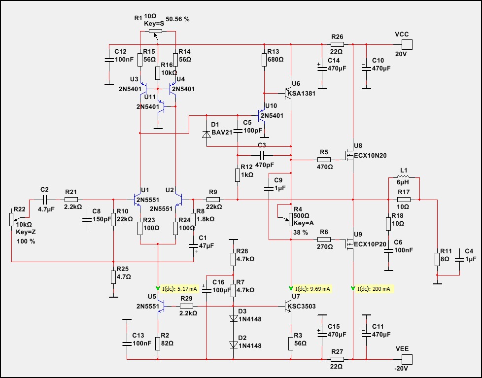

Hi all.
I remember reading somewhere on this forum, that the resistors on the current mirror should be at least twice the value of the ltp degeneration resistors.
Unfortunatly I don't remember the reason for this. Looking at your latest schematic, your values are the opposite of that, with 47 ohms on the current
mirror and 100 ohms on the ltp. Can someone please elaborate on this?

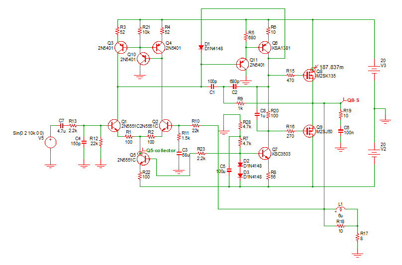

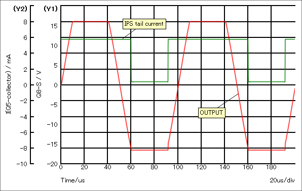

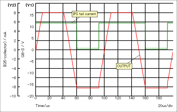

I am sorry that their advice and arguments are not understood at all.
This worst case scenario is

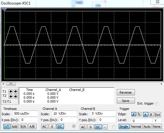

When the output is saturated at the negative rail, the current flowing through U6 is zero, so U7 becomes just a base-emitter diode.
Therefore, R3 + its diode steals most of the current flowing to the reference voltage D3 + D2.
As a result, the reference voltage drops, and the current flowing through the IPS also sharply decreases.
When IPS turns off, all positive side transistors U3, U4, U11, U10, and U11 also turn off, causing latch-up with the output stuck to the negative side.
Lineup, your latest schematics seem to approximate the worst case scenario.
brian,
Rather than relying on the results of spice or the circuits of famous designers, we recommend that you get into the habit of thinking about ``why things are the way they are.''
If you do that, I think you'll come up with the idea, ``Let's check the U5 current to see what happens to the IPS tail current when the output clips.''
In this way, simulation will become a more useful tool.
Furthermore, "U7 should generate heat, so what will happen if that happens?"

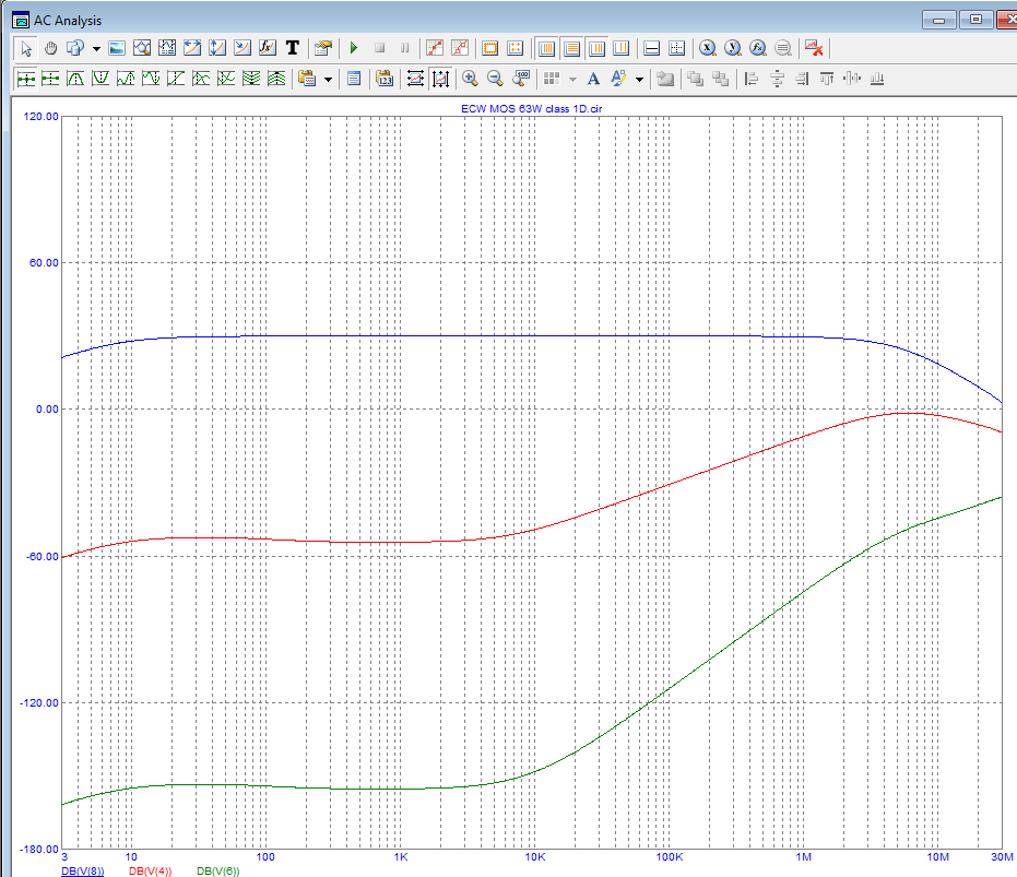

I cascoded LTP, VAS and CCS in sims and the difference was such that I'll apply it. VAS now provides over 80 dB of gain, LTP, 100 dB. However the sims regard (closely) matched pairs, probably unobtainium by now. With compensation disabled, gain plot is
Hi all.
Keep going lineup
Blameless has 100 degeneration and 68 Ohm current mirror.
I now have 100 degeneration and 52 Ohm current mirror.
Current mirror is 47 Ohm + 5 Ohm from the DC-offset potentiometer.

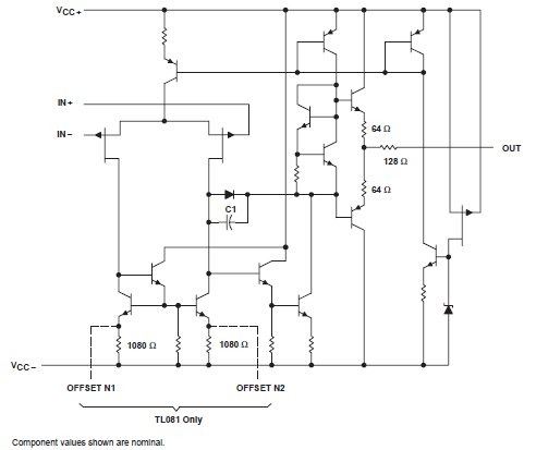

Hi all.
Keep going lineup
I think it's about noise.
The theory of low-noise design is to reduce the noise generated in the first stage and increase the gain of the first stage as much as possible so that the noise generated in the second stage can be ignored. Although you may not think of the current mirror as a second stage, it still generates noise. The current mirror's degenerate resistor generates first stage noise that is proportional to the value of the resistor, but the thermal noise generated from the degenerate resistor is proportional to the square root of that value.
In other words, by lowering the LTP degeneration resistance and increasing the mirror degeneration resistance, the first stage noise can overwhelm the thermal noise generated by the mirror degeneration resistance.
(Note that even if the noise in the first stage increases, the signal component also increases, so the S/N does not change.)
Of course, we also have to consider the noise generated by transistors, but here I am only considering resistors to keep things simple.
However, in the case of a power amplifier, it is not so severe, and if you are concerned about it, you will have to lower the values of R8 and R21 in circuit diagram #269 before that, so I am not concerned about this.
By the way, It seems strange that increasing the resistor reduces noise, so much so that even professional designers sometimes fail to notice.
When TL08x was first released, this resistance was 610Ω and the noise was 25nV/√Hz. Later, he realized that increasing this resistance would reduce noise, and changed it to 1080Ω and released it as TL07x (18nV/√Hz). After a while, the TL08x was also changed and now both are 18nV/√Hz.
You can see that noise increases when a low value trim pot is attached to the offset adjustment terminal.
P.S. Oh, and it also happens to be an answer to the lineup.

I tested setting LTP degen to 33+33 Ohm.
This really changed the amplifier. More gain and more TMC compensation was the result.
I now stick to 100+100 Ohm in LTP.
And increased mirror resistor to 68+68 Ohm. (Making them 73+73 Ohm including the offset adjust)
This gives lower compensation and lower distortion overall.

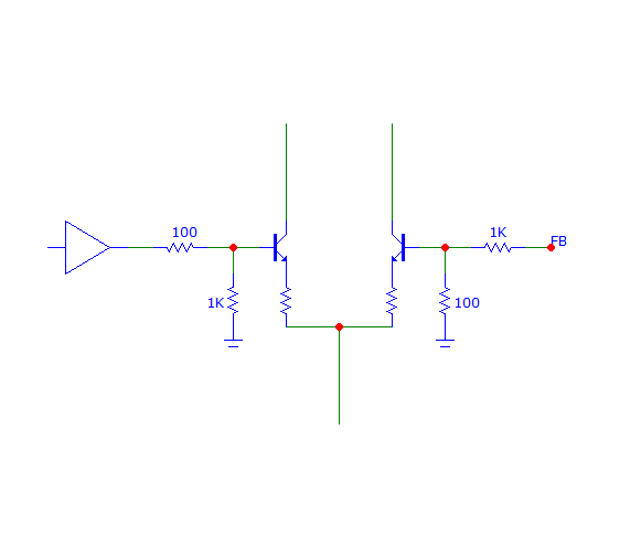

The bases see the parallel of those resistances AND you have to consider all the caps and potentiometer as well. Now you see why I used the word impedance?
Here is the thing. I don't know how much of a difference it makes in practice, I have not compared every possible way of building an amplifier. But it makes a difference, even in the simulator (if you know how to "ask"). Being the perfectionist that I am, I would go for something like this, OR, the equivalent of it in inverting mode.
