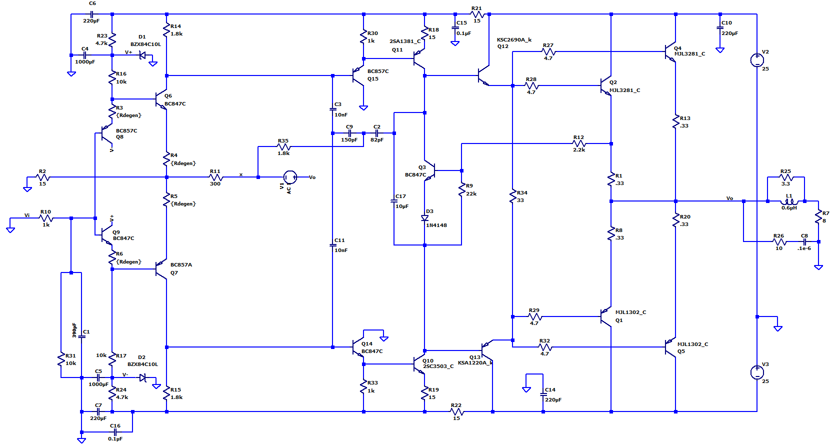

I'm not sure I follow. If I look at the schematic in post #1 and the last schematic from lineup in post #297, they are very similar. The only material change is the addition of LTP degeneration and a different IPS and VAS CCS.
The changes to the CCS is the biggest change and in my opinion, a positive change.

the schematic on the first message is no longer the original one, it is already a modified version following numerous comments and proposals.I'm not sure I follow. If I look at the schematic in post #1 and the last schematic from lineup in post #297, they are very similar. The only material change is the addition of LTP degeneration and a different IPS and VAS CCS.
I don't think so. If I look at the next schematic Lineup posted in post #18, it's very similar to post #1. And in the posts before it, there aren't many recommendations on changes.
I expected that as well. In later versions of the book he might even differentiate between NFB re BJT and MOS output devices because the difference in distortion between them (when driven from low Z) can be more than compensated for (in favor of MOS) with higher Z-out VAS and CCS (cascode) - easily verified with sims as I did already.So he does not speak in general, but about a specific case. That was what I expected mentioning his interest in dominant pole compensation.
the original circuit lacked rail decoupling and gate protection, gate resistors too low, etc etc....
several members have commented that the original circuit in post 1 should have not been replaced.

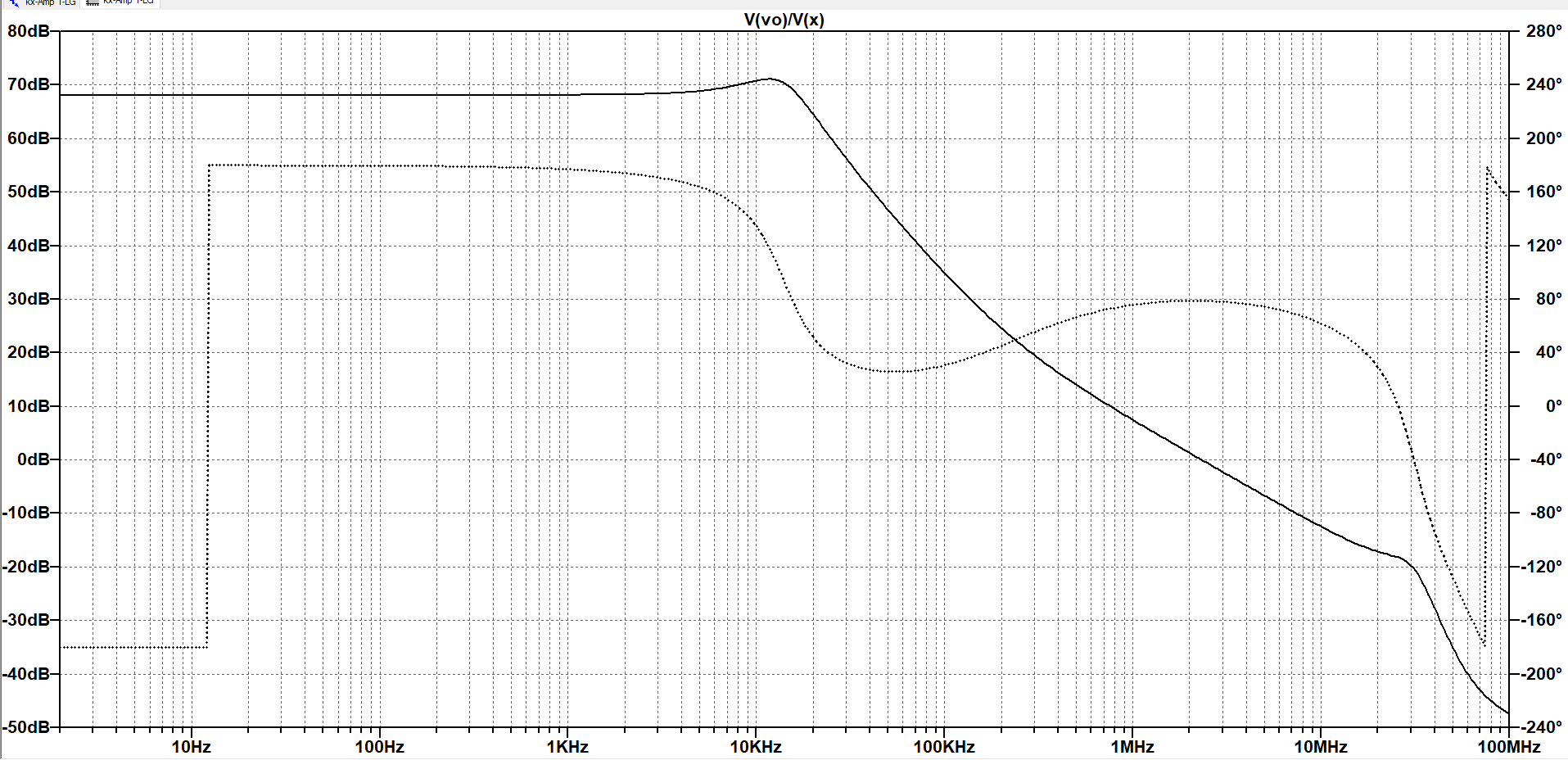

Question for the experts:
Douglas Self mentions in the Amp Design book in Chapter 3 that his experience suggests 30db of feedback at 20KHZ is safe and more than 40db is "distinctly risky". What are your thoughts on this?
In the example above, margins looks healthy at 22db and 71 degrees, ULGF looks reasonable at 975KHz, but the feedback at 20kHz is 51db. Is this something you typically look at, and is this an indicator for potential stability issues?
Self is written after that sentence as follows.
"The 30 dB figure assumes simple dominant-pole compensation with a 6 dB/octave roll-off for the open-loop-gain."
In other words, he was talking about 1-pole compensation.
This can also be interpreted as saying that ULGF is safe if it is 632kHz, and dangerous if it is 2MHz, but the reason he did not express this is because ULGF is already -12dB/oct or more due to the influence of the undesirable 2nd, 3rd, etc. poles, he expressed a loop gain of 20kHz
By the way, your loop gain measurement connected R12 to the NFB network side. TMC interpret as local feedback from OPS to second stage (VAS) and global feedback nested it.
When measuring global feedback, connect R12 to the output side. You should get a loop gain characteristic similar to one-pole compensation.

If you can do an AC analysis to check the amplifier frequency response in your simulator, you can do a loop gain analysis (LGA). This is how to do it:-
1. Save your existing circuit under a new name eg Cello_LGA
2. Remove the AC stimulus at the input of the amp and short the amplifier input to ground
3. Where the feedback resistor connects to the amplifier output, break it and connect the AC source between the feedback resistor where you disconnected it and the output.
4. Label the node going to the feedback resistor (or if your sim s/ware does that automatically, note down the node name). For our example in LTspice, I've called this node x
5. Make sure ALL feedback paths incl any TMC, Miller comp caps or phase lead caps across the feedvback resistor are on the feedback resistor connection to the AC source and do not bypass it and go to the output side
6. Set the AC source stimulus to 1
7. Run the AC analysis
8. In the output window, plot the quantity V(vo)/V(vx) (follow the waveform math conventions for your simulator)
You should get a plot that looks like this, which is a loop gain plot (this example is a TMC amp). This will allow you to directly assess the loop gain stability of any amplifier and optimise the compensation design for best overall performance
For reference, here is the circuit I used to make the above LGA plot, so you can see how the AC source is arranged:-
Looking at the output mosfet being driven directly off the VAS, I do not think that should be a major issue here - I've seen that done on a lot of mosfet amplifiers. It might however be an idea to decouple the bias setting resistor with a 1-10 uF capacitor since the device input capacitance is not linear.
If referring to amplifiers that are Miller compensated - so have a single dominant pole at just a few 10's of Hz - then the only way to get 40 dB loop gain at 20 kHz is to make sure you have enough LF gain to do this ie you have to raise the open loop gain, BUT, it also means when you close the loop the unity loop gain frequency (ULGF) will go UP. The risk of that is you are then flying very close to the output stage HF pole which comes with additional phase shift and may make the loop unstable. The other risk is that you trigger HF instability in the OPS - this is a separate mechanism from loop gain stability. So, in general, for Miller compensated amplifiers, the useful loop gain at 20 kHz is around 30-35 dB. This is what Self is saying in his statement.Question for the experts:
TMC/TPC do not suffer this issue because you do not have to increase the loop gain at LF to raise the loop gain at HF - which is what you must do with Millier aka dominant pole compensation. With TMC/TPC, you simply shape the loop gain response using the appropriate RC network(s) to cause it to drop off at 40 dB/decade but then revert back to 20 dB/decade before the amplifier ULGF. Both of these techniques have come into vogue over the last 10 years or so (although Self mentions TPC in his 1996 edition) because they were popularized by Cordell and Edmond Stuart - and specifically TMC because it does not suffer from closed-loop peaking which TPC does.
For modern sustained beta bipolar devices, a good rule of thumb for the ULGF is:-
EF (ie single follower device output) ULGF = 3 MHz
EF2 = 2 MHz
EF3 = 1.5-2 MHz (with additional steps to prevent parasitic instability - see for example Wolverine Amp)
Although mosfets in general have higher fTs, once you get beyond 3MHz, the layout becomes very important, so you really have to think about that. So for mosfet OPS, the recommendation is 3 MHz
(BTW I am not an expert, just a committed amp builder )
Thanks Mason!By the way, your loop gain measurement connected R12 to the NFB network side. TMC interpret as local feedback from OPS to second stage (VAS) and global feedback nested it.
