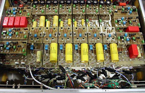

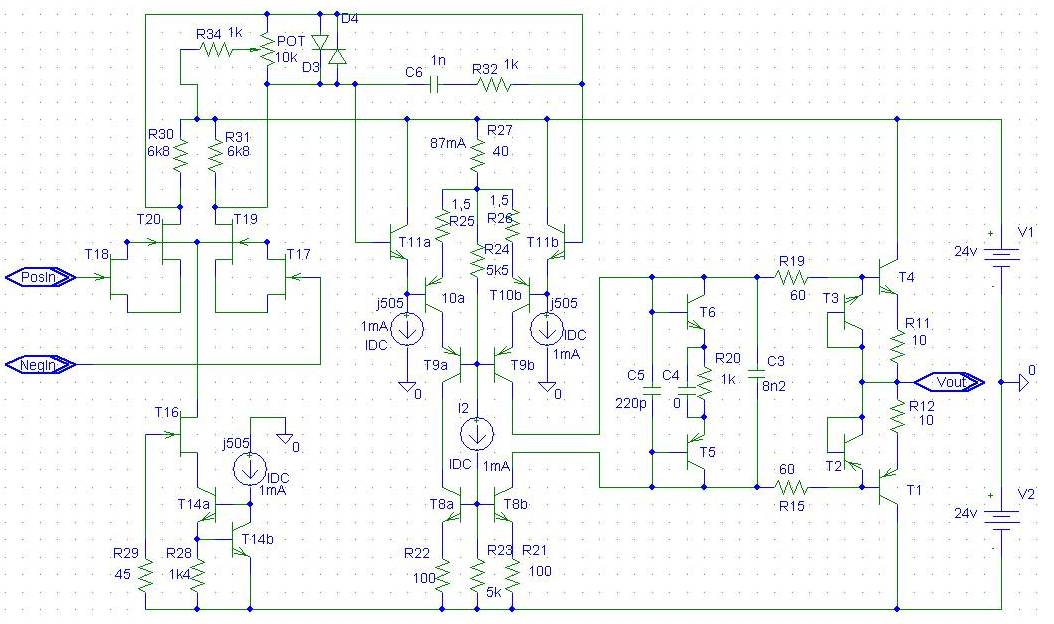

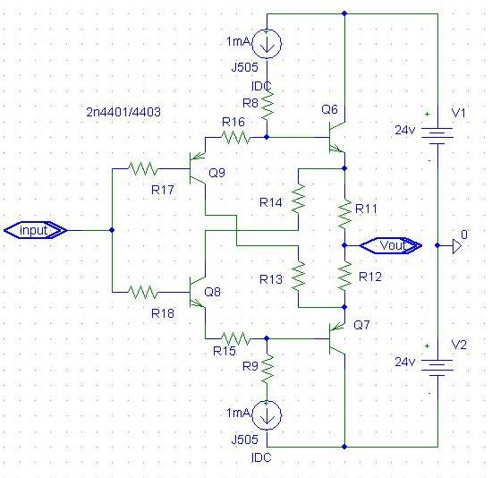

Carl_Huff: yes indeed. I have also studied the schematics closely (I think I even spotted a mistake... R153 should probably go to the positive input of A112B instead of the negative).
However as you can read in Burwens text he is delibaratly using 'low' impedance pots etc to keep noise level low, and also taking care not to overload the opapms outputs.
Anyway: So we know that in the "Audio Palette" (not to be mistaken with the cheaper "Audio Palette Preamp" which features opamps) they used discretely built modules instead of all those opamps. When you look at images of the inside of the Audio Palette you can count : 3 opamp modules on the left, six OTA pcb's, six buffers, and finally 3 opamp modules on the right. ( note that you only see one channel from the top, the other channel is mirrored and can be seen from the bottom).
Now this must mean that they made most of the buffers redundant, and that they probably incorporated all of the frequency 'arms' in one opamp feedback loop instead of two. Now it starts to look exactly like the RANE constant Q EQ from Rod Elliots site, the only difference being, that in the Audio Palette the potmeter feeds the input of all the filters, whose outputs are summed into the feedback loop, whereas RANEs approach sends the output of the filtersections into the potmeter. It will probably not make a big difference anyway.
By looking at images from the internet I have managed to reverse-engineer all these modules topology. Note that ofcourse there can be mistakes, and I dont have all the component values, but you can certainly get an image of what is going on. Notice that in many other Cello products the same kind of modules are used, however there are more versions of each module.
The OTA circuit (output transconductance amplifier) is most definately used as the filter, but I don't actually know for sure where the buffers are used ( before or after the filter, or as buffers for the feedback loop lines). The output impedance of the OTAs must be quite low, since it is running with huge standingcurrent, so I am guessing the buffers are use to isolate the filters from the potmeter. The discrete opamp circuit might also have a very low output impedance, so that is why many of the NE5532s that Burwen used are redundant.
The opamp circuit I didn't reverse engineer from pictures of the pcs in the Cello Audio Palette ( since I could not find any pictures of them detailled enough to see) but it is from the linestage in Mark Levinson ML7 which Tom Colangelo appearantly made right before the Cello Audio Palette, and that looks very much as the same BOM and topology judging from the pictures of the Cello. I regard this as 'close enough' to judge the topology of the circuit.
enjoy:
enjoy:
Carl_Huff:
Just to clarify: So the above post is my research of the original Audio Palette, obviously I only built the Rod Elliot version.
EUVL: Yes I did see that ( if you go a couple of posts back in that thread you can even see I tried to advertise THIS thread 🙂 ) and the topolgy of the EQ circuit is very similar. However the usage of passive components including huge coils and only a single bipolar transistor is obviously SLIGHTLY different from the Audio Palettes approach, and will only appeal to some people.
I am not these people, but I do respect them so I let them have it their way.
Anyway - low output impedance is might not key, when the outputs just are summed together through voltage dividers. Not that it doesn't matter, but it is possible to calculate. It still looks like the buffers are placed before the filters physically.
The high Idle current in the OTA is probably chosen to get low distortion and high speed.
