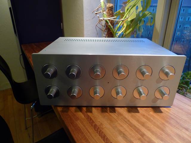

My build
All right enough about the original. I might seem suspiciously extatic about it, but I have no economic interests in Cello, or any intend to hype this product for personal gain, I am just simply amazed by the function and the geniousness of this machine – hence as a DIY-lunatic I simply had to clone it.:D

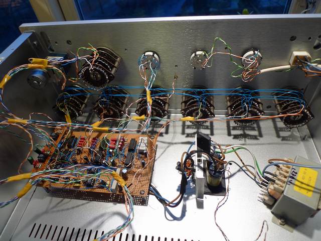

I started out with making an equalizer that wasn’t a true copy, but which did exactly the same fitted with standard pots.
I used Rod Elliots discription of Ranes constant-Q EQ circuit, which must be very similar to the concept. I was amazed of how well it worked, and really enjoyed the possibility to adjust the sound. I have CDs which are almost unbearable to listen to without eq, but simply turns into magic when I turn a few dials. Suddenly I could enjoy some fantastic music which I couldn’t before.
Allright so I was hooked, and the looks on the original is also just up my alley. So a lot of surfing went into finding the right knobs ( got them on ebay from Hong Kong), and a drawing for the cabinet was sent to modushop/hifi2000 in Italy.
I also did a lot of surfing to find some nice rotary switches. The original had some very nice in-house made 59 position ones, and the closest thing would be a Glasshouse 43 pos but they are quite pricey. Eventually I found some used 26 pos On ebay, which I bought a bunch of. It took me quite some time to clean them and to solder resistors to make linear attenuators from them.
Future plans

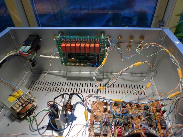

So here I am, I would say 2/3 finished, but with a working unit. The EQ board and the preamp part are made with OPA2134 and TL084 opamps on veroboards. They work, and has decent sound quality. But ofcourse I wil at some point replace the circuitry with somenthing more elegant. I have done some reverse-engineering of the original modules based on pctures, but my personal taste in circuits goes in another direction, I am thinking discrete J-fet opamps on real PCBs. The input relay board is scavenged from a autostereo demoboard.
Anyway: I have the cabinet and the switches as I want them to be, so I am going to:
a) Put some text on the knobs
b) Make a remote control circuit of volume and input selection
c) Eventually replace the circuits inside.
...But I just felt like sharing allready at this stage.
Questions? ...just shoot.:cool:
All the best from Henrik
Felixx and lowpoke: The supersexy buttons I found on ebay from a shop called Tube-Buyer, but seems now to be called U-Barn.
link I had to order 20 pcs to get them made without the groove in the top.
Felixx: The cabinet is from the one-and-only in Europe.... hifi2000/modushop in Italy.
They can mill their 10mm aluminium-frontpanels if you send them a drawing. The rest of the cabinet was painted black, so I had to swing the spraycans myself to get it silver.

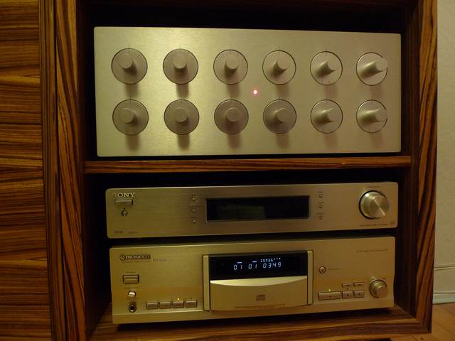

Lowpoke: I use a 10band analog grahic EQ ( modified Onkyo) for room correction, and then this one for 'music correction'.
Everybody should re-try an EQ with an open mind, you will suddenly dig out all the forgotten gems of your music collection.
