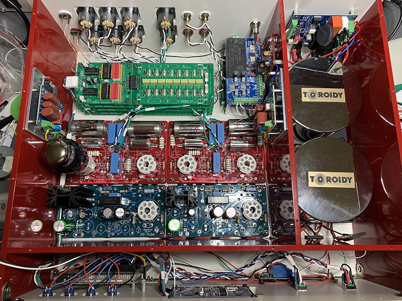

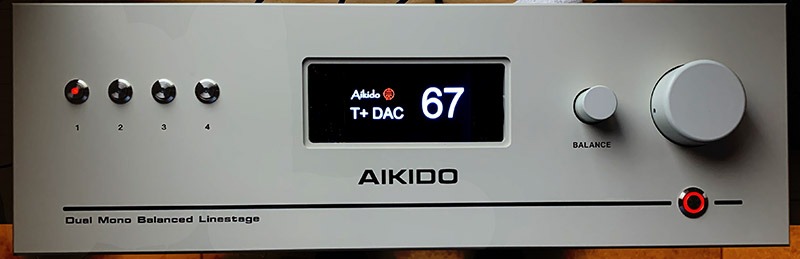

I am currently using the AMB attenuator boards in a balanced tube-buffered preamp I am close to finishing up. I wrote my own control software since I wanted to add some extra features and use a TFT display (couple photos below), but I think using Arduino-controlled relay attenuators for the band adjustments would be fairly straightforward. Depending on the band, 0.25, 0.5, or 1db steps would make sense. I'd probably make a custom rechargeable remote with six rotary encoders connected using wifi or bluetooth to the base unit (instead of trying to use optical which I think might be a bit slow and cumbersome).
This project is definitely in my "queue" but I've got another tube amp project I've started working on that I want to build first.

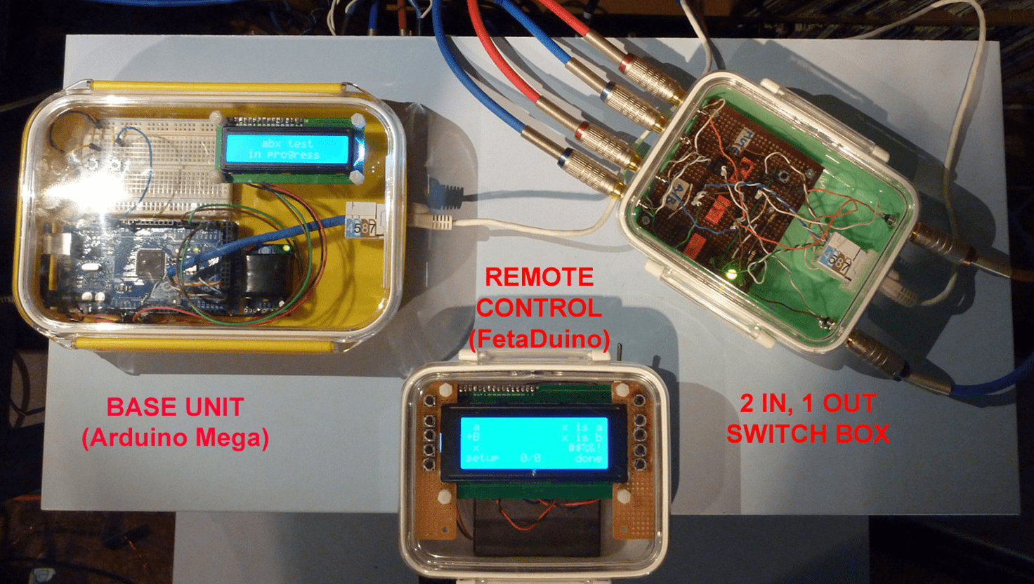

My custom rechargeable remote is in the middle of the photo. It's part of another project which controls an ABX switchbox and other relay-based boards and is programmed to do blind ABX testing as well as just switching relays. I plan on integrating this code with the LDCunio code after re-architecting the system to run on on embedded Pi or similar in the preamp. This is about eight year old tech, using xbee radios. The new system would be service-based on the Pi and eventually controlled by an app over wifi.
Controlling the palette from this would be my highest priority if there was a clear path to building one.
