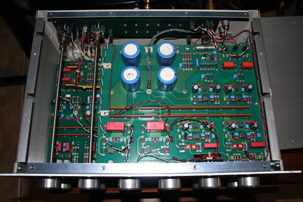

Anyway i deeply support Nrik's project. He made really good work with the case, probably he will use better circuits and parts in the future to upgrade his project.
I'm all for being able to adjust the sound. I tried many affordable units and couldn't listen to them. I only wish I could afford or build something like the OP did. I found some pictures of insides of both Palette and Audio Palette. Latter was a "cheapy" version ($6500 new), used op-amps etc, inside looks normal. There is one on Audiogon right now, sitting at $1700 already. There is an Audio Palette there as well, asking price $15500. That one is filled out to the rim!
In any case, I am tired of living with a straight wire... I wonder if there are any affordable EQs out there that would not make my ears cringe. So far - and surprisingly - the least damage was caused by the long discontinued Behringer digital signal processor DSP8024, but it's like a computer and is difficult to operate. BTW, DSP 2496 that came after, IMHO - sucked.

Tone Controls are a must. Personally I prefer a four band baxandall (variable slope) that I have developed over several decades of experimenting. Those rich fools who have no tone controls on their $5000 preamp probably also spent over $1K on their speaker wires (heh heh heh)... Your tone control unit is probably one of the best investments you could make in a system.
Linkwitz uses the OPA2134 opamps in his active crossovers (me too). They sound excellent to my ear. Put power supply bypass caps (usually 0.1uF) within 2 inches of any opamp, closer is better. If all the resistors over 1K are metal film 1%, all the caps are Polyprop or better, it's unlikely that further improvements will be audible. Using a "star-center" grounding scheme properly is where a lot of people make mistakes.
High surge current gnd. wires at the primary filter caps and bridge rectifier should join together first, before entering the "star center" gnd. bolt. I use regular 78 and 7915 TO-220 regulator chips in the power supply, but because the power supply is always directly in the signal path, and can destroy the stability (phase margin) of any high feedback circuit (opamps in this case) if it presents an inconsistent impedance over frequency , I always put at least a few uF of polyprop caps across the output of any power supply, so the opamps see a short for AC from about 1HZ to many many mHZ.
I even use separate ground return wires and power supply bypass caps for each section of circuitry. AND passive Rf filtering at the audio and AC inputs, since opamps turn to crapp when trying to deal with Rf energy that gets brought in by everything external acting as an antenna. I BW limit to 100kHZ with a simple RC at the inputs, and 0.01 3kV caps across the AC line in and 0.1uF (or more) across any electrolytics. It's often these little "side issues" that taint or corrupt the quality of an otherwise good circuit. Hope this is helpful. Maybe you already know all of this.

Some more information on the Cello Palette (introduced around 1985). Dick BurwEn did do the conceptual design for ML (I have a copy of the original blueprint schematic - which uses op-amps). ML's great designer, Tom Coelangelo then took that design and created the Palette using all discrete parts (crafted from a number of op-amp and voltage follower modules). The frequency controls were the same 51 (or so) stepped attenuators used for volume controls in the Audio Suite, another landmark ML product.
The frequencies and boost/cut amounts were 20hz, +-22dB; 120hz, +-12dB; 500hz, +-6db; 2Khz, +-6dB; 5Khz, +-12dB and 20khz, +-22dB. The Palette was available in two models - one had switching for multiple inputs. Both had an in-out switch, left/right input level controls and a ganged output control. Cello boasted that the unit contained some 3000+ parts and must have been a BEAR to assemble.
In the late 80's, Cello decided to come out with a less expensive unit (I'd say it was 85% of the functionality at half the price) - and this product was called the Palette Preamplifier. It looked very similar to the original Palette but used IC's - basically a whole lot of 627's. It's design is very similar to the octave equalizer on pages 2-53 to 2-56 of the National Semiconductor Audio Handbook EXCEPT that Burwen did not put all of the equalizer sections in parallel but put a few in series and those in parallel with the others. And for best results, the paralleled equalizer sections have to be driven from as low impedance as possible, so Tom used a 627 followed by an IC buffer to do that job.
In the early 90's, Cello entered into an ill-fated venture with Teledyne?/AR and advertised at least the equalizer, an amplifier and perhaps a speaker or two under what name?? Didn't realize that the venture actually released a few units.
3 or so years back, a friend found the remains of Cello (gathering dust after the 2000 bankruptcy auction) in a Connecticut warehouse. I got a number of parts, PC boards and the like and was able to put together a Palette Preamplifier. But I did it differently; Built the equalizer into a case separate from the preamplifier and separated the two by a 30ft umbilical. This allows me to make any necessary equalizing adjustments right from my listening position - a feature that most equalizer designers have totally missed.
The finished unit is a joy to use. Burwen realized that the midband controls don't have to have a lot of boost cut (I don't use more than 2 to 3 dB) while the extremes can use more - 22dB is probably too much - 12 to 15 is fine.
I mostly use it in a "subtractive" mode - reducing the 2-5kHz "glare" on many female CD vocals has made the difference between stopping midway through the first cut versus listening to the whole album. In the "additive mode" adding some 120Hz midbass and maybe some 20hz can really improve some other albums. As an aside, I'm amazed that on many recordings, I can "rock" the 20hz control to either stop with no effect - nothing on the material below 50 hz or so.
I believe that the key to the Palette's success was that it was as close to "transparent" as any (program) equalizer ever made.

Nrik - Your project is fantastic! What's the possibility of seeing a schematic?
