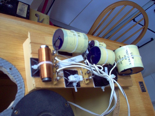

So after far to much soul searching , navel gazing, and hair pulling .. I have just put in an order. To the values found on the board, and not the schematics posted here ... For. Solen MKP 400v ... With the exception of a 600v 1uF to run in parallel with the 400v 2.2uF .. to get the 3.7 uF
On Gumtree There is some QED silver aniversary wire .. seems to retail for about 6.50p/meter .. .. I'm not sure weather to replace the old internal wiring with this.
Have you read posts #83 and #84?
The current internal wiring will be quite sufficient for the job. Change it to QED Silver Anniversary if it makes you happy.
However, this may be regarded as overkill and is unlikely to make an audible difference!
The quality of your present audiophile cable will be adequate unless you employ extremely long runs to your amplifier. Again, change it if makes you happy!
P.S. You have ordered the correct combination of capacitors - happy soldering!

694356d1532966227-celestion-ditton-25-help-20180730_165451-jpg
I've got some sort of 4 or 5 mm squared Audiophile cable from amp to speaker at the mo ..but I don't know of its quality.
Those look like good connectors.
But arrows for cable current flow in audio? Hooey! It's an alternating current!
Cables do matter. Low resistance between the amp and the crossover is obviously good. Keeps bass and mid and treble independent, and the bass tight. But if you are below, say, 0.2 ohms with a 6 ohm speaker, it should be good enough. The good engineer aims for 95% performance, because the last 5% costs a lot more. The balanced design concept which Rotel employ.
Internal wiring is such short runs, that heavy cable won't make any improvement. And is awkward. But keep it paired. That is just good practise to avoid inductance.

I don't think landlesspeasant is going to change the internal wiring, but . . .
I would encourage him not to do so as he may run into problems.
If the wires are currently soldered to the tweeters then there is a serious risk of him damaging the tweeter connections during the desoldering/soldering process.
If the internal wiring currently uses push on connectors, then he would be faced with the difficulty of finding a source for replacements and then crimping them on to the new cable.
My advice is to leave well enough alone!
