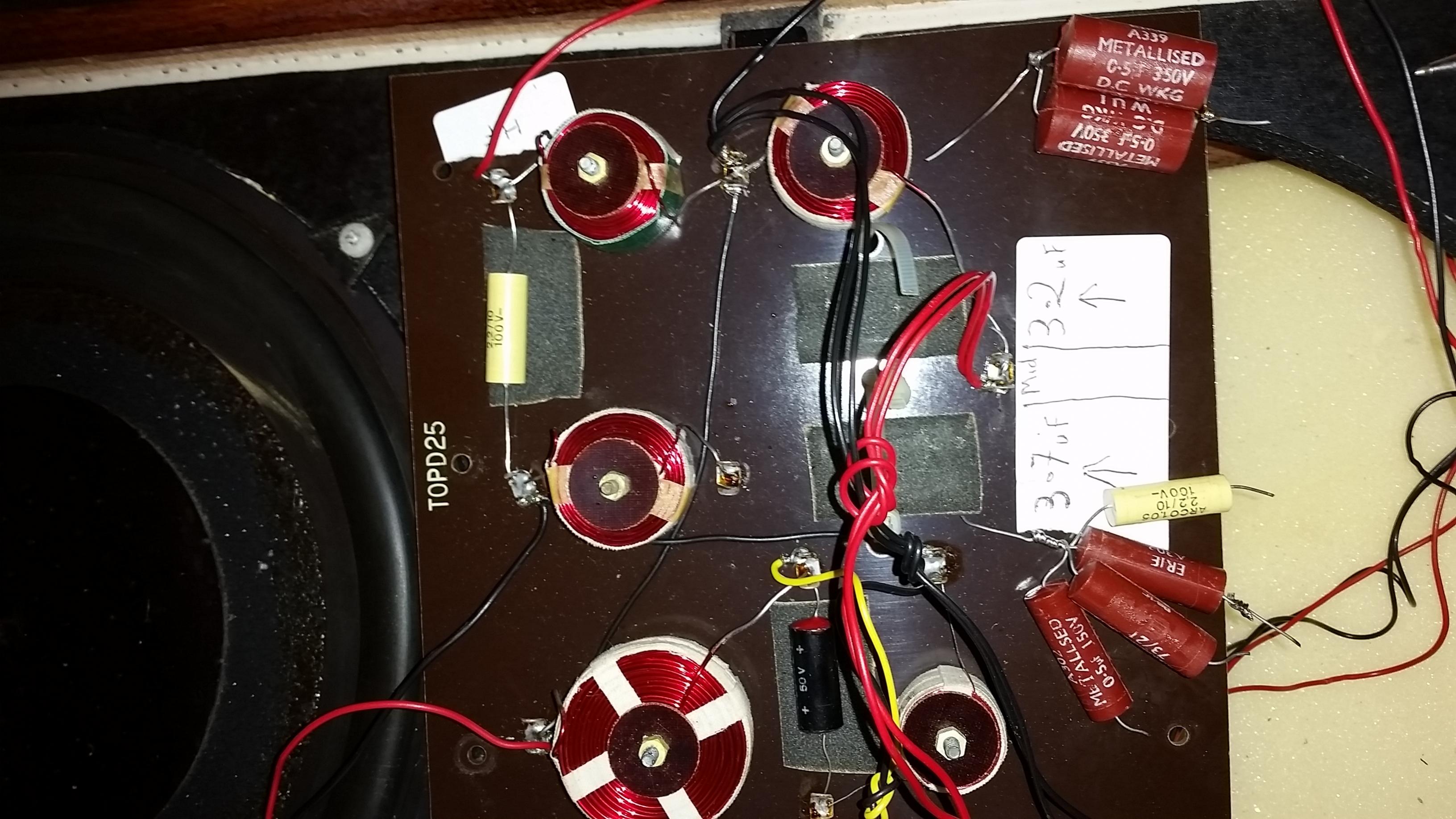

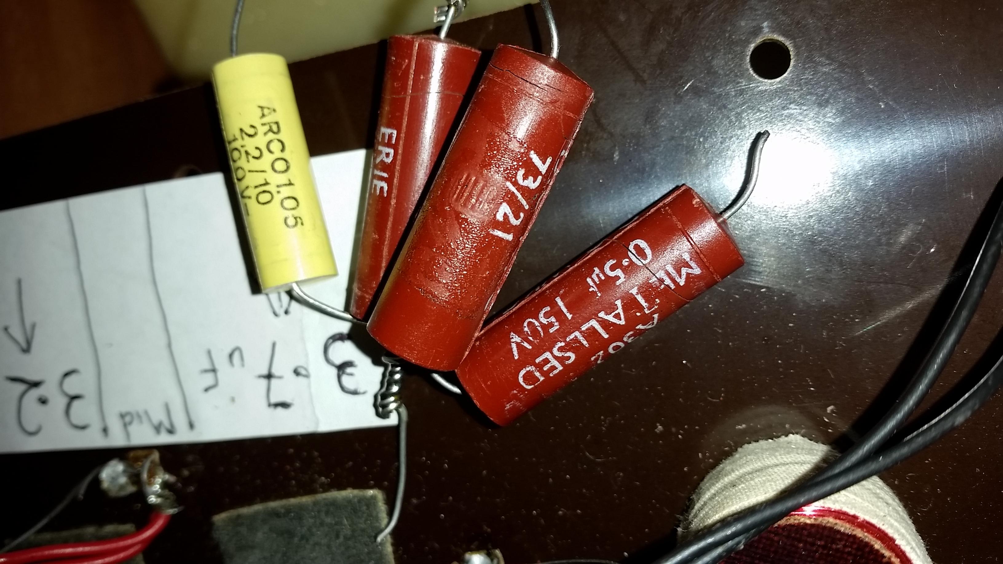

Hi there ... thanks for all the help with this 🙂
So I've removed 1 board and the values are
25 uF
2.2 uF
3.2 uF
3.7 uF
Red ones say Metallised on them ...
After reading up what i can ... I'm thinking to get all Alcap low loss .From Falcon acoustics.. If any one thinks this is a bad idea .. Please let me know ASAP 🙂

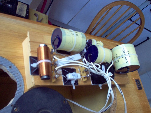

The slight bass issues may be caused by the internal cross bracing failing ... :
Just glue some blocks at the joints I think
can I mix the 50v and 100v ie ... 1.5 uF 50v + 2.2uF 100v = 3.7uf ??????????

Whoa! You don't want NP Electrolytics here AT ALL! 😀
That would be a downgrade. Everything bar the bass 24/25uF is either MKT or MKP already.
The main event would be to replace the electrolytic with MKP. I doubt if a 22uF would sound wrong, but go for 24-25 if you can. Even paralleling a smaller 2.2uF cap to a 22uF would probably be cheapest.
I think we decided that bass circuits benefit most from caps with thicker foils, so 400V might be good for the 24/25uF. The rest can be cheapish 250V MKP.

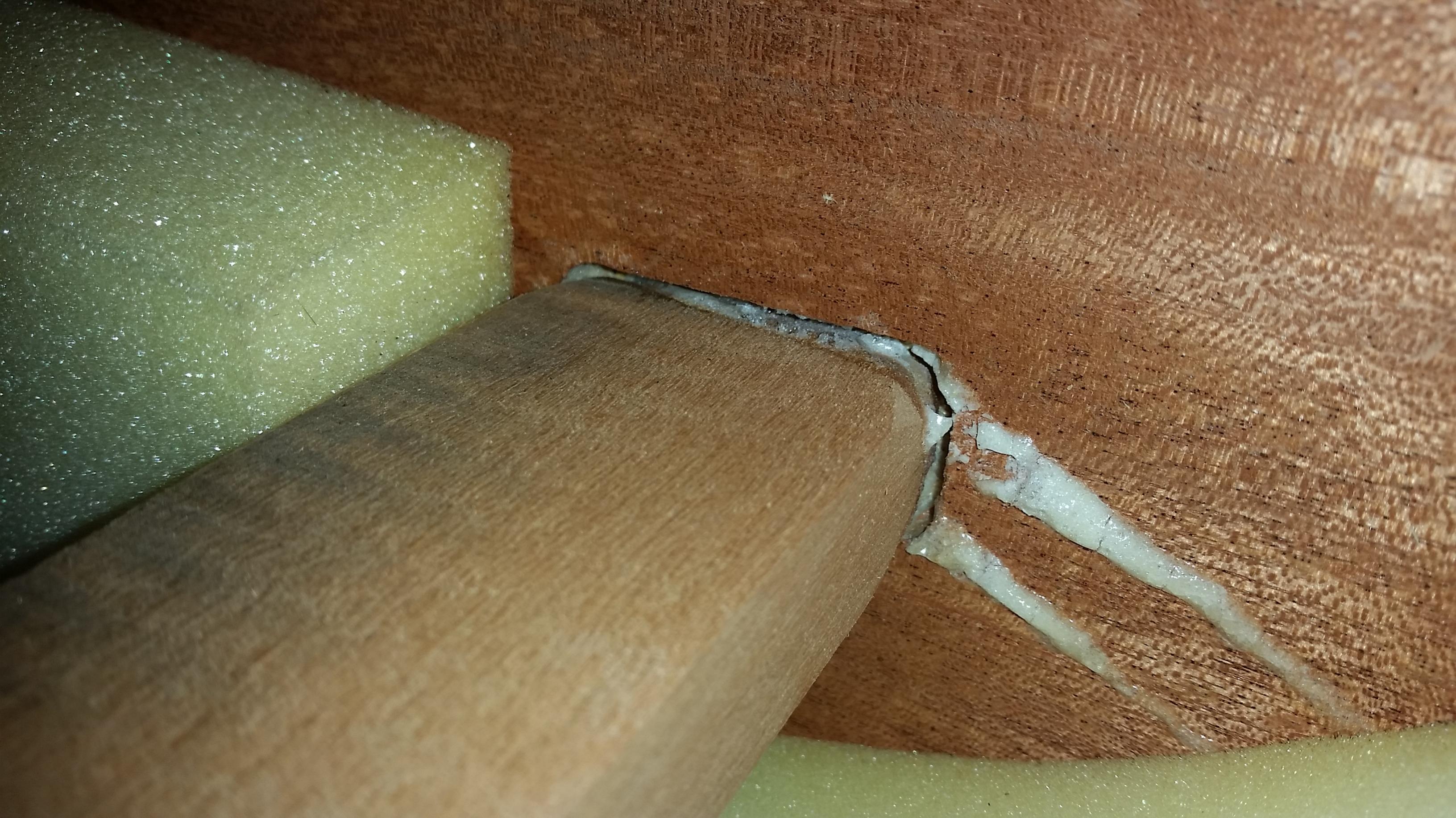

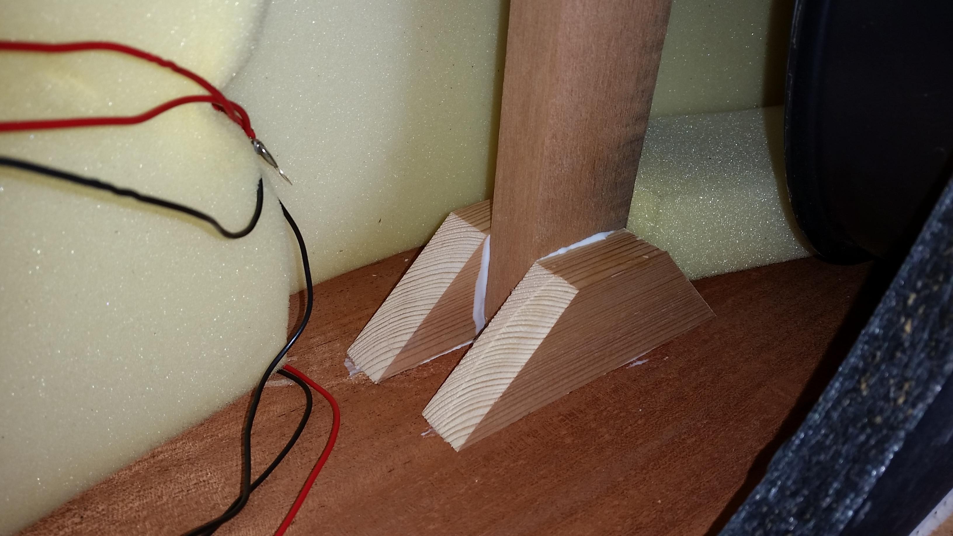

So I've just started on repairing the bracing, and upgraded the connectors
Don't overdo bracing, seriously. Braces sing there own tunes, and not always good ones. A box that flexes is best damped with heavy cork or rubbery stuff glued to the panels. Takes the problems lower in frequency, where they offend less. Which is very BBC.

The internal glue joints had failed on the brace . So I'm just adding 2 glue blocks to each end ..... I'm hoping this will be enuff to restore the joint and not to much ... But some thing needed to be done .Don't overdo bracing, seriously. Braces sing there own tunes, and not always good ones. A box that flexes is best damped with heavy cork or rubbery stuff glued to the panels. Takes the problems lower in frequency, where they offend less. Which is very BBC.

There is a difference between the newer pair and the Values from previous posts about 25's ..
my newer pair values seen = 25 uF 2.2 uF 3.2 uF 3.7 uF
and an old thread schematic = 24uF 2 uF 3uF 3.5 uF
The caps in the older thread looked like they were the older Electrolytic type
Any Ideas which values I should go with ?
