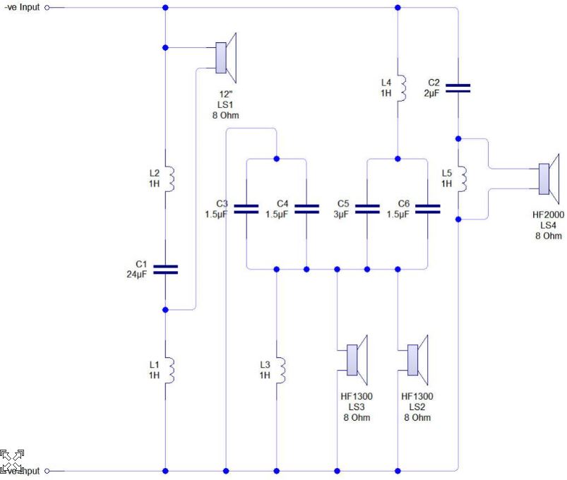

The Inductors in the 25 crossover.
I will be very surprised if all those Inductor values posted in this thread are correct , and if they are then two of them seem to have been inadvertently exchanged for their relative circuit locations.
There is a Schematic available for the Celestion 25 crossover - at least two forum members have it though neither has posted it in the thread, but if you ask them they might post it here, or they might post the values of the inductors at least.

I'm not sure that helps, my friend. You have just sown FUD here without saying what might be wrong in the schematic. We are only talking about swapping out some capacitors. In fact the only one worth doing, IMO, is the 24uF NP.
This schematic is the best we've got with the caveat that C5 is 2uF. And I see the LC shunt. But I'd be checking all this as I do the rebuild.

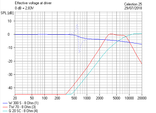

I've run the sim in a roughish way, and that 24uF/2.4mH (iron core) shunt must have resistance. We think 8 ohms. If it didn't, the speaker wouldn't work as the sim shows. Nothing stopping a resistance measurement if it's a concern anyway. It's actually a vague bit of 4dB bafflestep.
People agonise over whether 2uF can be changed to a more available 2.2uF value, for instance. Are you going to hear it? I doubt it. Might sound better if anything...
I will be very surprised if all those Inductor values posted in this thread are correct.
The inductor values are unknown since the originator of the crossover circuit diagram did not have an inductance meter.
The 1H markings on the crossover diagram are only there by default.

In my mind, and sim, I was including Dave's schematic too:
But we are only interested in the capacitors here.
Just my opinion, but I think far too much agonising went into the LONG Ditton 66 thread. Who's to say that Celestion got everything perfect? Do you really need to pay inflated prices for original replacement drivers? I always thought the Ditton 15XR was poor. And, if I am critical of an otherwise good speaker, my Ditton 44 have more midrange cone breakup than I like.
In my mind, and sim, I was including Dave's schematic too.
I apologise to alan-1-b for forgetting about that schematic!

To be able to contribute anything useful to this thread I need the inductance values confirmed.
I do not doubt that "dave" is sincere , and he certainly seems to be in the various posts I have read of his in other threads , however sometimes people can have been given a mistake in information -{ that has happened to me }- thus it will be good to have the inductors confirmed if possible.
I will explain why after I have them confirmed , but for now if someone with a Multimeter will examine a 25 crossover and find which inductor on the board is connected to which capacitors and drivers , and how connected , and measure the DC resistances of all the inductors -{ with the capacitors and the drivers disconnected }- and post all that here , then we can solve at least one of the ongoing points of discussion in this thread , that being about the 24uF capacitor , and for that we need to know the DC resistance of the inductor it is directly connected in Series with in that two-components' Shunt across the woofer.
Also useful will be: measure the DC resistances of all the drivers while they are disconnected from the crossover, and post the results here.
The woofer is probably a Nominal 4 ohm , with a DC resistance a little above 3 ohms , and the HF2000 is probably a Nominal 4 ohm with a DC resistance a little above 3 ohms but there might have been a Nominal 8 ohm version of that tweeter ?
HF1300 was available in all three of Nominal: 4 ohm , 8 ohm , 16 ohm.
It may be either the 8 ohm or the 16 ohm versions that were used in the 25.

Maybe a bit late, but i found another map on my HD.
dave
Sorry Dave I didn't thank you for this .. It is the confirmation schematic I was looking for ..
I think I shall be using these values .. Which some are slightly lower than the values of the caps I found in the speakers at the mo ... Unless some one tells me that's a terrible idea ?
The only difference between the capacitor values in the two versions of the crossover is that of the one associated with the supertweeter.
In Dave's it is a 3.0uF and in Steve's it is a 2.0uF.
A 2.2uF replacement will probably be fine, but you can always experiment by paralleling it with a 1.0uF to see what difference (if any) that makes.

Let me stress again:some are slightly lower than the values of the caps I found in the speakers at the mo ...
Just make sure the replacement capacitor values are within plus or minus 10% of the values found in your speakers at the moment - simple!
If you choose to experiment with the value of the supertweeter capacitor, then see my previous post.
this is the differenceThere is a difference between the newer pair and the Values from previous posts about 25's ..
my newer pair values seen = 25 uF 2.2 uF 3.2 uF 3.7 uF
and an old thread schematic = 24uF 2 uF 3uF 3.5 uF
The caps in the older thread looked like they were the older Electrolytic type
Any Ideas which values I should go with ?
This is my answer!Just make sure the replacement capacitor values are within plus or minus 10% of the values found in your speakers at the moment!
