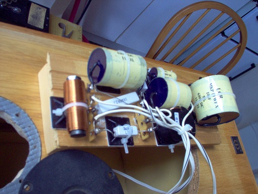

I can't remember why it is highly polarised, and don't care. It certainly measures much higher resistance if you get polarity wrong and degrades rapidly.
Thanks for that comprehensive description of the types of capacitors and their properties.
Although I suspect that the layman is content to imagine the capacitor as a 'magic black box'!
OK so you don't care, however for completeness I feel compelled to add . . .
Reversing the polarity of the dc voltage applied to a polar electrolytic reverses the electrochemical reaction which formed the capacitor in the first place.
The thin aluminium oxide dielectric layer is destroyed and hot gases are evolved. The resulting internal pressure can make the capacitor bulge and, in extreme cases, explode!
Large, high voltage electrolytics are fitted with a safety valve to allow the gases to vent safely in the event of reverse connection.
Moral - Avoid connecting polar electrolytics to a dc supply the wrong way round!

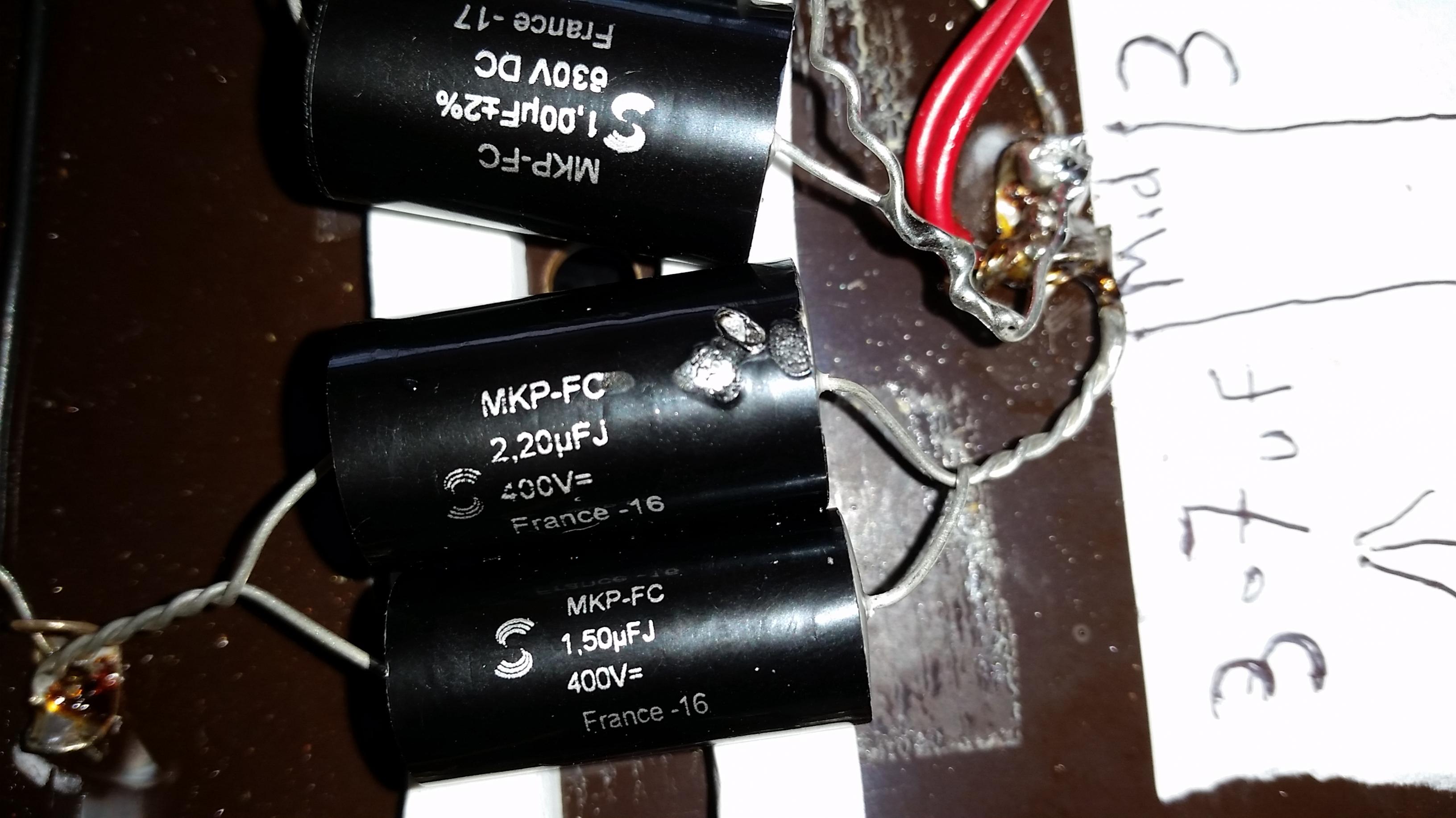

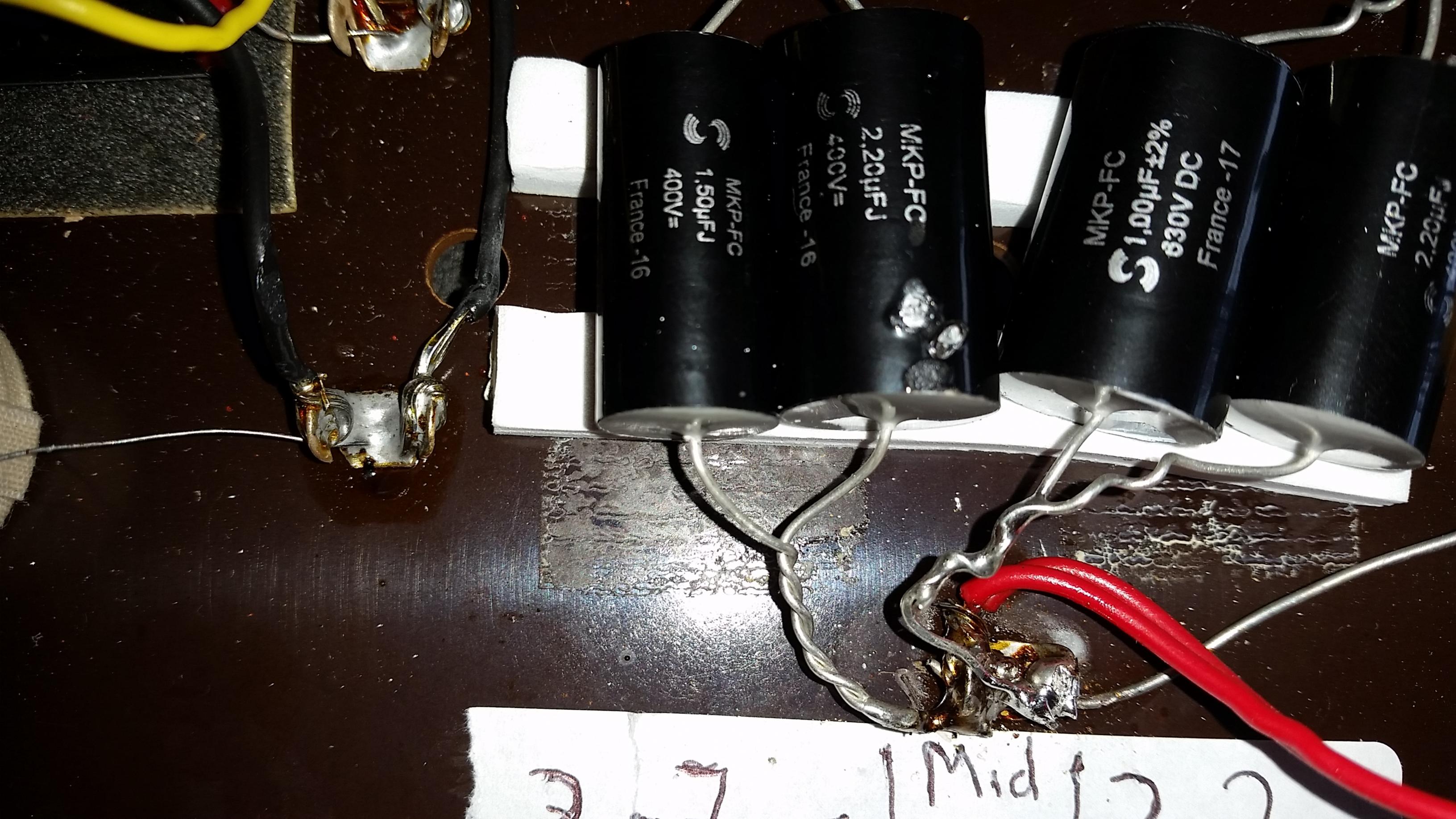

Do I have to bin this one and re order another?
No, that's just some surface damage which won't affect the operation of the capacitor.
Thanks Galu ... stupid me ... It seems to have broken the surface insulator and exposed / slightly damaged the silvery layer beneath ...No, that's just some surface damage which won't affect the operation of the capacitor.
That's not worth worrying about.
I'm more concerned about the integrity of the solder joint of which the red wires are a part.
It looks scrappy and I don't like seeing the bare copper wire.
I would re-heat the joint and flow on more solder. But be careful not to overheat!

I've done my best to stay away from disturbing as many joints as I can .... I've had a closer look at the joint in question . ( which I've not touched ) and it looks like its flux on solder and not copper that is making the orange colour ..That's not worth worrying about.

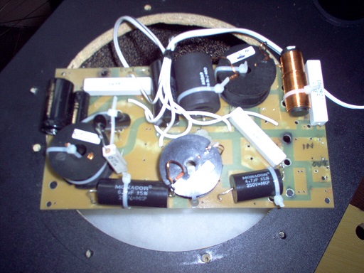

Hi there ... Well .. I said it would take me a week to listen to them .... well life got in the way ,and 6 weeks later I have just swapped back to my old un touched pair ...
I'm now gonna listen to them for a week or so ...
The new caps and fixing the internal bracing of the cab, have really sweetened up the sound. .Pretty much across the whole spectrum ..tightening up the base and clearing the treble ... And I would recommend it to any one with speakers this old.
After playing just 2 songs .. on the un mod 25's I can literaly see!!! and hear the response is lacking some definition in the bass that the recapped ones now have 🙂 ..
