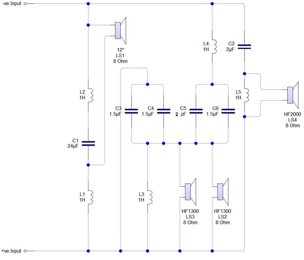

.. I'm looking for the schematic of the cross over ... I've found only one online and would like to get the values confirmed before proceeding with the replacement

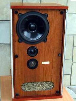

Anyhoo, here's my take on what a Celestion Ditton 25 looked like, from the vast "system7" archive.

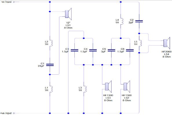

Hi Steve .. Thanks for the Schematic . This was the only one I have found so far . There was some mention of C5 being a 2 and not a 3 !! ??. And so was hoping to find another one to compare .
. Then dissect the 25's and hope that the values are clearly written on All of the caps.. a sort of belt and braces back up plan if the writing is not clear ..
But then there is the question of what type of caps ?? ..
Thanks for the help ... its needed :) Dom

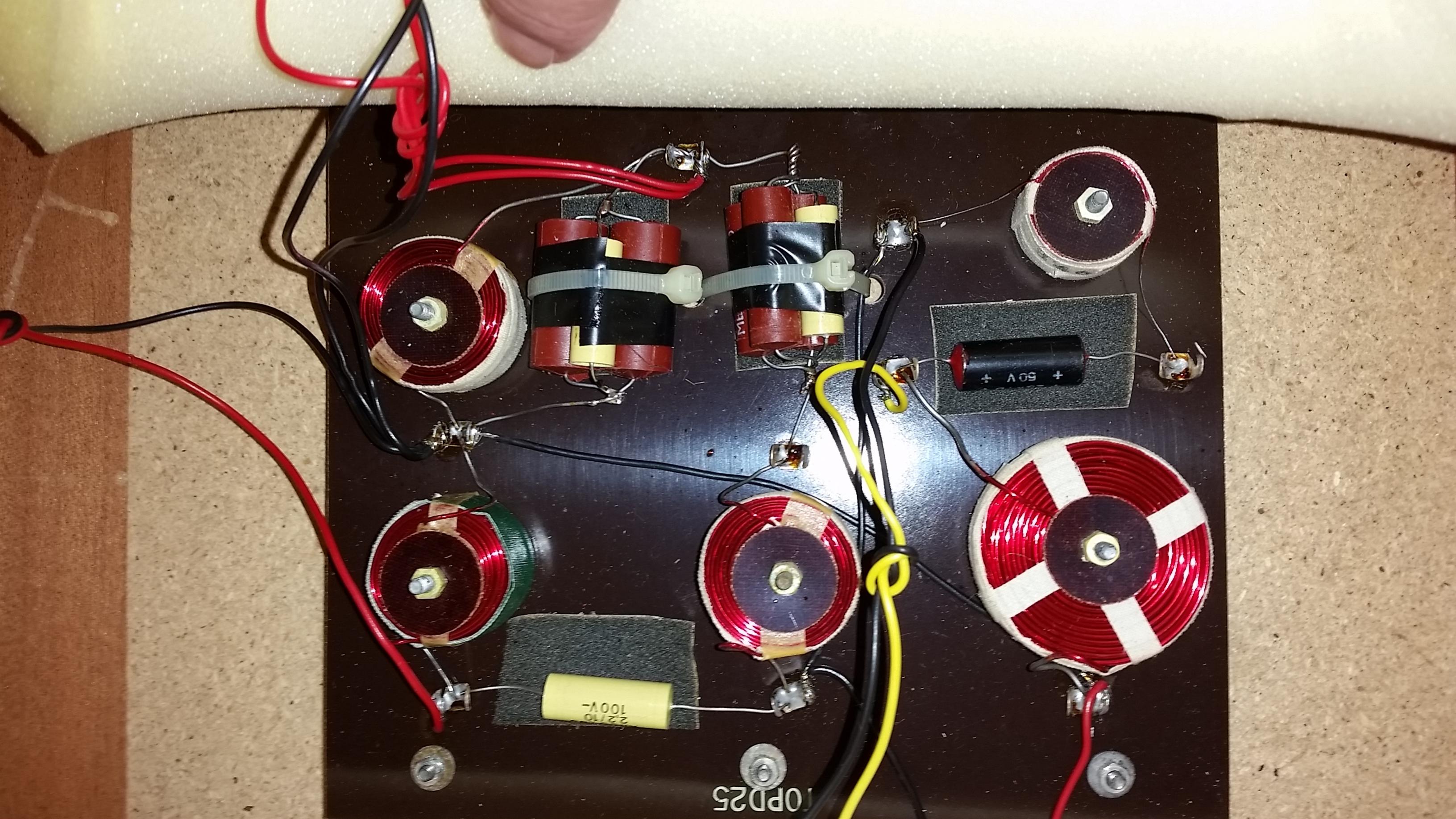

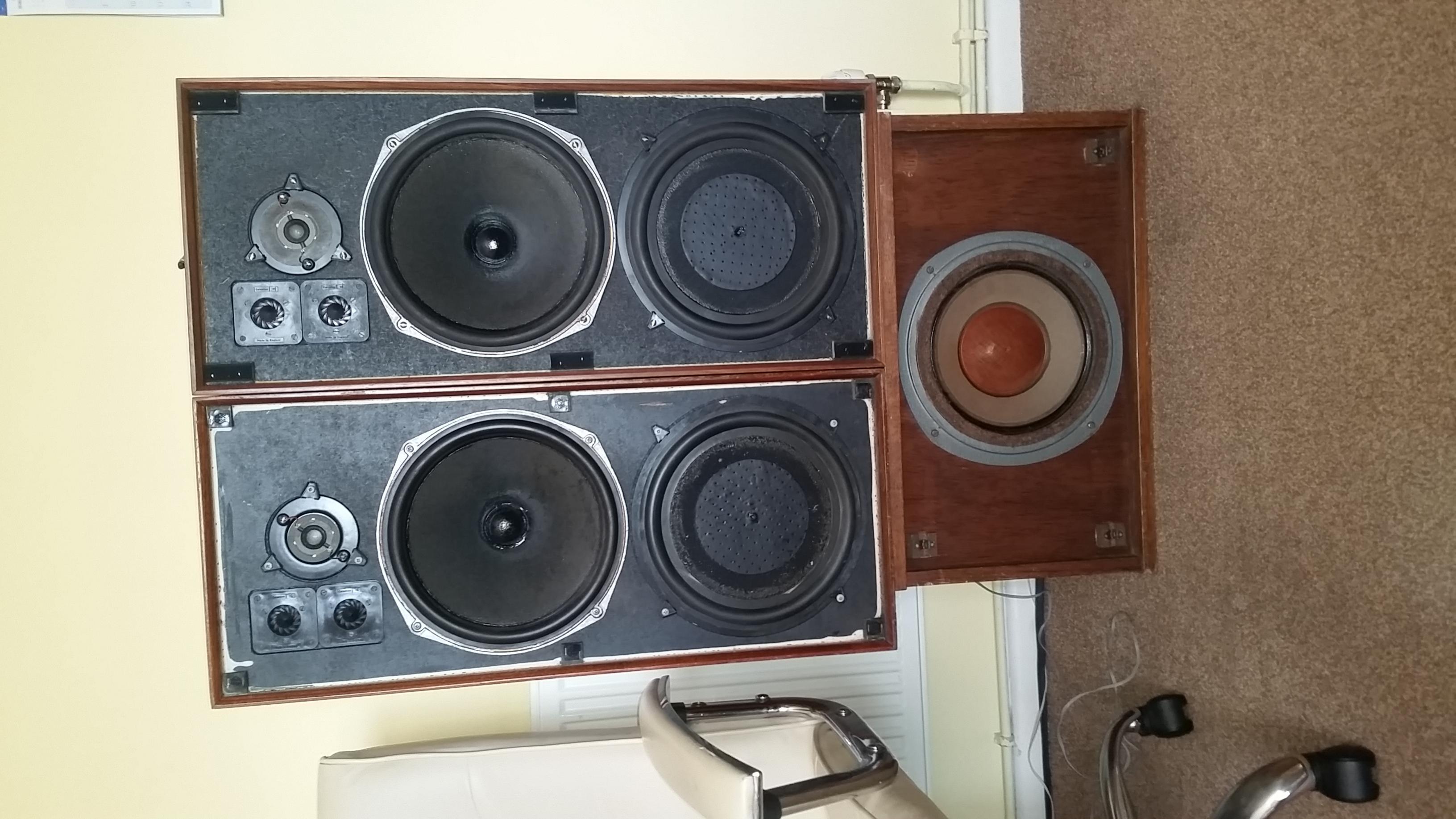

so far I've just had one of the woofers off ... And can see the caps are wrapped mostly

Here is a pic of one of the boards in situ ... Its looking good so far as reading the values might be poss

So I've managed to lift this from the web.
1x 1.5uF 50v Low Loss + 2.2uF 100v Mylar Film cap
1x 3.3uF 50v Low Loss
2x 12uF 100v
Can any one rewrite these out with there C numbers as per schematic. And why the mylar film mix ? and the 2x 12uF are not a specified type?
The capacitor values suggested must be the nearest currently available matches for the originals.
C1 = 2 x 12uF wired in parallel = 24uF
C2 = 2.2uF
C3, C4 & C6 = 1.5uF
C5 = 3.3uF (Not 2uF as shown on your diagram)
Now that I look closer!
Since C3 is in parallel with C4, the two capacitors can be replaced by a single 3.3uF one.
Since C5 is in parallel with C6, the two capacitors can be repaced by a single 4.7uF one.
For this age of speaker you should probably choose non-polar (NP) electrolytic capacitors.
P.S. C1 could be a single 25uF capacitor (24uF is no longer made).
In the picture of your crossover board, the yellow capacitors are film types and it looks like the brown capacitors are also film types.
If that is the case, then there is no urgent need to replace those capacitors.
The only capacitor that is in definite need of replacement is the black one at top right as this is an NP electrolytic and will have changed in value by now. This one must be C1 (24uF).
