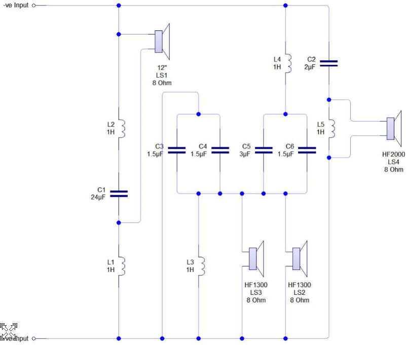

Maybe a bit late, but i found another map on my HD.
dave
Maybe a bit late, but i found another map.

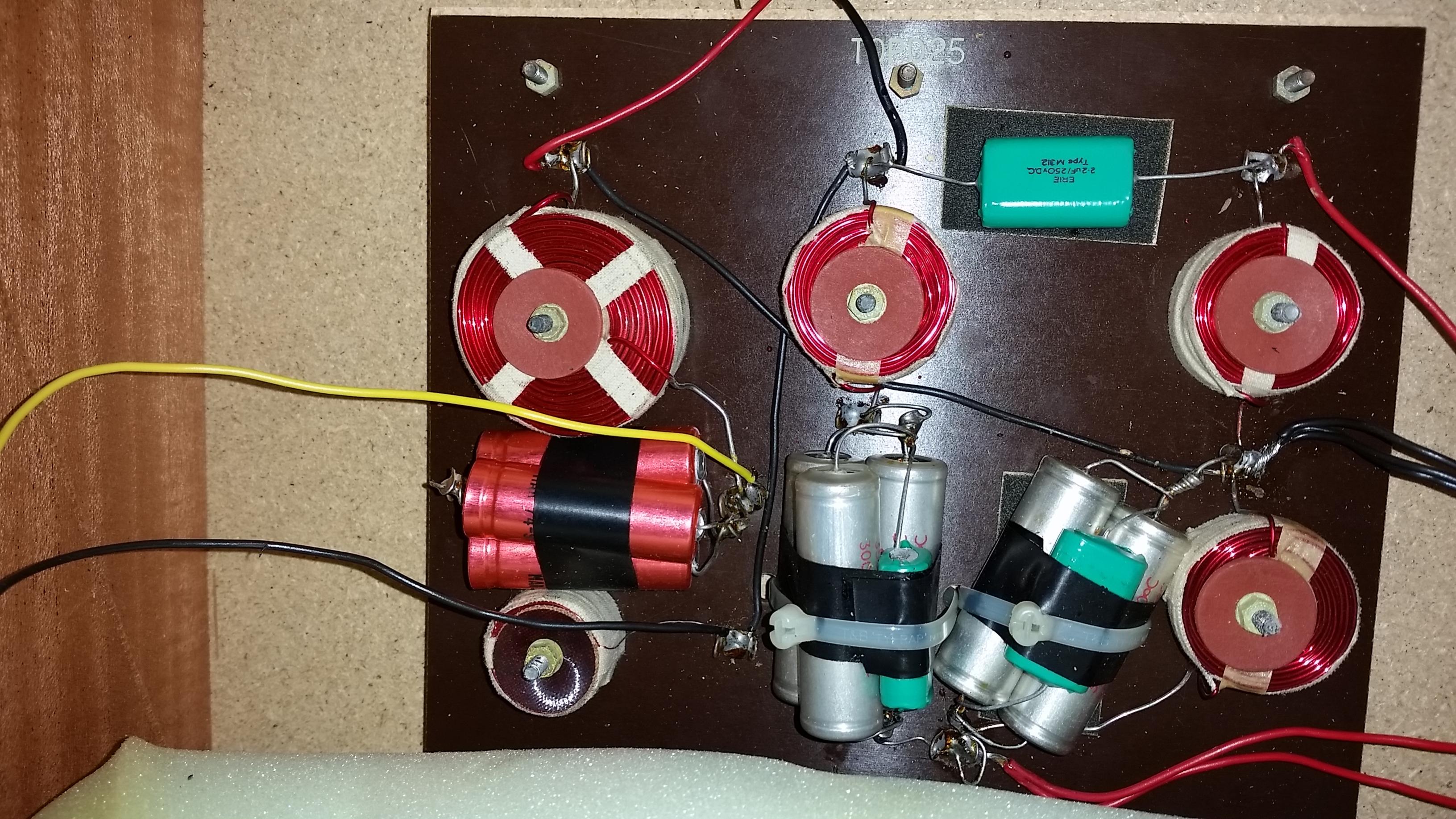

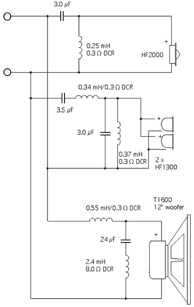

Your new crossover circuit certainly appears to correlate with the physical arrangement of the circuit board.
5 inductors and 4 capacitors - that's all there is in essence.
Looking at the two sets of paralleled capacitors, I suspect that this crossover board may have been modified in the past.
Will be interesting to find out what the values of the capacitors on the board actually are.

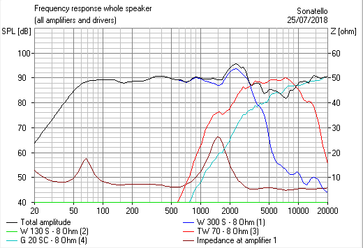

I just ran a rough sim of this speaker.
That 12" bass section is a bit strange. Wharfedale used to just run a 2mH coil on the bass in the Melton II. Which looks much better. As it is, the bass is running almost full range.
Phase was all over the place in my effort. This speaker would work a lot better with an 8" bass IMO. Then it all falls into place. I'd know what to do with that idea.

In the picture of your crossover board, the yellow capacitors are film types and it looks like the brown capacitors are also film types.
If that is the case, then there is no urgent need to replace those capacitors.
The only capacitor that is in definite need of replacement is the black one at top right as this is an NP electrolytic and will have changed in value by now. This one must be C1 (24uF).

I have just taken a pic of the board in one of the older pair ..

Yes, I agree there. Only one NP to replace! :)

BTW, that schematic I dug up is clearly wrong. We had a thread a while back on this speaker, and the guy adding the new capacitors got quite confused IIRC.

Would the speakers sound better if I replaced the film types with NP electrolytic ???
Looking at the pic of the board in the older speaker, I can see a mixture of electrolytic and film capacitors.
My advice would be to change all the capacitors to film types, with the exception of the 24/25uF, for which I would choose an NP electrolytic because of its high value.
Note that the blocks of paralleled capacitors can each be replaced by single capacitors of the required value.
There are two blocks of parallel capacitors.
I don't know the extent of your electrical knowledge so:
Just add the values of the capacitors in a block together to find the value of the single capacitor needed to replace the block.
You may have to use the nearest modern equivalent value for that single capacitor.

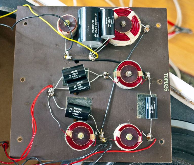

Apparently all the caps can be replaced with new MKPs.

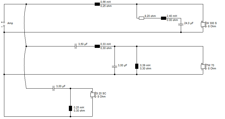

I found the old project thread:
Celestion Ditton 25 Crossovers
The crossover looks a bit unconventional here, but we seem to have got there. Everybody says it was worth doing. C5 is 2uF as Galu points out.

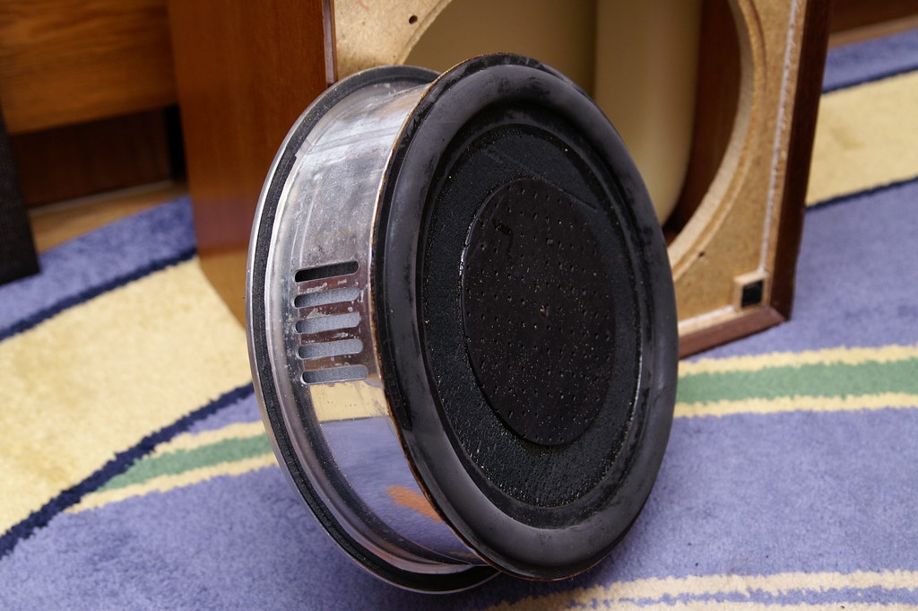

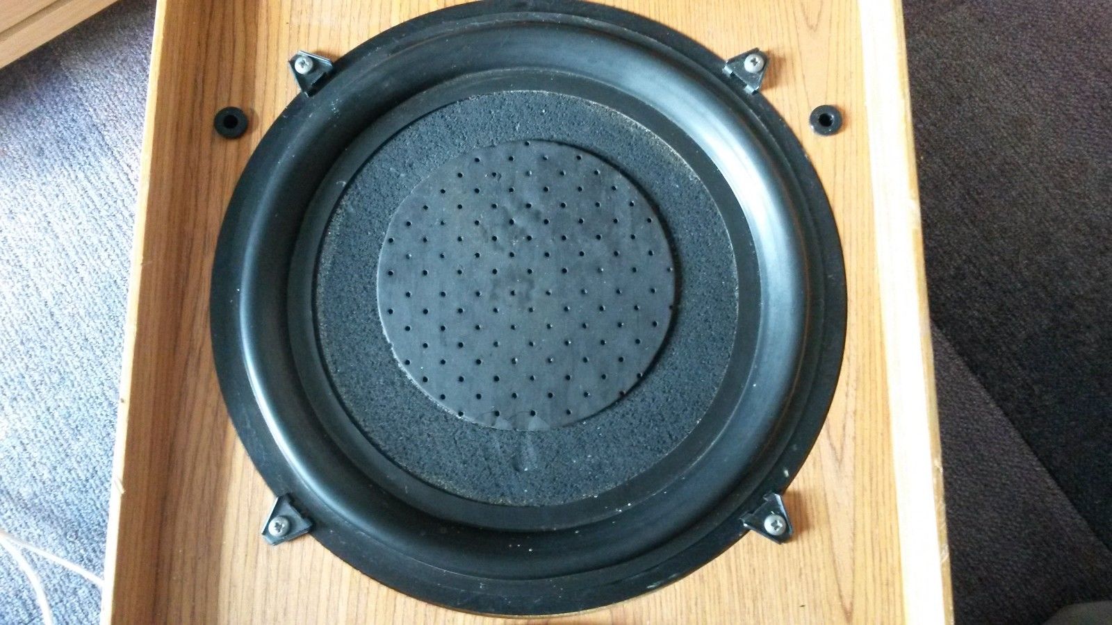

For me, the most interesting aspect of the Ditton 25 is its Auxiliary Bass Radiator (ABR).
Celestion described the ABR on the Ditton 15 as having a plastic foam diaphragm of high rigidity and low mass with a free air resonance of only 8Hz. The double roll suspension allowed excursions up to 0.75" with virtual absence of distortion.
The construction of the rear of the ABR mirrors its front.

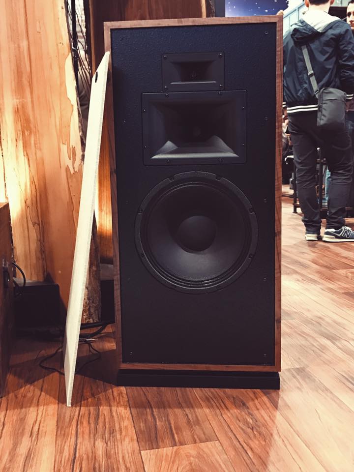

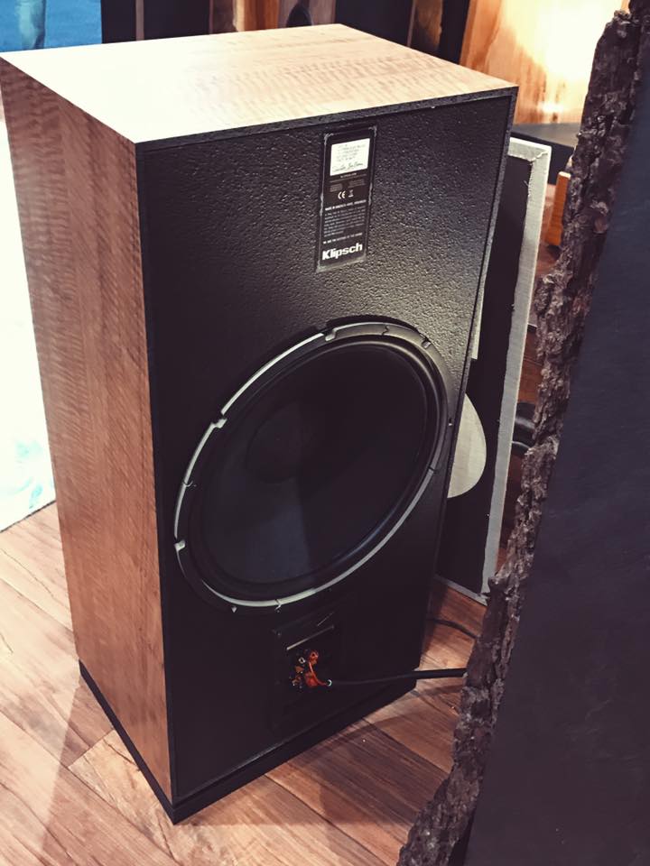

A modern take on the ABR is the Klipsch Forte III which has a 12" woofer at the front and a 15" ABR or 'radiator woofer' at the rear.
