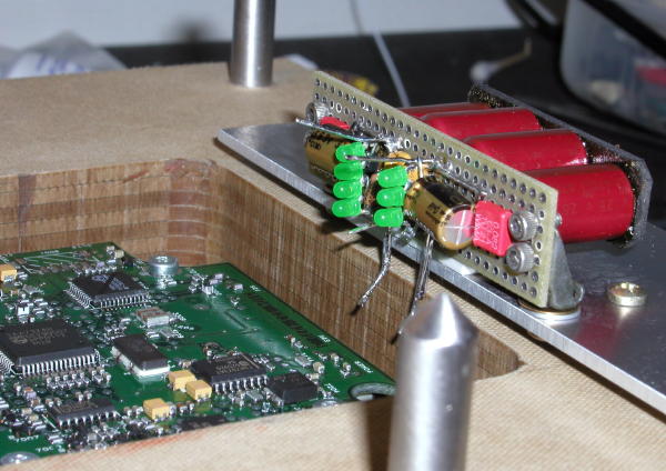

The active regulators will be based on LT1085 and located as closed as possible to the mechanism. I decided to use those chips to simplify the construction, unless somebody has better suggestion.😉 Passive filtering scheme is based on Kusunoki DAC http://www.homestead.com/whaan/files/tda1543_dac.jpg

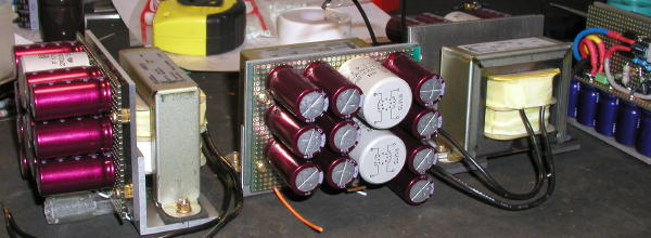

I used total of 33,000uF capacitance per section.

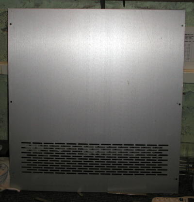

Player looks great! How did you make the ventilation grating for each of the sides? I like how you made good use of the HD angled extensions.

BrianGT said:How did you make the ventilation grating for each of the sides?
I just bought a panel like this from a local surpluss outlet and cut it to the size.😉 When making a unit like that, there is so many decisions to make that the final product is quite different from what you might think about in the beginning. And I'm just a one person committee.😉
I was thinking about experimenting with different PS configurations and setups, but when I figured out how much space I had and what parts ( because of that) I would be able to use, there was not much choice in the end. 😉 I've got way better caps but I'm not able to use them because of space restrictions. I still need a space in a second tower for DAC's PS. And getting rid of SPDIF is probably a better choice than going all way out with exotic caps. One thing I know for sure: I need a separate, split bobbin transformer for every stage.🙂
You had me confused with those ventilation slits. It makes more sense now. I thought you went out and bought more tools. 🙂

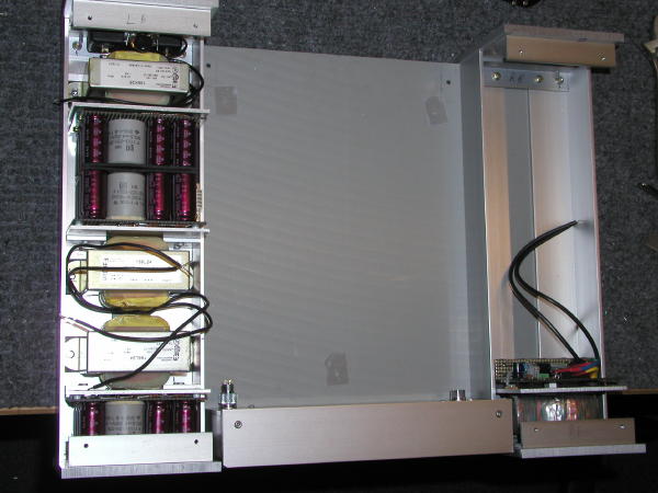

It looks very professional looking. How did you decide exactly on the dimensions of the two side pods? Did you base them on the width of the transformers?

It would have been nice if the front panel was half as high, and the spikes could be seen from the front. Nevertheless, I really like the quality and the industrial look of your chassis. Congratulations on the good work. Now your task is to make it sound as good as it looks, which seems like a much more difficult task.

Currently I prefer to do as little work as possible, so the side pods size was determined both by the transformers size and by what was available. Since the extrusions come in half inch size variaton I settled on 4". It also allowed a nice gap at the top for vents. Initially I thought about connecting HD angles together, but leaving the spaces between them made the whole thing look better.

using composite construction (aluminum/phenolic) is a definite plus. i was wondering if you would damp some of the thinner panels though, such as the extrusions of the power supply towers. they appear like they might still be slighty ringy, and might induce some colorations thru modulation of the power supply electronics.

As to damping PS housing, one way I wanted to avoid the vibrations was to use angles which not form large panels. Also when space permits I'll use damping sheets inside.
