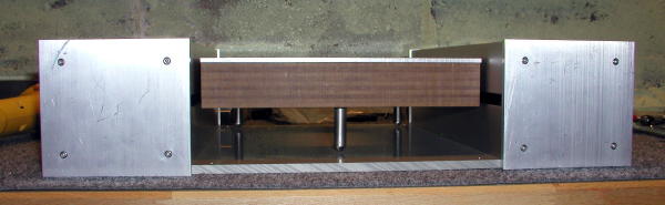

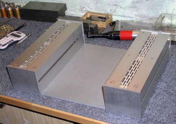

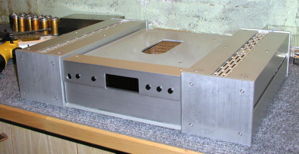

The base that houses the transport mechanism goes in between towers and guess what?.. it rests on three spikes. It is not attached to bottom platform in any way in order to avoid vibrations transfer. I did the spikes from 3/8 stainless steel bolts from Home Depot and grinded them to a sharp point. If I decide to built integrated DAC it will go under. Control module (display) goes in front between towers.

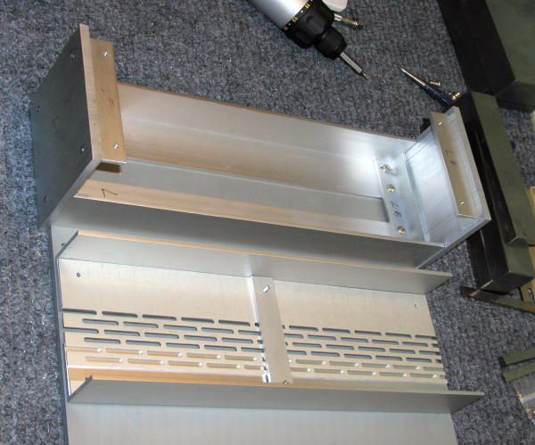

The housing of the power supplies is done almost completely from easily available and anodized extrusions from Home Depot. I just cut them, and connected with screws. The spaces help with ventilation as well give more industrial look. Took me a while of some creative thinking to make the best out of them and not look average. I guess I achieved my goal.😉

Your Home Depot must carry better items than my Home Depot down here. I can't find anodized extrusions here!

Probably 15-20 hours of actual work, not counting hours spend on thinking about design and looking for tools.😉

This is a prototype. If it will sound good, I might prepare a kit with somewhat easier way of doing things. I still have to test different power supplies and at least two type of DACs: one with no oversampling the other using latest technology. So bear with me, the quest will continue.😉
Be prepared to spend at least a $1000 though (but in Canadian currency😉 ).

have you thought about damping materials yet? maybe treat the inside with some sort of coating or constrained-layer damping? aluminum does tend to be a little ringy...

Damping materials
The mechanism is mounted on 1.5" phenolic material which should provide good damping. It is mounted on 3 spikes which rest on 1/4 aluminum plate. The aluminum plate itself will rest on another 1.5' phenolic board and this is the only place where I will experiment with damping. I didn't do any damping around mechanism following the way of reasoning of Junji Kimura of 47 Laboratory:
"The platform/casing of Flatfish is a 2/3 inch thick, machined aluminum board. All the driving mechanisms, pick-up mechanisms and the circuits are directly mounted on this one piece of aluminum board.
The huge difference between the mass of the mechanisms and that of the platform (150g against 1200g) enables to cut off the vibrations caused by the slight off-centering of the disks and the tracing mechanisms returning to the bit-tracing lens itself, allowing us to minimize the amount of servo control dramatically.
This rigid and compact structure of the platform has a very small surface area to receive the vibrations, and its large mass helps to reduce the vibrations smoothly and effectively without any extra damping or suspensions.
As a result, storage of vibration energy was minimized, letting us achieve a refreshingly quick transient response. Compared to the conventional box-type chassis/casings, this platform is almost completely free from any stress of construction. Now, you can hear how much harmony and bottom-end information was obscured under those mechanical stresses."

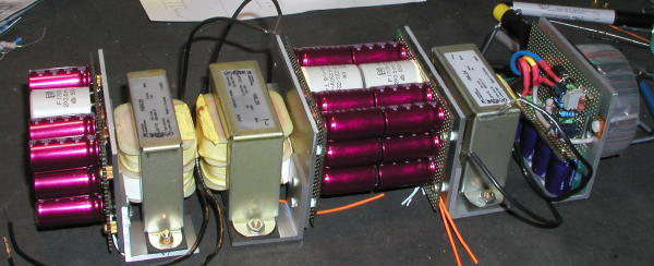

Power supplies for transport section are almost done. Each supply consists of a separate, split bobbin transformer and heavy passive filtering (LCLRCRC)😉 . Four supplies in total: bias and filament heating for VFTD, servo decoder, motors and actuators, display PCB. They will be located in a left tower. Right tower stays empty until DAC is build.😉
