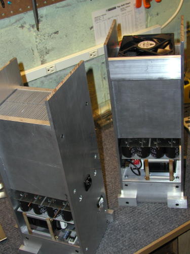

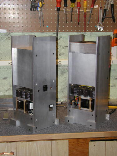

Since you asked I couldn't resist. While it's a bit off the subject it's still a feast. I was thinking about calling those amps Twin Towers but I don't know if it's appropriate in the light of recent events.
Initially those were the cases for SOZ but I might be tempted to put GAX in there. Will use the fans to increase the heat dissipation. The circuits would be mounted on both sides of heat sinks. Side and top covers would be added as well. The transformer is in a separate housing at the very bottom.

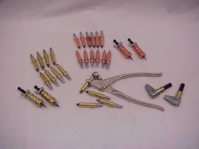

Before going to the electronics, let me ask you a couple more questions about making chassis. How or what tools do you use to align the 2 metals sheets together so that when it's time to put the screws in, the metal sheets would line up perfectly? Do you:
(1) clamp the 2 metal sheets together and then drill the holes thru the 2 metal sheets?
(2) mark the metal sheets with some kind of offset distance from the edge for every holes on the 2 sheets and then drill?
(3) drill bigger holes on one sheet so that there is some leverage for a little adjustment if they don't line up?
(4) or what? I'm sure you know what I mean. I would appreciate pictures if you have it.
I presume you have some kind of special tools or some tricks that you use since the metal sheets in all your pictures line up perfectly. Please advice! Thanks.
Note:
You could respond to this in your other thread .... something like "useful tools & technique" or something like that.
Fcel,
I'll bet he's using something like this... 😉
There called Clecos and are very, very handy...
When you squeeze the pliers the point comes out of the Cleco and gets skinnier (you use the correct size for the hole that you've drilled). You stick the point through both pieces of metal and when you release the pliers the spring loaded point sucks the two pieces of metal together with a fair amount of force...
They're great because they align the holes perfectly while locking the different layers together for further work...
Have fun,
Steve

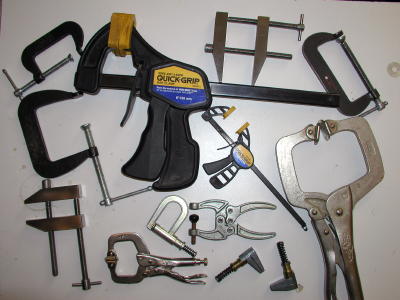

I cut thick aluminum with a mitre saw, see [url http://www.diyaudio.com/forums/showthread.php?s=&threadid=3981&perpage=15&pagenumber=2[/url]
I don't use a brake, whenever needed I use angles (usually from Home Depot). As to aligning, I always drill holes in one piece and then clamp it to the other piece and drill through. Usually drill the thicker part first. Although I use clecos at work, somehow I never felt the need to use them when doing my chassis. Probably because I use screws for fasteners and not rivets. However, you can try to use clecos and the best place to look for them is http://www.yardstore.com/.
So for me, clamps work the best and although I have quite a few of them my favourite are probably Quick-Grip brand from Home Depot.😉

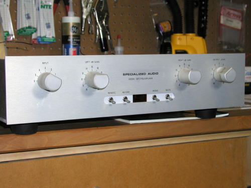

I do faceplates as well and this is probably one of the better examples.
