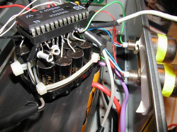

My player
Hi Peter!
I2S from CD PRO to 1541 dac chip.Did remove the original dac chip from CD PRO board, didnt like the idea of that not used one.
Also 1541 chip is powered with three SLA battery-
no filters and regulators. I am very happy with result, there is nothing compare to my Sony cdp xa
50 es with Audiocom´s 45 MHz clock upgrade...
Tõnu

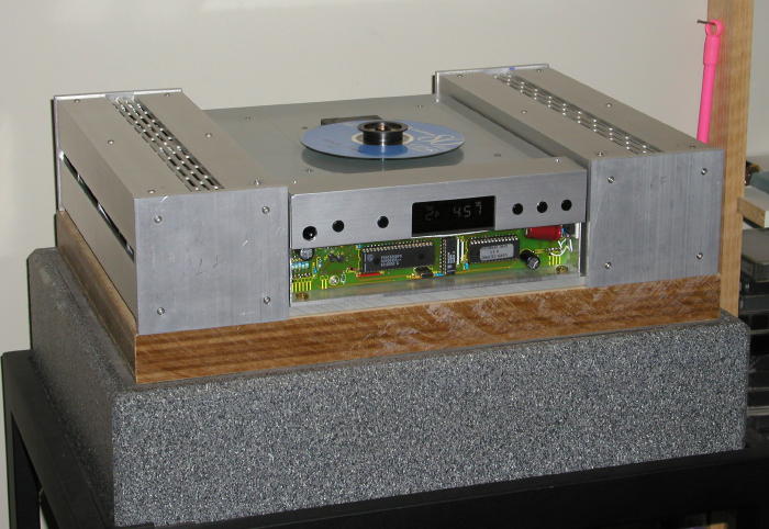

Anybody who doubts the importance of shelf materials: I just removed phenolic board from under the transport (seen in the last picture) and placed the player directly on a sand box.
The sound improved, with more space and detail and averall less fatigue. Still, need more focus.
I noticed that display says "no disc" each time I put a disc with those plastic dampers attached. I never had problem with those discs before, but here they seem not playable. Any idea why? Wrong weight, or what?
Joined 2002
well i must say that is a nice cd player i pitty yu if ya have a cat that loves warm places to sit or lay since your optical block is not protected nor the top of the cd player.. are yuo going to be putting a lid on it or just as is .. and id try a weighted cd top holder to hold them cds down more firmly i bet that will solve some thing.. and make it spin more acuratly..
Well, it so happens that I have 6 cats at the moment (my female cat had the young ones recently) but I keep them all outside.
Just for fun today I placed a bowl to cover a spinning disc - it sounded worse. I also placed blue LED close to a laser and it indeed improved the sound (more relaxed and natural). The article in Stereophile wasn't a lie. I'm thinking now about proper location for permanent LED.
So no cover, although I will have dust cover when not using player.

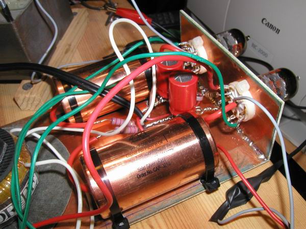

dice45 said:Tonu,
i just notice the components you used. Serious stuff! The trannies look like Haufe to me, are they for output or for I/V conversion?
If you mean big ones on left and right sides of the tubestage on full player photo, then they are opt-s I had in hand and used as anode chokes.
The result with them was a little too cold (30H for 5842). Today are there Lundahl´s 100H anode chokes and I like the result much more.
For I/V I use 20 ohm Audionote tantalium resistors.
Tõnu

Peter,
congrats!
soft suspension! no spikes!
If the sandbox improves the sound, then a soft supension should do an even better job.
One exception, if the vibration come from inside the drive, a sandbox dissipates them. But then i would put the sandbox under the drive unit itself on a soft suspension in order to cancel ground vibrations.
