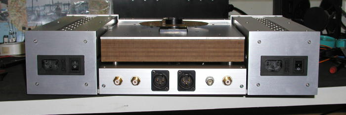

By removing phenolic base board between player and sand box, I observed similar results as with my previous player. That board didn't work well in that location. I will check how the transport sounds in it's original form, on suspension. Any idea what to use to make suspension even softer (with res. at 2 Hz)?
I just placed 1/4" thick damping material between metal base of a player and sandbox. The sound is more open, maybe slightly less bass, but more pleasing tonal character. I almost got it where I wanted.

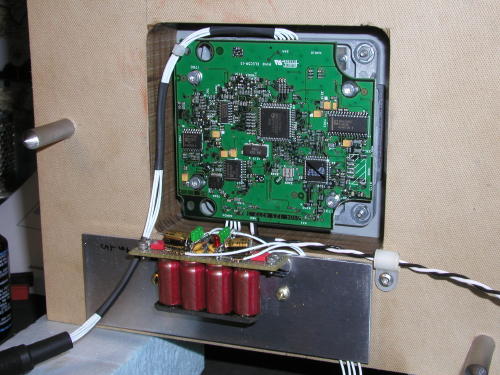

One more construction picture showing the regulators and connections. I used small video sockets for 6 wire control link for easy disconnecting. Four wire plug was used for power supply. The heat sink for two regulators is just right in size.
Tonu,
Does removal of a DAC brings any sonic improvement? Are you also using red stby button for new disc?

suspension: maybe you replace the phenolic compound the drive is mounted in with a brass/lead compound. Then you have high mass.
Then suspend this heavy platform by hanging it into a rope or a silicone tubing ring just the way a noisy harddisk drives or a µphone :µphone: is suspended in frames. No metal springs!
The reason I used phenolic material was ifor ts better damping characteristics than MDF and most of all, the easiness to machine (so I could do it myself).

While the mechanism is breaking in, the sound improves too, and less and less discs cause trouble.😉 I think that both methods (suspention and no suspension) can be utilised succesfully. The rest depends on the choice of materials used to support the whole transport assembly. I can virtually tune the sound to whatever effect I want to achieve. My first impression was biased by the setup used for my previous transport, which in many ways is different to CD-Pro. But already, I have to admit that CD-Pro is superior.
I wonder how many of you CD-PRO users were concern with a proper clamp alignment. At least in my player the clamp was never centered, because the opening was bigger than the top of a TT shaft.
I placed 4 pieces of teflon tape inside the clamp, and now it fits perfectly and is centered every time.😉
I also dealt with the problem of changing discs and getting new TOC each time. I connected a switch to a lid output and instead of using STBY button and clicking twice as well as disconnecting power each time, I click only once and have a new TOC for ea. disc in a more proper way.😉
