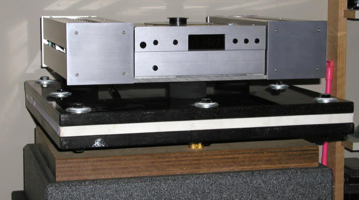

The front is brushed, but since I wasn't doing it in a while it didn't come out too well. The paper wasn't abrassive enough and lower grid would be better (less than 80). It should have been done deeper. I was using 3" belt sander and oil. It was also anodised, but for some reason they did very thin layer (probably not hard anodizing).
But for best results, to much the other panels I probably have to sand blast it.
I was having a listening session today at some analog enthusiast house. His analog rig is probably worth $10,000 and he was interested in my CD. After an hour of tweaking we finally achieved proper sound (we finally settled on 2.5" acrylic board, 3 dampers on top and then 2 plates of granite with blown rubber sandwitched in between, then additional 3 dampers). The sound in his opinion was not exactly as his TT, but in a same league.😉
I think that's not too bad. I was using my outboard oversampling DAC.
The CD transport as it is now is too complicated for a kit. I will be making new version with separate PS and 1 pc acrylic platform. No soft suspension. I just realised today that there is a big potential in this mechanism. But half of the success is proper placement.

promitheus said:
I am happy you got the cd to work better.
It happens sometimes, you try to improve something and something else goes wrong.
What kind of base do you got there for the cd player?
The layer in the middle looks like aluminium. What are the two black layers?
The 2 black plates are granite, the white stuff between is material called "blown rubber". It has characteristics of rubber, but half the weight. I found that base made of that sandwich has very little signature of its own and sounds the best so far. Got it from an audiophile friend.
