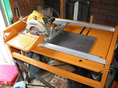

I have a few questions regarding your work in aluminum.
Do you have a preference in cutting aluminum. I have a table saw
a sliding compound chop saw and a bandsaw. So out of those
these three tools which to you reference.
I've tried cutting Aluminum on a table saw with a Hollow Ground
blade, no carbide tips. The table saw cut slow, needed a lot of lube, however the blade was not the best. On the other hand the bandsaw cut the aluminum like butter, however I was looking for a cleaner cut. So what are you recommendation's as which tool and blade works the best, leaving the cleanest cut. Or do
you allway sand or file your cuts.
James

I always sand the cutmaterial on 2" belt sander with a table.
My preference for cutting thicker stock is sliding compound saw ( I'm using 10" Makita with Freud "Non Ferrous Metal Blade"). In that way I cut 2x6 heaetsinks and square tubing. I'm using band saw to cut only sheet metal or for small cuts when I'm too lazy to go to the other saw. I never tried table saw for cutting aluminum. I also never had to use any lubricant.
For anything that doesn't fit my mitre saw I'm using that setup. I bought that table long time ago at Canadian Tire and although desined for wood cutting it works great with metals. I'm using 7.5" circular saw which can slide above the table. I clamp aluminum pieces to the table. I was cutting 1" thick aluminum pieces as well as 2" thick heat sinks without a problem. When a piece is thicker I do two or three runs to complete the cut.

Peter Daniel said:... I bought that table long time ago at Canadian Tire and although desined for wood cutting it works great with metals...
That's a Triton Mk3 Workcentre - made in Australia - see Triton web site !!! Now superseded by the Workcentre 2000. I have one too.
