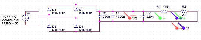

I have just started my PCB and whilst drawing it up, noticed something. I am not convinced it'd work "as advertised!". The PSU is the one here... A simple but yet effective supply suggestion. My value for Rx was calculated at 187.6Ohms and I am using 188Ohms. My problem in understanding this is that if the total peak to peak of the transformer is 24V (2x9V secondaries) and you tie the positive side to ground, how can a resistor in series mean the output is -22.5V?! Furthermore, what is this voltage with reference to - it certainly can't be GND! Please explain to me how this works - even my spice simulator is getting confused!

The PSU as drawn on the Daisy webside works, the value that you calculated is oke. I have the same situation here, however I have noticed that the series resistor is getting really hot. I am using approx. 20 pcs. 0,25W resistors in a parallel/series combination that makes together approx. 180Ohm and it still heats the complete (12 kg) housing.

Hi Peter,
I'm using two 10W resistors in series (120R and 68R). So what are the -22.5V and -24V in reference to? Ground? If it is ground then I do not understand the schematic at all!

Rarkov said:So what are the -22.5V and -24V in reference to? Ground? If it is ground then I do not understand the schematic at all!
If you are talking about display PS, don't worry, I had some problems with understanding it the beginning too. I don't remember it now, but if you use webside of A. Galavotti and copy the supply exactly, it will work.
Rarkov said:Please explain to me how this works - even my spice simulator is getting confused!
I am sure you understand how it works otherwise you wouldn't know that you need approx. 180 Ohm.
The voltagedrop over Rx is 0.125 * 180 = 22.5V. When the positive side of the bridge is connected to GND (which it is in my CDPRO) the voltage that you measure on Vff is compaired to GND -22.5V, Vfk is Utotal-22.5V = approx 2,5 V.

The power flow is explained here:
http://www.daisy-laser.nl/homeoptics/page13.html
You have the positive voltages +5 and +9 V referenced to GND, and you need something like -20 (+-2) V referenced to GND. There is only a little current from GND to this -20V.
Than you need about 2,5 V more negative than the -20, there should flow about 125mA for the heating of the display tube from -20 to this -22,5V. If this current is to much the display will give up displaing anything early. If its less it will be darker but live will be longer.
So it is important Vff is around -20V to ground, and Vkk so much lower that there is this ~125mA flow.
I use a series resistor of around 180R 3W and glued a little heatsink on it because it is really hot, but works without problem.

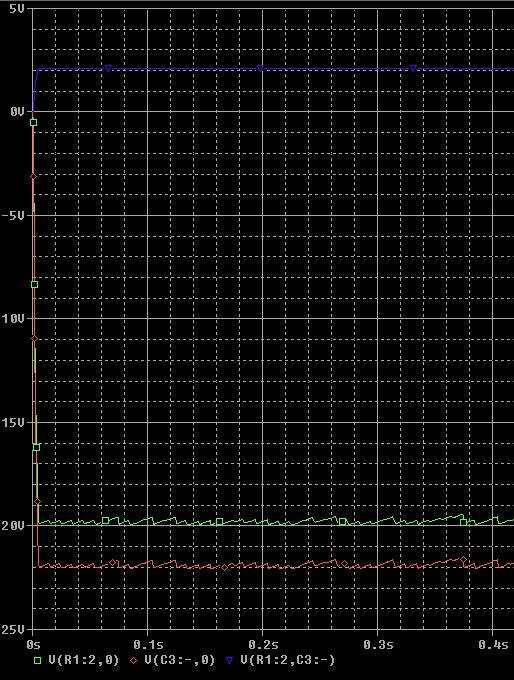

Ah-ha! Got it!
I forgot to add the 20 Ohms for the display - so the values were either at ground or at -24V. Here is the schematic as I have simulated it...I used differential probes to make sure I got it right - just in case. It is suggesting that -Vff is at 20V and -Vkk is at 22V. The voltage difference is a very constant 2V dispite a noisy line...Here are the pics...
