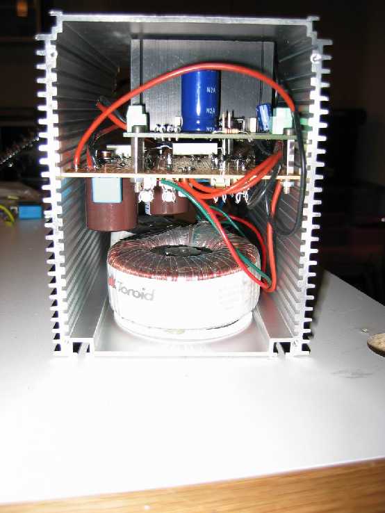

Thank you Rarkov!
It’s all built up of three relatively cheap data card (?) boxes where vero-boards fit exactly. I would however not recommend the use of such extruded boxes where only the end lids can be removed as the running of wires etc becomes rather cumbersome. The boxes are all mounted on a damping platform which shall cancel vibrations (by a so-called counter weight middle plan). Oh yes – I do enjoy the sound now from the machine 🙂 I’m way below the level of know-how the guys show on these pages, but it seems that a jitter-reducing oldie (Theta Time Linque Conditioner?) on the path from transport to my external Electrocompaniet DAC has removed some symptoms and I now have a broad smile on my face.

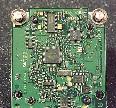

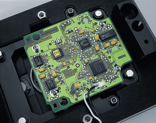

BrianGT said:Here is a picture of part of the circuit board:
Brian
could we have a closer picture? to be able to read what's on the chips 😉
Thanks for these pictures.

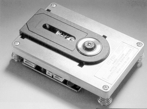

I would be interested to see how mechanics look.Especialy motors,laser ...and all mechanic parts that are probably visible when the board is taken off.
Bartek
Bartek
The main chips are listed on the Daisy page:
http://www.daisy-laser.nl/homeoptics/page9.html
They have the user manual, and the datasheets for the ICs on the circuit board.
Brian

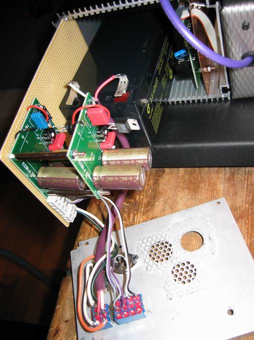

It seems that it is possible to use a (Sowter) transformer to "konvert" a 0,5 V unbalanced S/PDIF signal and make it readable for a balanced 5 V AES input on a DAC (though still having a potential of 0,5V). There was a slight sonic degrading compared to S/PDIF the-whole-way approach, so in one way - an useless exercise.
Have built a rechargeable battery powered supply for the CD-PRO2's 5V signal circuits plus battery powered supply for a Theta jitter reduction box. The sound got definitely more resolved compared to mains supply of both but Ive also got a slight stingy treble that I'm not absolutely confident with. Ill make the whole switchable between the two power supply modes to make A-B comparison easy. I attach a photo of the very simple (and cheap) battery supply.
geirTj
geirTj
