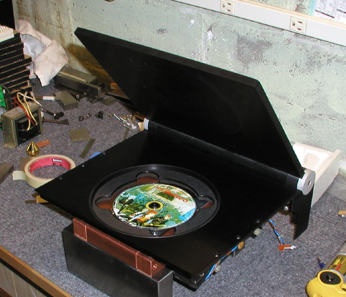

I decided to make another CD-Pro based transport and this is what I'm starting with. The original lid from ML31.5
http://www.marklevinson.com/image_library/index.asp?categoryID=1&productID=15
I bought it for $100 😉

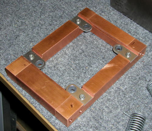

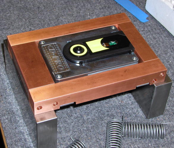

The transport is mounted in a copper frame, made out of 1" bar. I put it together using #10 screws. Original design from Madrigal is using lead, but I prefer to work with copper. It's quite heavy and sturdy, no need to milling it out of one piece (it would be too expensive). Frame will be additionaly mounted on 4 springs.
Peter did you use a Dado blade to cut the notch out. Are you still using that Freud Non-Ferrous Metal Blade hows it holding up.
I just hate getting metal shaving in my cabinet saw and the dust collector does not do a good job on metal. It was bad enough cleaning aluminum for my bandsaw and all the DW40. Also, due you use a lube when cutting table saw.
I didn't use Dado blade as the one I have is not specified for metal. I used my Freud blade and just made numerous cuts (in two depths: 0.1 first, 0.2 final depth). I thought saw cuts would be enough, bet eventually decided to shave it to nice surface with 1/2 straight router bit. It worked fine and the finish is like from professinal milling machine.
I was initially also reluctant to use my table saw for cutting metal, but I'm using wooden guides and I place a piece of MDF on a table's surface, so no damage yet.
I'm not using any lubricant for cutting.

Peter,
I was told by local shop that the router would work but I"ve been to chicken. If I use my router table there are chances the metal shaving will fall into the router's motor. Did you use a carbide sprial fluted bit.
Yea, a piece of MDF over the top of the table saw sound like a good idea. I'll try that.
I'm using mostly this bit with metals and plastics (1/2 or 1"). To avoid metal shavings fall into router (I think that air movement prevents this already) I use 1/4" hard board over the table, with the hole made by router bit. This also prevents the metal ring (reducing the hole in the router table) from falling out. It happened to me once and it was a mess. It's good to use tape to attach it more securely. I always shave only a tiny bit of metal with a router as anything more may be too dangerous. All the rough work is done with a saw.

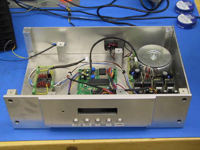

Here is the latest picture of my project. It was done for my school project, and I got checked off for it today. I will continue to work on it on my own.

Here is one more picture, showing the arrangement of the insides without the transport. I have more pictures of the earlier development of the project here:
http://www.diyaudio.com/forums/showthread.php?s=&threadid=21475&highlight=
Once I get the new control pcb made, it is designed to fit on the back of the Optrex 20x2 lcd that is used in the DipChip kits. This should simplify the internal wiring a bit.
The power supply uses LT1085 regulators, with a CLC setup on the cdpro2 lines, along with plenty of capacitance.
