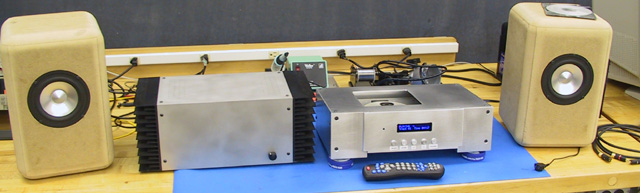

As for the sound... I haven't had time to give it a detailed listening yet. I had it hooked up to a 2x120W leach amp and my jordan jx92s speakers today for our demo, and it sounded alright. The output of my dac is lacking in voltage, due to the lack of a proper I/V stage. This dac needs lots of work sonically, in terms of the dac.
Picture of testing setup:
Brian

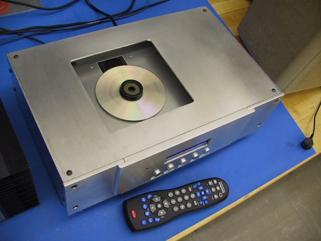

Da5id4Vz said:Well thats just beutiful.
Are you thinking of engraving or silk screening for the labels?
The labels are temporary.. I added them last night for the demo. I talked to the machine shop, and am thinking about getting the middle anodized black, and the rest clear. Then I can look into some sort of silkscreen over the black anodized part.
This project was my school project for this semester, which I organized a couple of friends to do with me. We had 5 members, including myself. One guy worked with me doing the microcontroller code, and another guy helped me with the chassis. The other 2 members did nothing, but work on the presentation and webpage, making up a bunch of marketing and other bullsh*t.

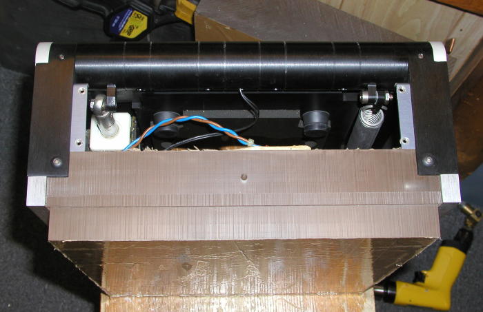

I e-mailed a friend who is willing to make a case from copper But I`m still thinking of a way to get the -2mm max- plate to really form strenght. I thought of one plate for the bottom front and rear, flanged on every possible edge Or I could go with the "4 square blocks" to attach all the plates to seperatly. The "problem" with either is, that the bottom would not really suit the weight of my massive transformers and pcb`s I think.
The way u mounted your cd pro2, Daniel with the hole on the top, and the wood beneith is also very good, but how do you cope with taking the lid of -really long wires?- or is yours standing on spikes or something?

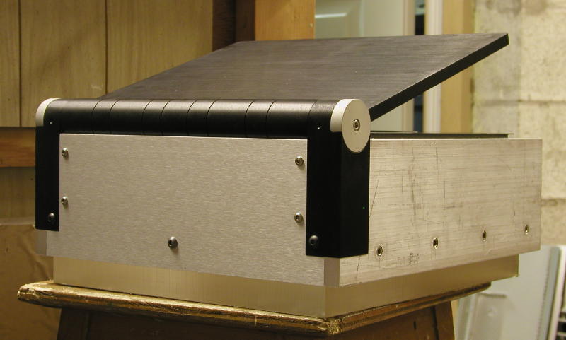

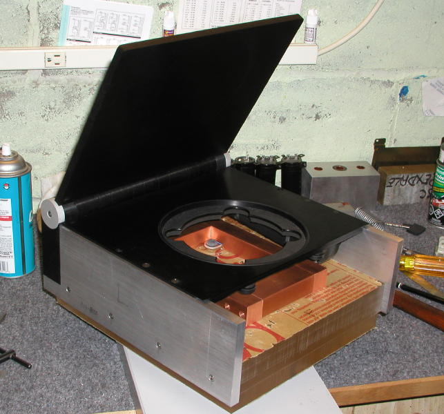

It's coming pretty good. Finally I decided on enclosure type. The bottom is mqde of 2.5" acrylic, sides are 1/2 aluminum. 1" from the bottom, acrylic is milled 0.1" deep and that's the reference for all side panels. I'm not be using any feet with that probably.
I'm tempted to leave transport as a stand alone unit and make PS in separate enclosure. Additional wood panels would be added to the sides.
The wiring is always short, I used spikes with a previous one.
And here's the complete rear view. I decided to go with a clear anodizing for the panels. It makes a nice match to the black lid. As I mentioned before, there will be additional wooden panels on the sides, or if I decide to go with one box, PS towers will be attached there.
