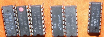

One of the commonest causes of distortion in earlier Pioneer players was the failure of the buffer ram memory, which used to be a separate item. Track search, skip eye pattern etc all looked normal. Audio sounded like a badly worn 78, very distorted and with a constant crackling/scratching. Replacement cured.

Might back up the DRAM chip problem then.
Damn, Dram!
I recon so. Saw a few Pioneers that suffered in that way. Didn't get to read all the posts so missed your suggestion regarding dram. That's where my money is!

I have quite a few 4264-10 and 4264-12 (or maybe 4164-15) laying around (since the old commodore 64 days) these might be very similar to what you are looking for.
I'm not sure if these might help, maybe mooly or someone can tell us.

Dunno if they would be the same or not... the 10 and 12 might relate to speed, but just guessing.
Couldn't find any info on those quickly. It's possible they would be OK. Any letter in front on the number ?

I found a board !! I thought I had more than one.
It has the MN4264P-15 but the SAA7220P/A not P/B
They are compatable - the /B has slightly better specs.

I have attached a picture of the chips I have. please let me know if you need any help regarding these chips. As i said, i have quite a few of these, and i don't think i will use any soon.

The Philips one is a 4264-15, the 4164 I don't think ? would work as the RAM is organised differently... I am not 100% sure on that though.
4264-12 you would have to try it and see I guess.

How many legs has the one in the player ? is it 18 ?
Those in piccy above are 16
yea 18 little legs 🙂
