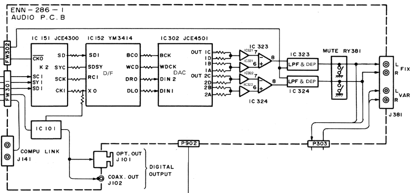

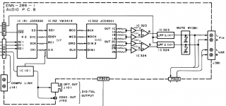

Do you mean they have added complexity to the output stage in order to increase the separation because they have used two DAC chips per channel?
That's interesting, a design trade-off, they must have gained something significant from using two WM8740s per channel in order to justify the added complexity in the output stage.

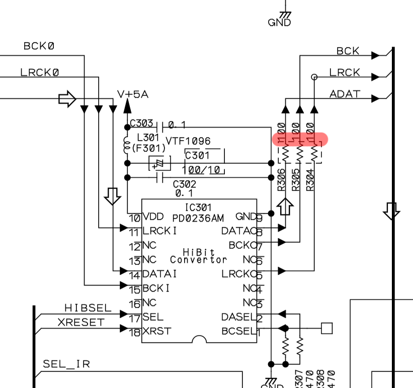

I got my 717 but it doesn't read! So I may end up using the chassis for my cd rom project. Would be nice to try to inject i2s into the dacs but I'm struggling to decipher that from the service manual. The dual dac chips isn't helping.

To steal the I2S signals just before they reach the PCM1716s, there are three resistors - R304, R305 and R306, next to square chip IC301, you could lift those resistors and solder wires on there.

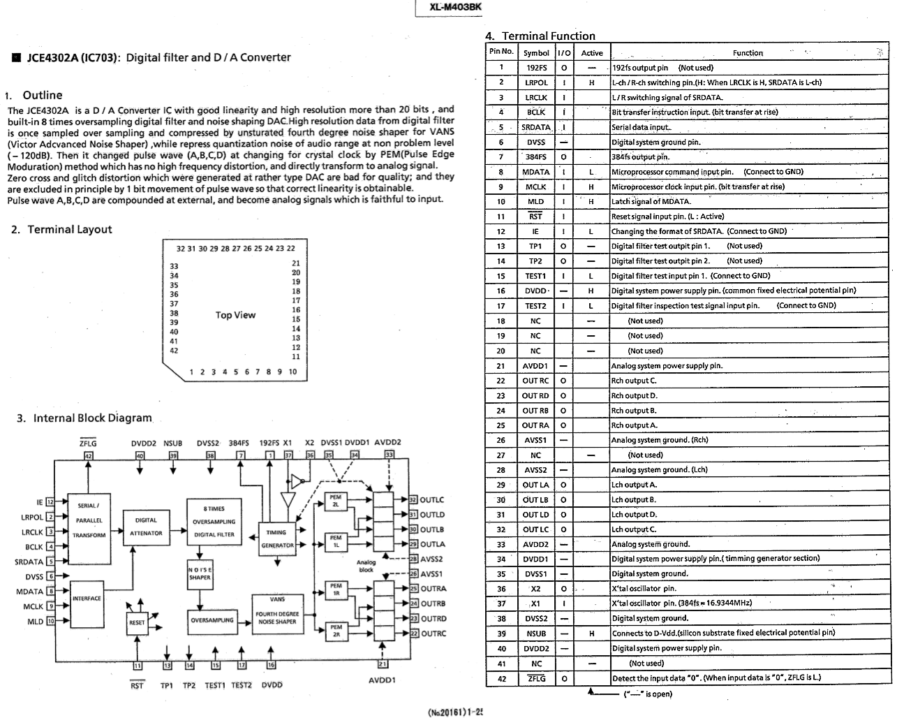

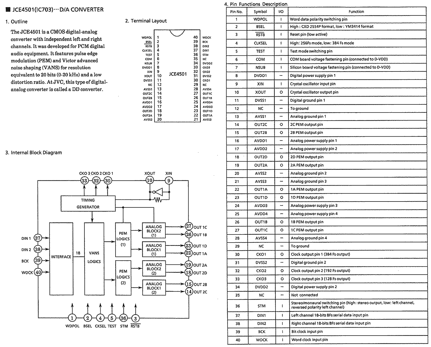

Usually paralleling DAC chip outputs will lower random noise level, 2 outputs 3 dB lower, 4 6 dB.
Does that only apply to paralleling the outputs of separate DAC chips, or also to paralleling the outputs of a single DAC chip?
I noticed that JVC produced DAC chips that had 8 outputs and wondered why, as they were summing those 8 outputs into a stereo pair.

Ian. Just been studying the manual today actually and yes I identified that IC301. But just to confirm this would be to inject an i2s signal into the dacs....not pinch the signal out. However if I do use a CD rom drive I doubt I'll be using an i2s anyway as they generally put out spdif. Unless I try my AK4118 spdif to 12s output board....but I will probably implement that into my Miro AD1862

Good guess. More specifically they are "source series RF transmission line terminators," that have selected to slightly over-dampen the line and reduce rise time a little. They help prevent ringing on the line from RF wave propagation reflections at impedance discontinuities. Reduced rise time is a trade off that helps reduce high frequency harmonics of clock pulses, which are the frequencies most likely to affect adjacent circuitry by way of stray coupling. Google 'time domain reflectometry' for more explanation about transmission lines and reflections.
This apply also to paralleling outputs of single DAC chip, but only for random noise, not to correlated quantization or dither noise. Also paralleling can fix little bit linearity error on LSB end but also if linearity error is random to + and - side between paralleled outputs. Lowest noise stereo DAC-s had inside 8 channel ESS Sabre chip where channels are paralleled.
