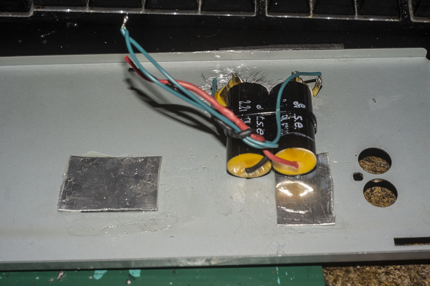

No. The point being that using stuff one already has not often leads to optimal design. Your remarks are right but then why the caps are already dangling in the air connected to new RCA connectors? One could have reused the old RCA output holes to fit new ones...

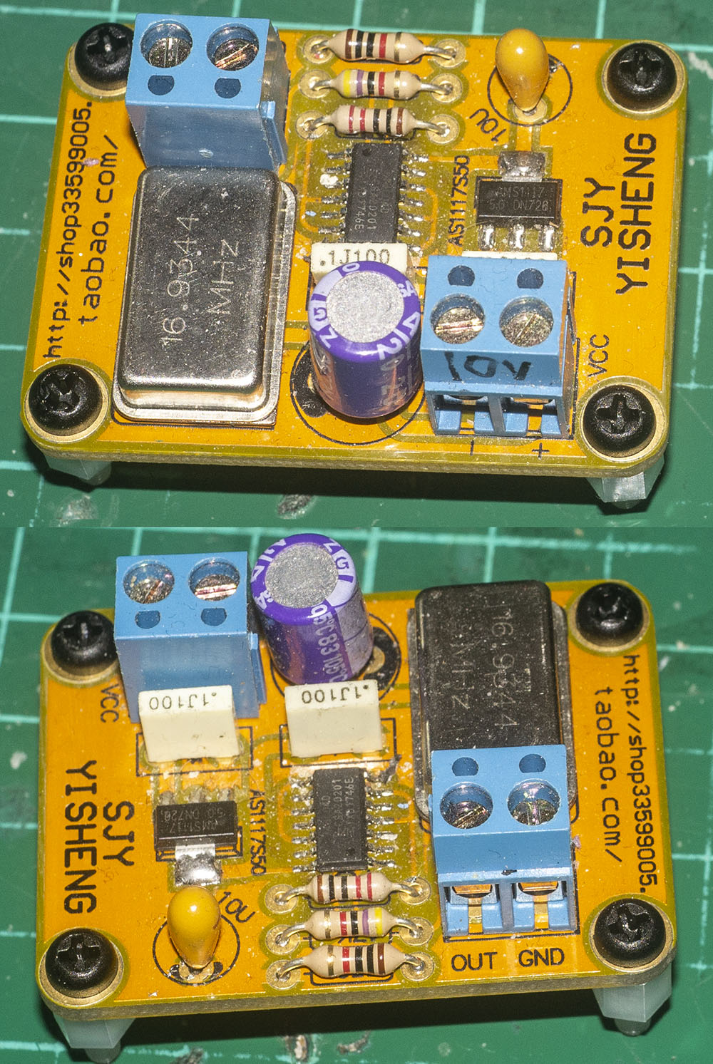

I have a low jitter clock module I could install, it has the correct 16.9344Mhz crystal for this player.

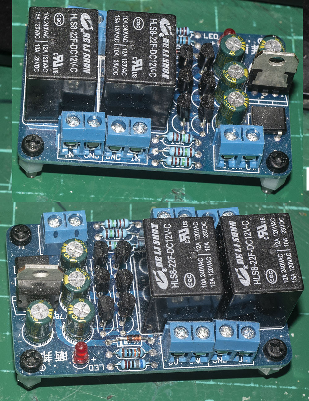

I also have a relay module, it is intended for speaker protection in an amplifier, but I suppose it could be used for muting too?

The low jitter clock you have makes no sense as it has the most noisy regulator available on this planet. I regularly see this crappy regulator being used in audio even in commercially sold devices. This regulator is way worse than any 78xx!! Cheap Chinese electronics are fun but rarely are suitable for quality designs.

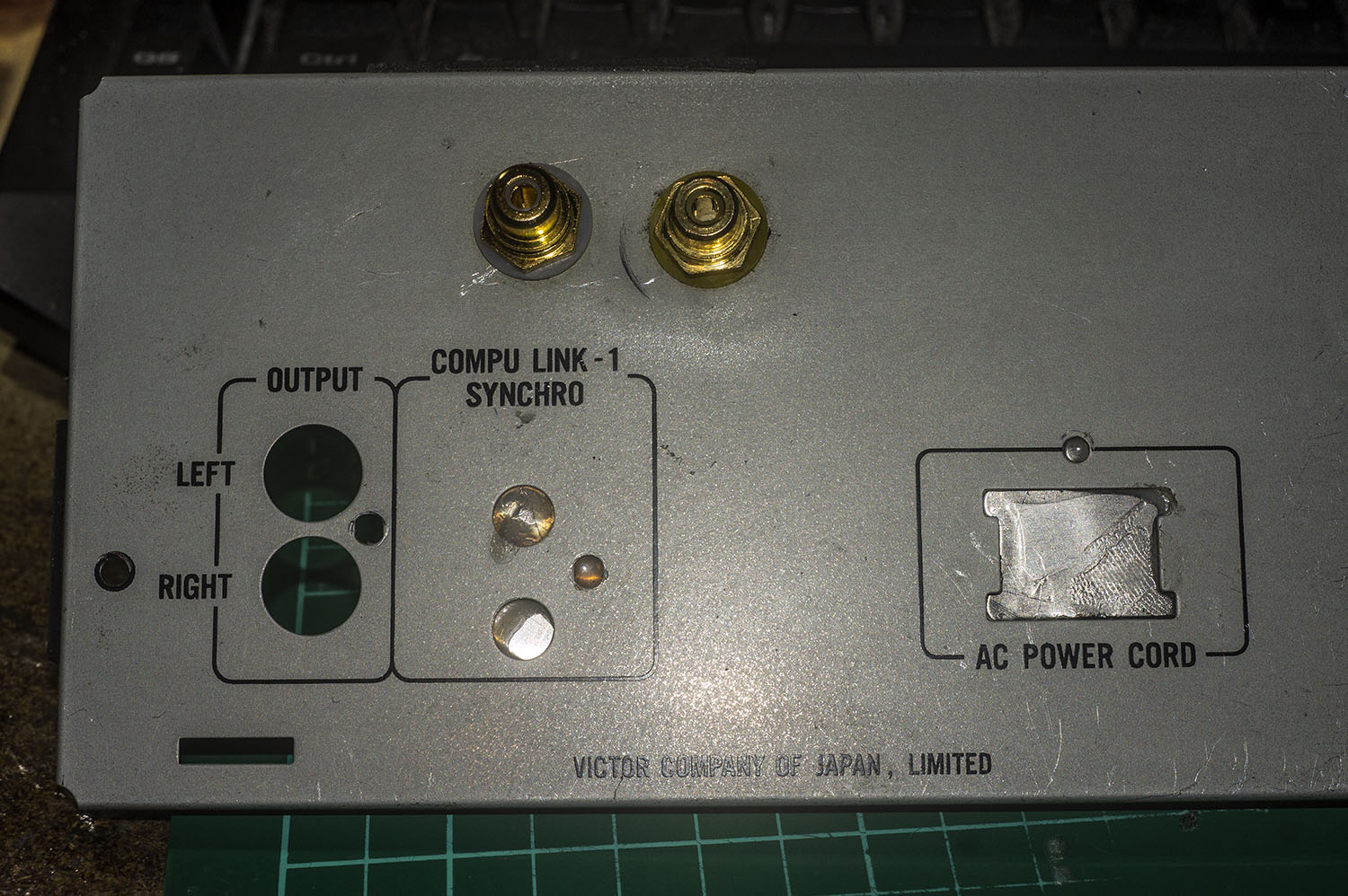

I fitted the RCAs and caps as I thought it would give me something to work around in terms of how to physically place the various additions in the space available, if that makes sense.
No but that does not matter anymore as the holes are already there.

The clock module, I assume you are talking about the AMS1117 regulator? I could try to remove it and replace it with a better regulator, I have some HT7333s that are also in the SOT-89 package and would be a direct replacement.
If not, I suppose I'll have to look at building a low jitter clock circuit, I can salvage the crystal from the crappy Chinese one.
Sorry but it is your own information that lead to my view. You already wanted to bypass the output stage and were already busy changing/replacing caps. The holes are also already drilled..
Anyway, I think it can be done more optimal with some thought. This takes a different way of looking at things. To value what is already good and to change less optimal sections to a higher level with elegant craftsmanship. Choose new parts with care and best-for-the-purpose.
The HT7333s has no data on noise in the datasheet and therefor is likely even worse than AMS1117. The latter has no place in any serious design. Have you checked its datasheet? Please do so and tell me why we shouldn't use it.

AMS1117 has around 100 µV of noise.
I don't disagree with you, and I think you're right, it is highly likely that improving the PSU arrangements will yield sonic benefits. I just started with the assumption that the analogue stage is being replaced, other than that, I think my approach is pretty much as you suggest.
I couldn't find any noise figure in the datasheet, but I did read that LT1763-3.3 has 20uV noise and ADM7150-3.3 has 1.6uV noise. That means ADM7150-3.3 has about 2% of the noise of AMS1117.
I suppose I could try to replace the AMS1117 on this clock module, but I think it would be better to ditch it and build something else. Do you happen to have any suggestions for low jitter clock circuits?
Hi I used a lot of Tent modules both DIY and the ready made versions.
ADM7150-3.3 seems a good candidate as the XO with its current AMS1117 won't bring improvement. FWIW I obtained a lot of industrial linear PSU's in the right values all new and unused. These are cheap, discretely built (!!) and very low noise, have 240V mains inputs and mains transformer on board. My tests with them are satisfying till now. I just checked and I have them in +/- 12 ...15V with an extra PSU that outputs 5..6V 1A. Maybe that one can be modified to 3.3V. Not wanting to sell you a vacuum cleaner but if you can use one of these send me a PM. As these can be mounted with just 4 screws a lot of practical difficulties are solved at once.

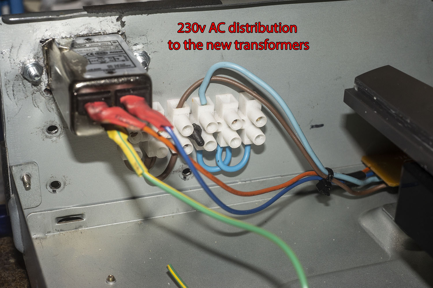

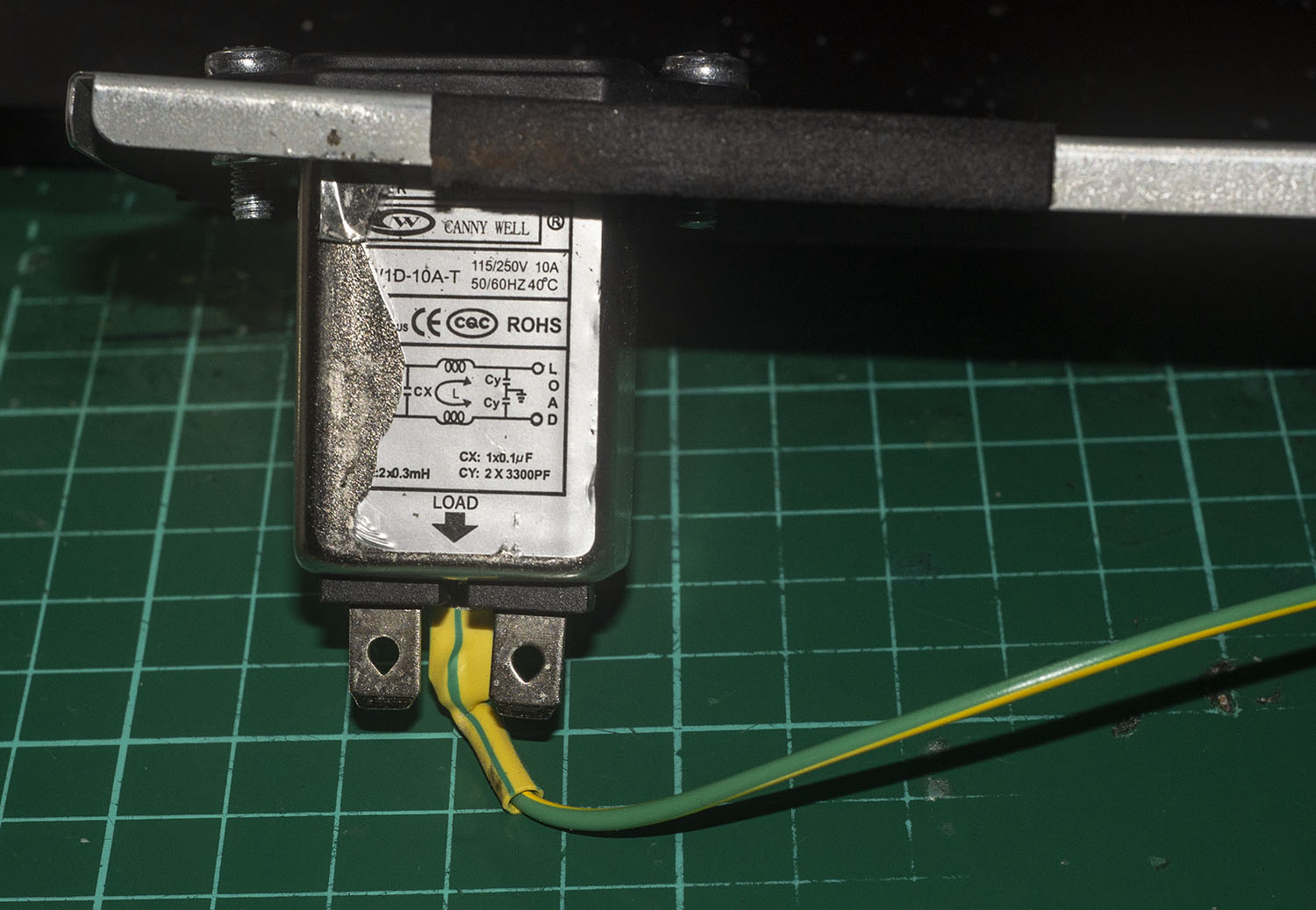

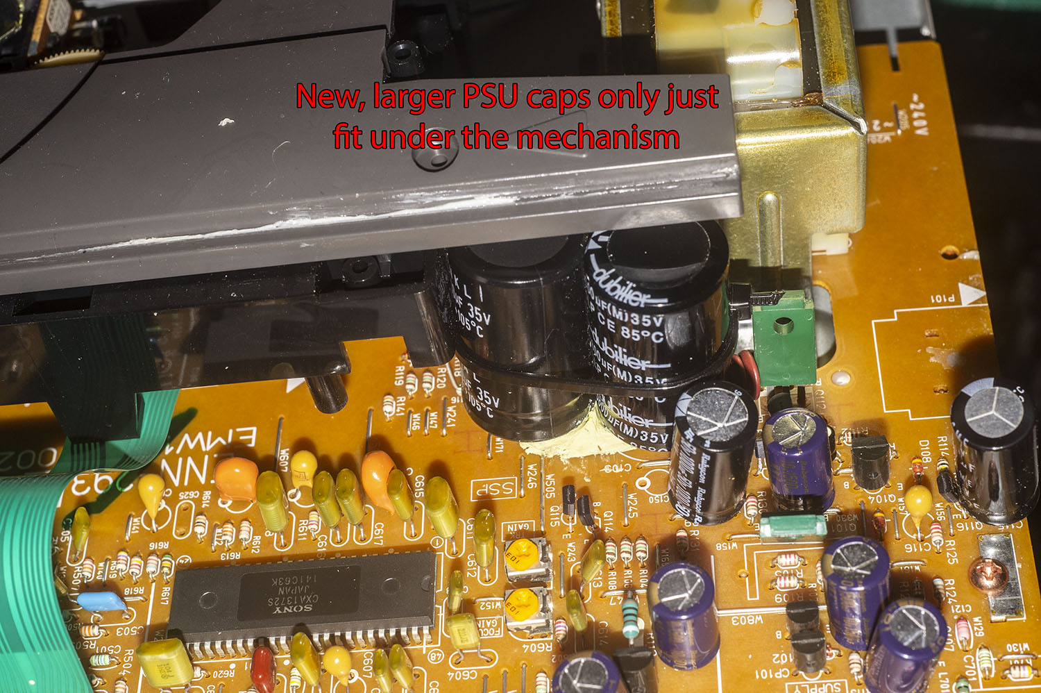

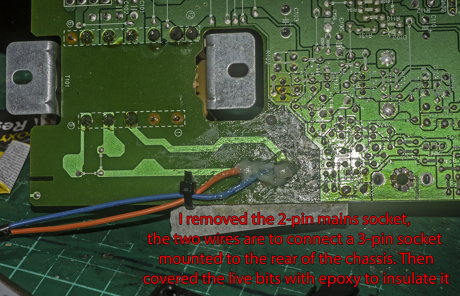

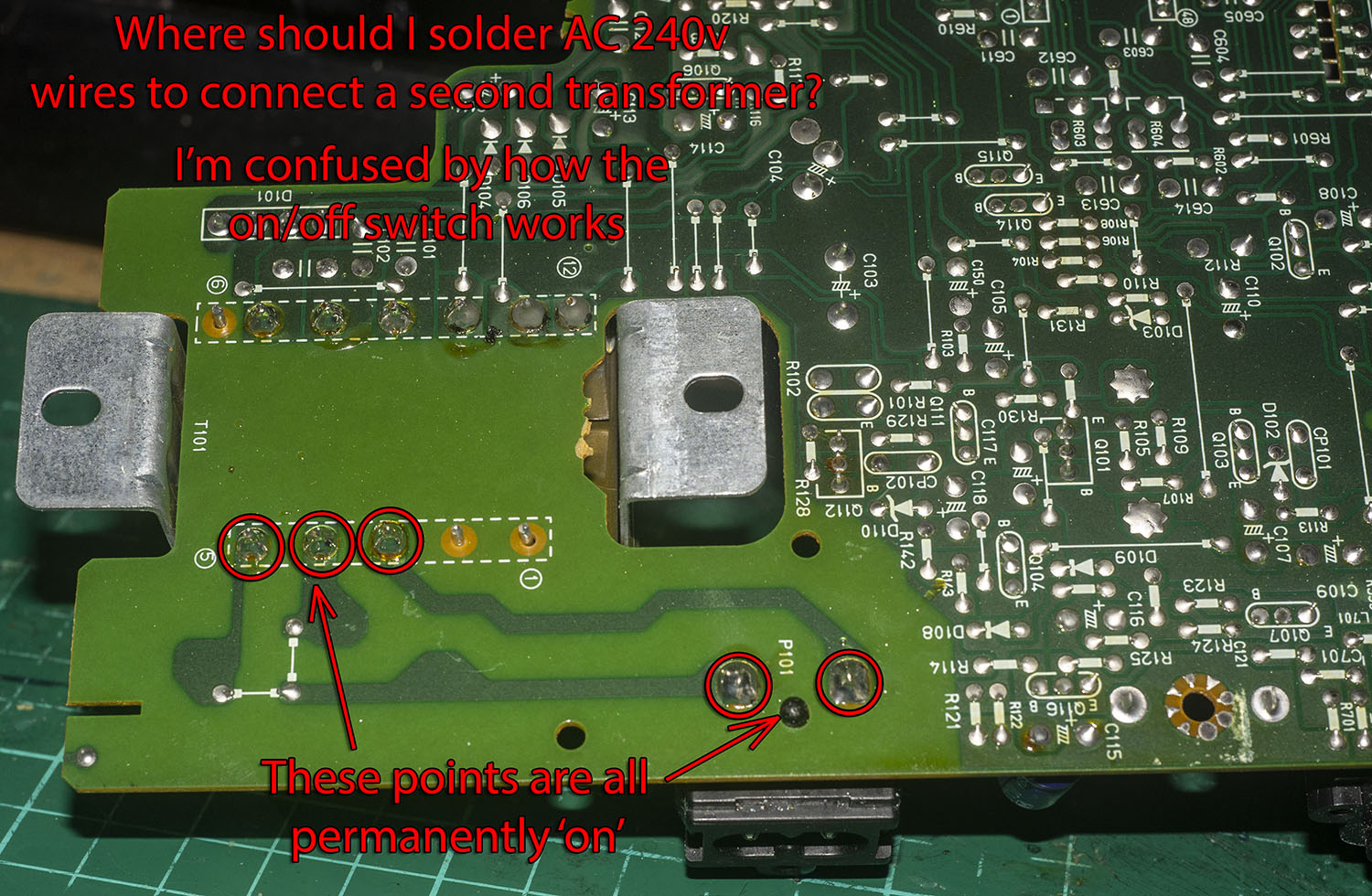

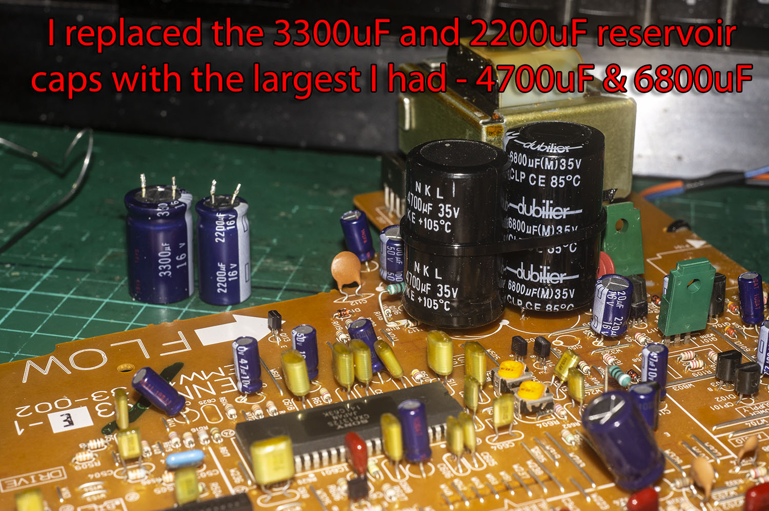

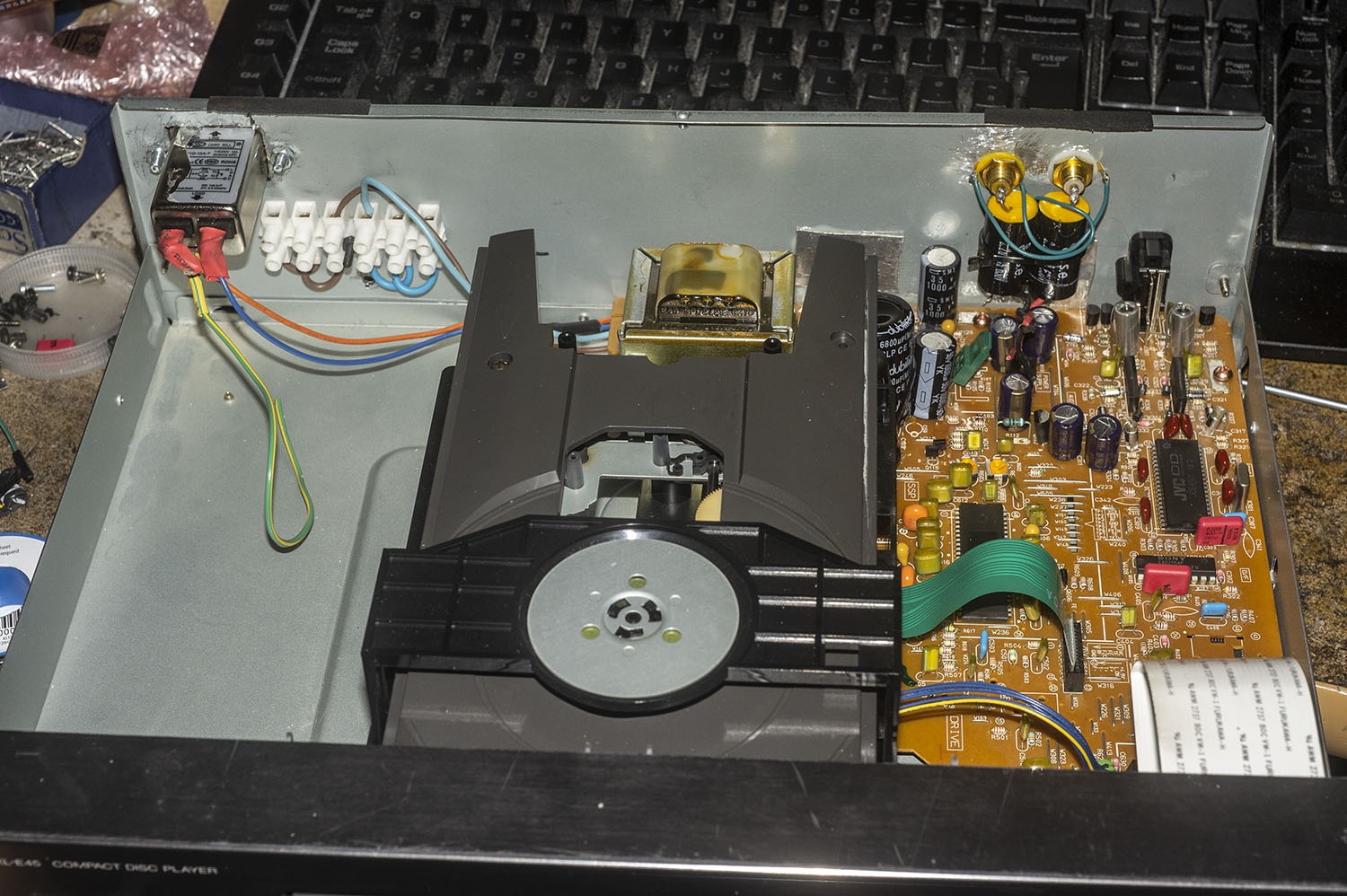

I dismantled the player so I can rework the power supply arrangements. I've fitted a 3-pin Schaffner socket that has a built-in AC filter for cleaner power. I've replaced the reservoir caps with the largest ones I had - 4700uF and 6800uF replacing 2200uF and 3300uF. I'm going to add a second trafo with dual 18v secondaries and an LM317/337 board to power the analogue output stage. I'm also going to add some 5v regulators too, not sure if I'll add another trafo for those, I might have one with 6v secondaries, I'll have to check. I plated over the holes left in the back after removed the mains socket and the Compulink socket.

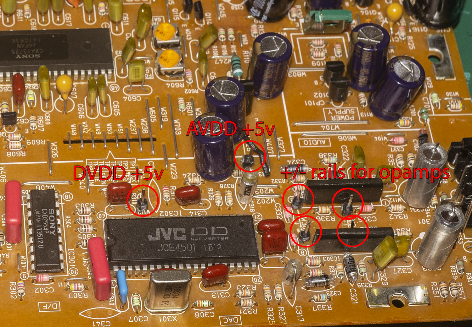

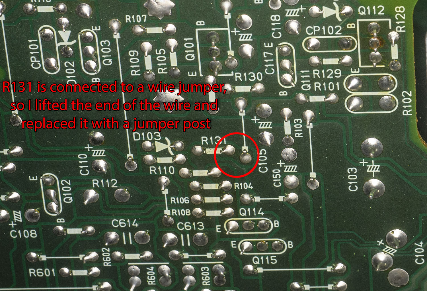

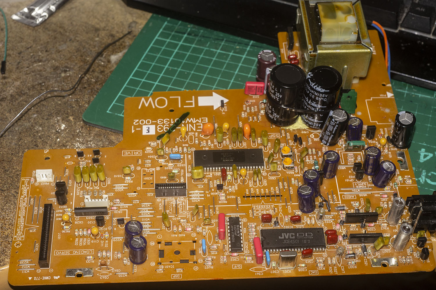

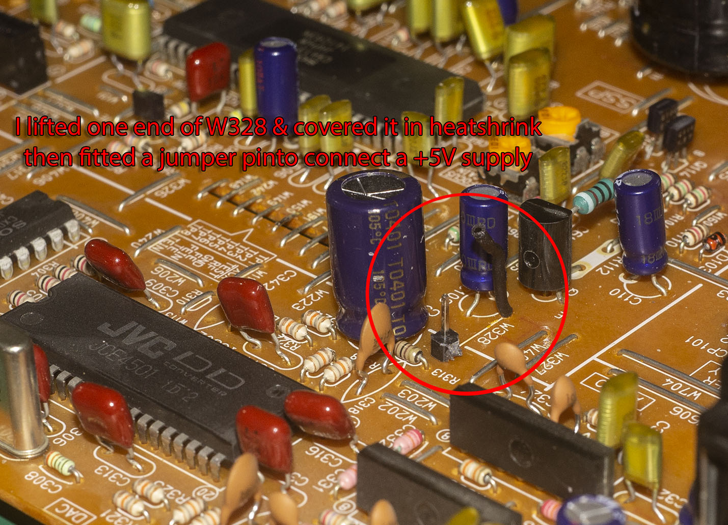

I discovered that I don't need to lift one end of R313 as R313 is connected to a wire jumper so I lifted one end of that wire jumper and fitted a jumper pin so I can connect a +5V supply.
I'm wondering now what other caps I should replace.

I recapped the whole board, all the electrolytics have been replaced, the small values under 100uF with tantalums, the larger ones with electrolytics, mostly low ESR Rubycon 1500uF. The ceramic disk caps have all been replaced too with the smaller values replaced by polystyrene and the larger ones by Wima MKS4. The two 100uF electrolytics in the output stage which are in the signal path have been replaced by 100uF tantalums.

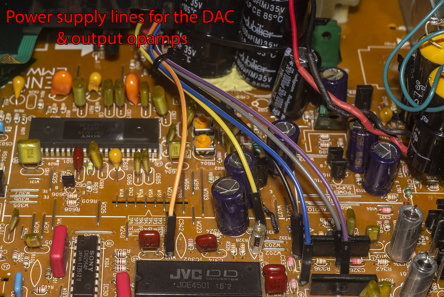

I've identified the correct points where clean power supplies to the DAC and opamps should be connected, in all cases there were wire jumpers that could be removed and replaced with jumper pins. So there are now jumpers to connect power to both the digital and analogue sides of the DAC and to both opamps, I don't think i can improve thee power delivery any more than that.

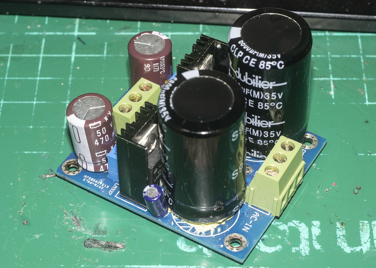

To power the opamps, I have an LM317/337 board, I've replaced the large caps on it as I was suspicious of the ones fitted, probably Chinese fakes. 3300uF 'Nickicons' have been replaced by 6800uF Dubiliers and 100uF by Nippon Chemi Com. 470uF.
So now I have to put it all back together and build and install two +5v supplies and a +/- 9v supply for the opamps - I'm only using 9v as the 100uF tantalums I fitted are only rated for 10v, which might be a compromise I shouldn't make, but as I stated early in the thread, this is a learning exercise so I'll see how 9v works.

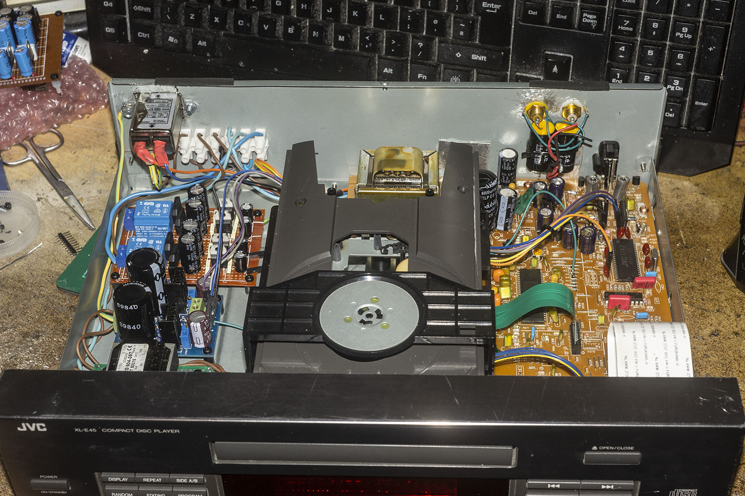

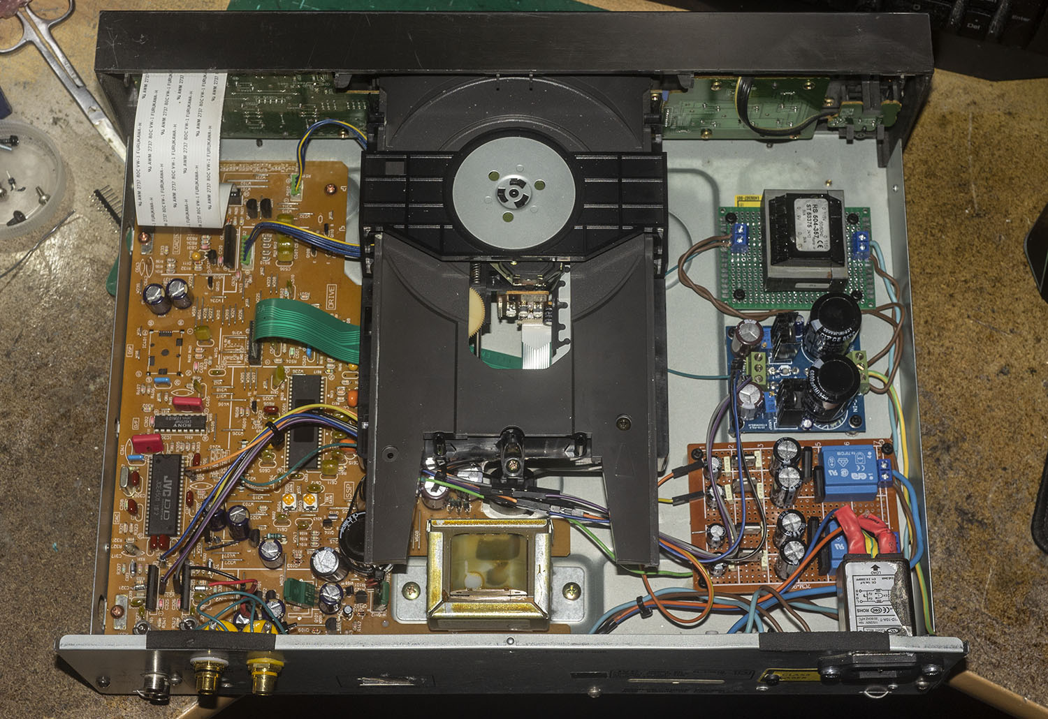

Well, so far, so good. I've reassembled the player and it works fine in that it powers up, reads a disk and plays it. There is no sound obviously, as there is no power to the DAC or output opamps, but at least I've verified all the work done so far is okay.
Now to build and install a dual rail supply for the opamps and a pair of +5v supplies for the DAC....

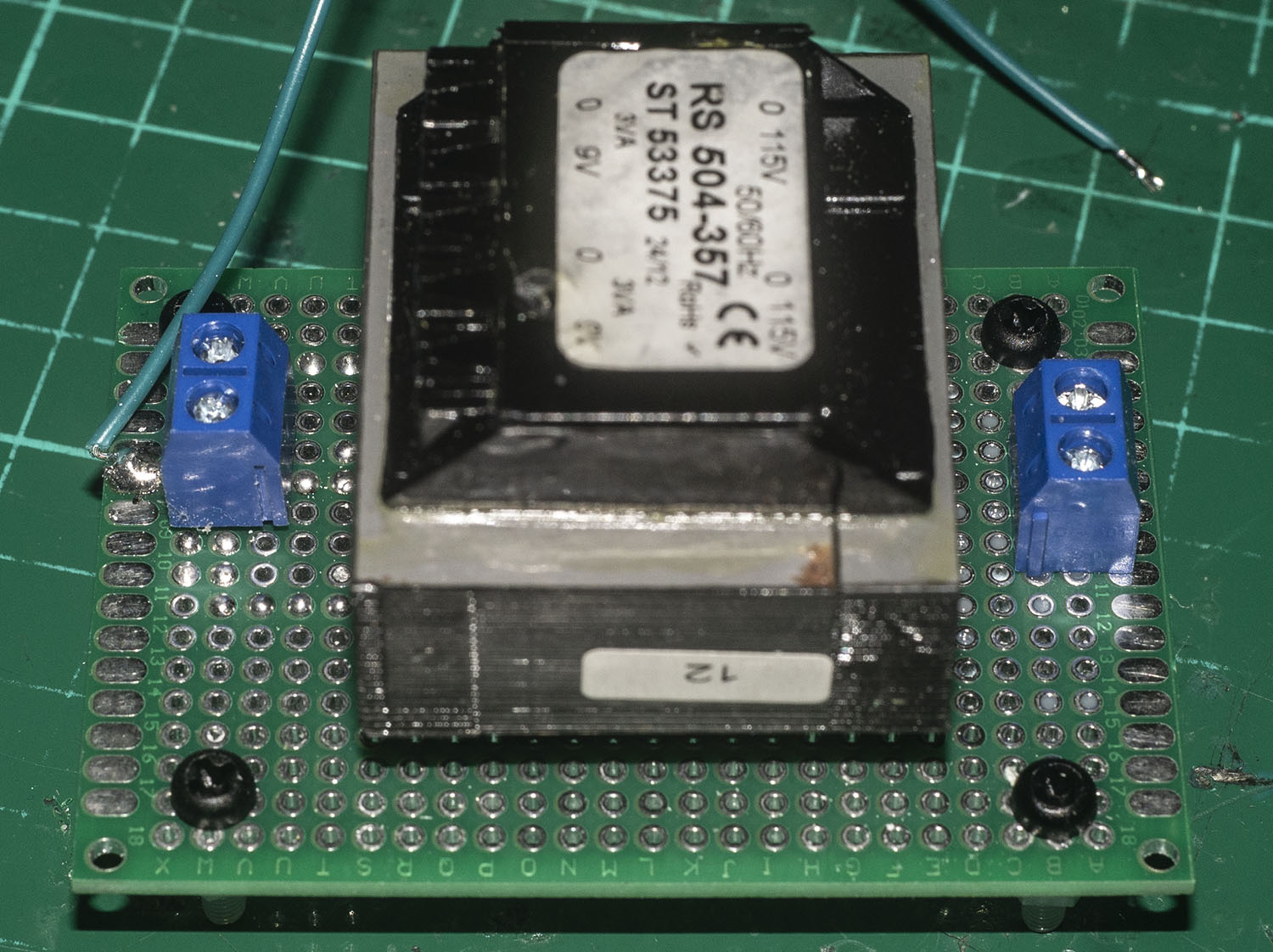

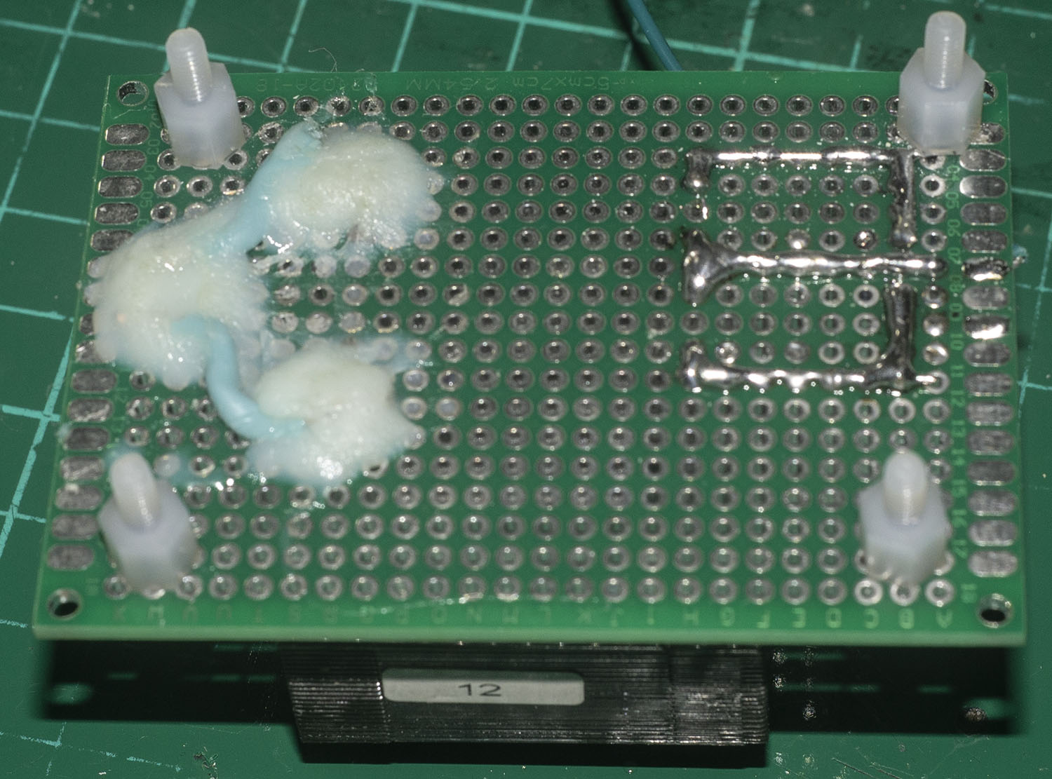

I found a PCB mount transformer with a pair of 9v secondaries in my stash of parts so I used that to create a dual rail supply in conjunction with the LM317/337 board. I decided to use the mini PSU I showed earlier in the thread for the +5V supplies, only one half is needed, so there are two spare +5V supplies that could be used for further mods.
I assembled it all and it works in that it powers up and there are no sparks or magic blue smoke, but I must have damaged something in either the drive mechanism or the servo electronics as it doesn't spin the disc. Oh balls, I shall have to try to diagnose the issue. Hope it's something simple.
I'm quite happy with how it's turned out, so I really want to fix the drive issue and hear what it sounds like now.
