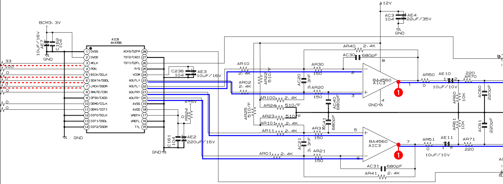

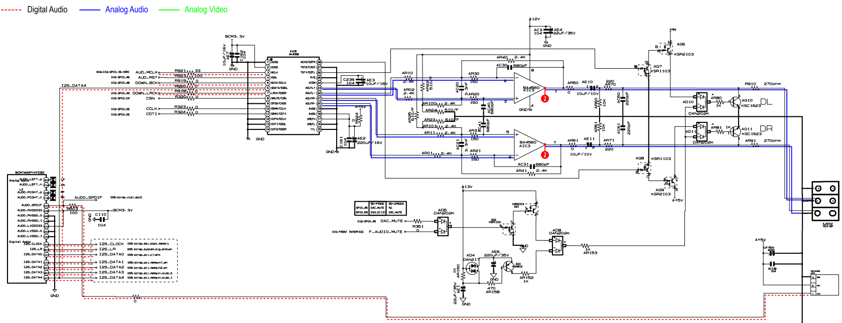

I had a surprising experience today, I spotted a used Samsung blu-ray player for sale locally very cheap, Goggled it's service manual and it has an AK4396 in it, so I bought it.
In stock form it sounds really rather good, surprisingly good in fact.
I'm tempted to bypass the output stage and see how it sounds with just a pair of Russian PIO caps between DAC and RCAs.

Ian I've been reading the 300 page thread on the Chinese AK4396 boards. Gave up after 100 some but I got the gist.
Indeed it being a differential output dac one can use either trafos or caps as output. Some prefer the active opamp based, others not. Worth a try.

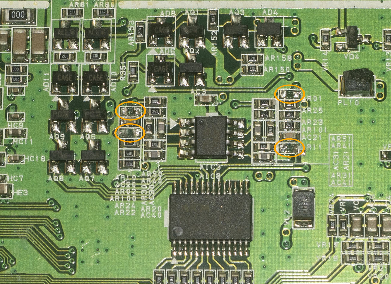

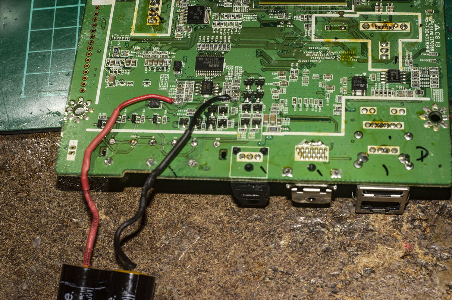

I've modified my Samsung BD player by removing four resistors and soldering on a couple of wires to a pair of 2.2uF caps then direct to a pair of RCAs.
I must have done something wrong as while I am getting music, it is at a very low level of volume. I soldered the wires to the negative outputs, maybe I should have used the positive ones - I didn't because it was more difficult to solder to those pads.
The problem is the board in the Samsung is SMD and trying to solder to tiny pads is tricky.

I resoldered to the positive pins and now I'm not getting any sound at all, so I suspect that the little pads have become damaged. SMD boards are so difficult and annoying to work on. I'll try to solder direct to the pins of the DAC chip, if that doesn't work then I've got a broken player.
I must have failed to make the solder connections properly as I've redone them a third time and now it works, I get music at the normal volume and it sounds good.
I won't be making any further modifications to this player beyond the output stage bypass as soldering SMD boards if just too much hassle. For the 20 ukp it cost for the player and about 5ukp for the caps and RCA connectors, I think it's a worthwhile little project and it sounds pretty good too, good enough that I can take my time devising something else.
I'm surprised how good this blu-ray player sounds actually, compared to the Pioneer DV-737 which is a pretty good sounding device, it's a marked step up in clarity. There's no audible pop or noise at all when skipping between tracks, despite the absence of any muting circuitry. I must have got lucky with these 2.2uF T.S.E. caps, they were pretty cheap but sound great, I have some EPCOS 2.2uF polypropylene box caps and 2uF Russian MGB PIO caps that I could try instead, but I'm not going to bother as I'm rather happy with how these T.S.E. ones sound.
