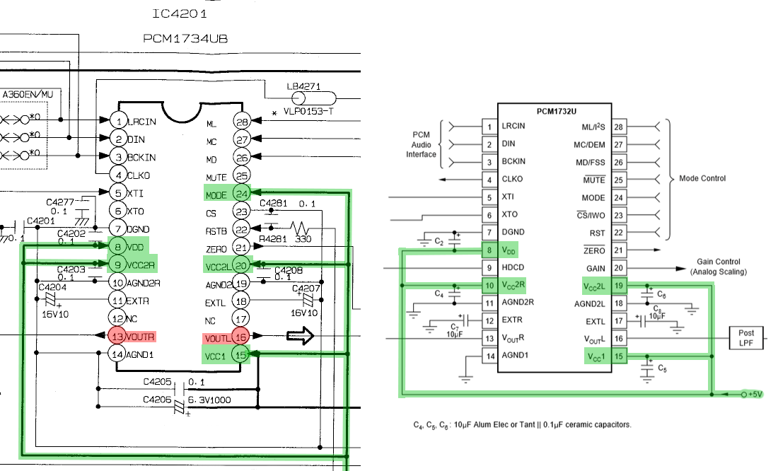

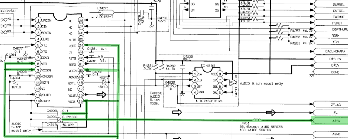

After studying the SM further, the PCM1734 in the Panasonic is a V out DAC like the PCM1732, they have similar but not identical pinouts and I expect they are very similar chips.
The datasheet for the PCM1732 suggests having nothing in the output stage other than a LPF to get rid of anything above 20kHz.
So now I'm wondering what I can do with the output stage of the Panasonic, I'd like to get rid of both of those NJM4580M opamps . Would just using a single high quality capacitor work or do I really need a LPF?
One thing I'm confused about is the voltage of the output, the PCM1732 datasheet says it is 0.56V, so does there need to be some gain in the analogue output stage to increase it to the 2v of line level?

It depends if you like your audio to have jagged edges. You could always cut the trace going to the opamps or remove the first electrolytic caps at the dac outputs and connect your own high quality film caps there. You may not end up with much bass though unless you buffer it with a high input impedance buffer of some kind or else maybe use a huge cap. Anyway, you can try it and see if the resulting sound is to your liking. You could also revise the output stage to use *much* better opamps, bypass caps, DC blocking caps, etc., and maybe you will get the dac working well enough that you can start to notice the problem with its jittery clock, etc. As is, such things may be masked by other problems with the existing output stage

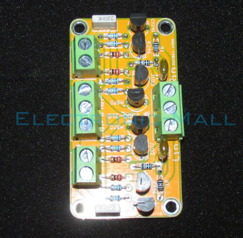

Would a JFET buffer be suitable? I happen to have one of those sat here.
I have loads of JFETs so I could build a different buffer, I have a load of Toshiba 2SK30A which have low noise like the 2SK170 but a lot less gain, which shouldn't be an issue in a buffer I think?

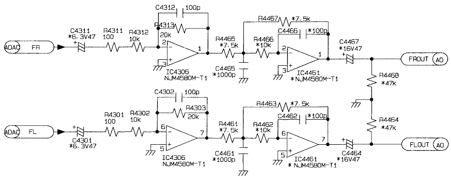

I must have looked at 20 or more service manuals yesterday, examining what DAC chips and analogue output stages the various players had and nothing else apart from one Yamaha DVD player came close to the Pioneer 737 and 717, even the TOTL Sony S7000 was much inferior, a single DAC chip without local regulated supply and an OPA2134 as the output stage.
I'm thinking of buying another 737 or 717 to tweak, keeping the one I have in stock form as it will be in daily use playing CDs.
Every DAC chip I have seen uses 5V so I think using a local regulated supply is the way to go, either an ultra-low noise reg like the LT3042 or a discrete superegulator. I'd be very interested to know what you think and implement as I'm very much a beginner and might be talking out of my rear end...

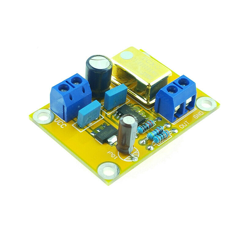

I've been reading about various buffers to the point my head hurts. I have found this info from Calvin which fits with what Mark was saying about bass and caps, given I listen to mostly things like ACDC, Led Zeppelin, Queen etc. I definitely need the power and slam:
"As for the Buffer I´d say that a simple JFET Buffer in B1 or similar style tends to sound a bit ... well delicate, feathery.
They can offer a lot of Detail and lowlevel resolution and give a natural impression, well suited to classical and intimate Music.
With vastly oversized Caps close to the JFETs Bass performance improves, but these circuits will probabely never become HellsAngels.
If You want power and slam look for something different, for example the Calvin-Buffer might just be right, if You want the filigrane and the power at the same."

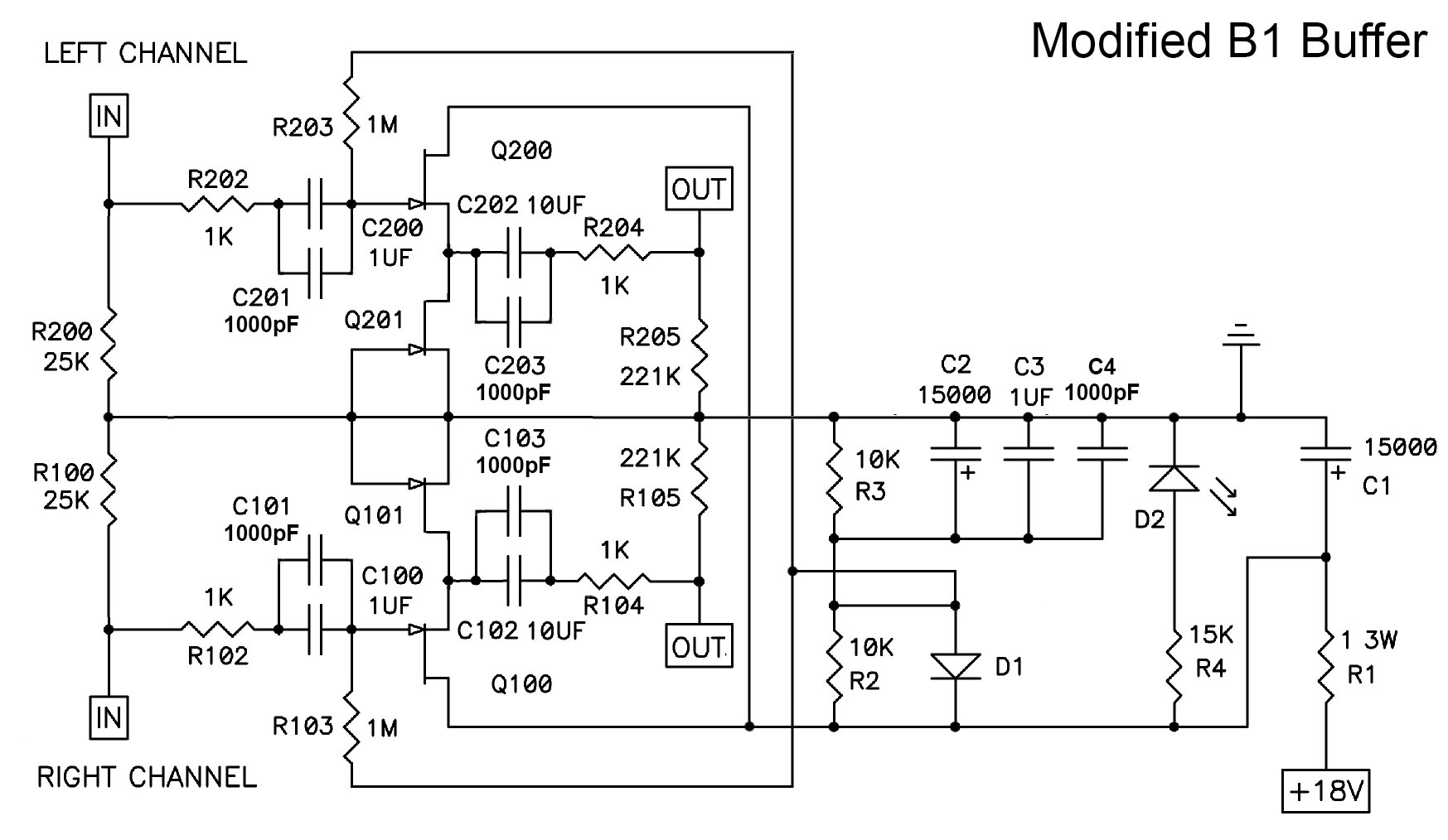

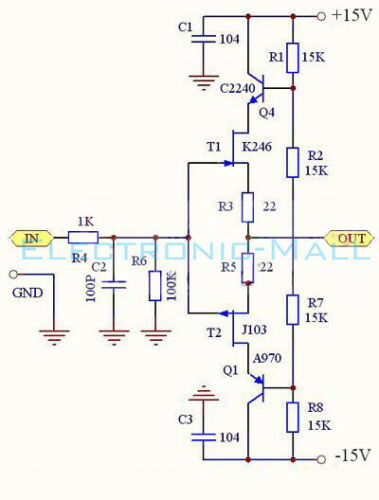

I forgot that back in 2018 I already went through the process of modifying the B1 buffer to work in a DAC output stage:
Modify B1 Buffer for DAC output stage
I could build this B1 variant, I have the parts, but I'm concerned it will not have enough bass, lack the power and slam etc. Maybe I can remedy that with adding caps? However, I probably should follow Calvin's advice and look at a different buffer design.
If you want deep bass you might need to ditch the output caps and servo the output to get rid of any offset. For that it would need bipolar supplies. Servo design can be tricky though; done improperly it can hurt the sound. Another way is to use big electrolytic output coupling caps, say, 470uf Panasonic FM (then give them some time to 'burn in,' possibly a few weeks), but it won't sound as clean as film caps. Yet another way is to use matched jfets similar to your schematic but with bipolar supplies. If the fets are matched well enough you can adjust the DC offset by adjusting the operating current (adjusting the current source output). You still might find you need a servo to fine tune it.
EDIT: Then again, its possible to get pretty darn good sound from modern opamps such as OPA1612 or OPA1656. Bipolar supplies and rolled foil film bypass caps. R-core transformer with separate secondary windings (no center taps). In that case the opamps can be used to remove the DC offset. This whole thing is still turd polishing, of course

Well, I want John Bonham to sound as he should, so plenty of 'power and slam' is required methinks.
I'm keen on simplicity as I lack the experience to do anything complex, so maybe I might just be best off using a good opamp.
The variety of options is hurting my brain, to be honest, I'm finding the learning curve a bit steep.

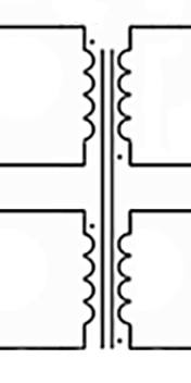

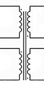

What about using a pair of 1:1 transformers? I ask because I happen to have a pair of them I salvaged from a PA amp I stripped for parts and Sowter recommends using 1:1 trafos with V out type DACs.

The transformers probably won't like DC current in the windings, which is what will happen if there is no DC blocking cap. If there is a cap, then it may need to be pretty big depending on the load the transformer presents to the dac output. That loading factor will depend in part on what is connected to the transformer output. However, if someone makes transformers designed to work with this type of dac chip, then that might be a reasonable solution. Regarding the transformers you have now, seems doubtful a Sowter line level signal transformer was designed for tolerance of DC on the windings. What does the transformer data sheet say?
Here's the Sowter page on trafos for DACs;
DAC I/V CONVERSION OUTPUT TRANSFORMERS
This is the 1:1 trafo they suggest for V out DACs:
SOWTER TYPE 3603 Balancing transformer

Looked at the Sowter info. They use a DC blocking cap with the transformer. You could try it that way. The cap will affect the sound, the transformer will affect the sound too. So will whatever comes after the transformer. It won't be the cleanest, most pristine sound but it may be a sound you like. Only way to know is to try it and see what you think.

What sort of cap do you recommend for DC blocking in conjunction with the trafos? I have quite a few to choose from in my stash.

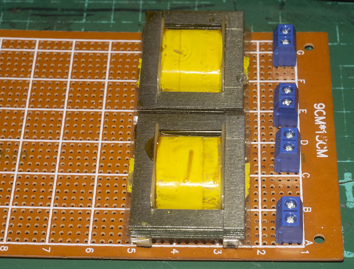

I soldered the trafos onto a board a while back, there's loads of room left to add large caps or whatever else is needed.
I cut the trafo schematic out of the service manual for the amp I salvaged the trafos from, they have 8 pins each, I'll have to study how to wire them up.
