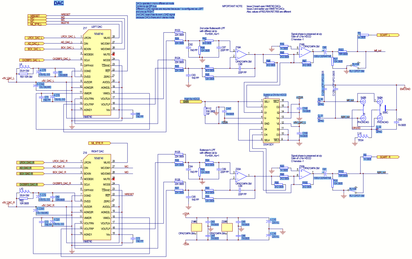

While looking at DVD players last night, an ARCAM DV88+ was listed for 25 quid BIN, so I immediately snapped it up. It had only been listed a few minutes, but for that price, I was having it.
The DAC & output stage of the DV88 looks to be rather excellent,– dual WM8740s, one OPA2134 per channel output stage, discrete LFP, relays instead of muting transistors (ain't that a rarity!), isolated +/-12V supplies for OPA2134s, isolated +5v supplies for DACs, SILMIC & CERAFINE caps, hard to see much there that needs to be tweaked or upgraded.

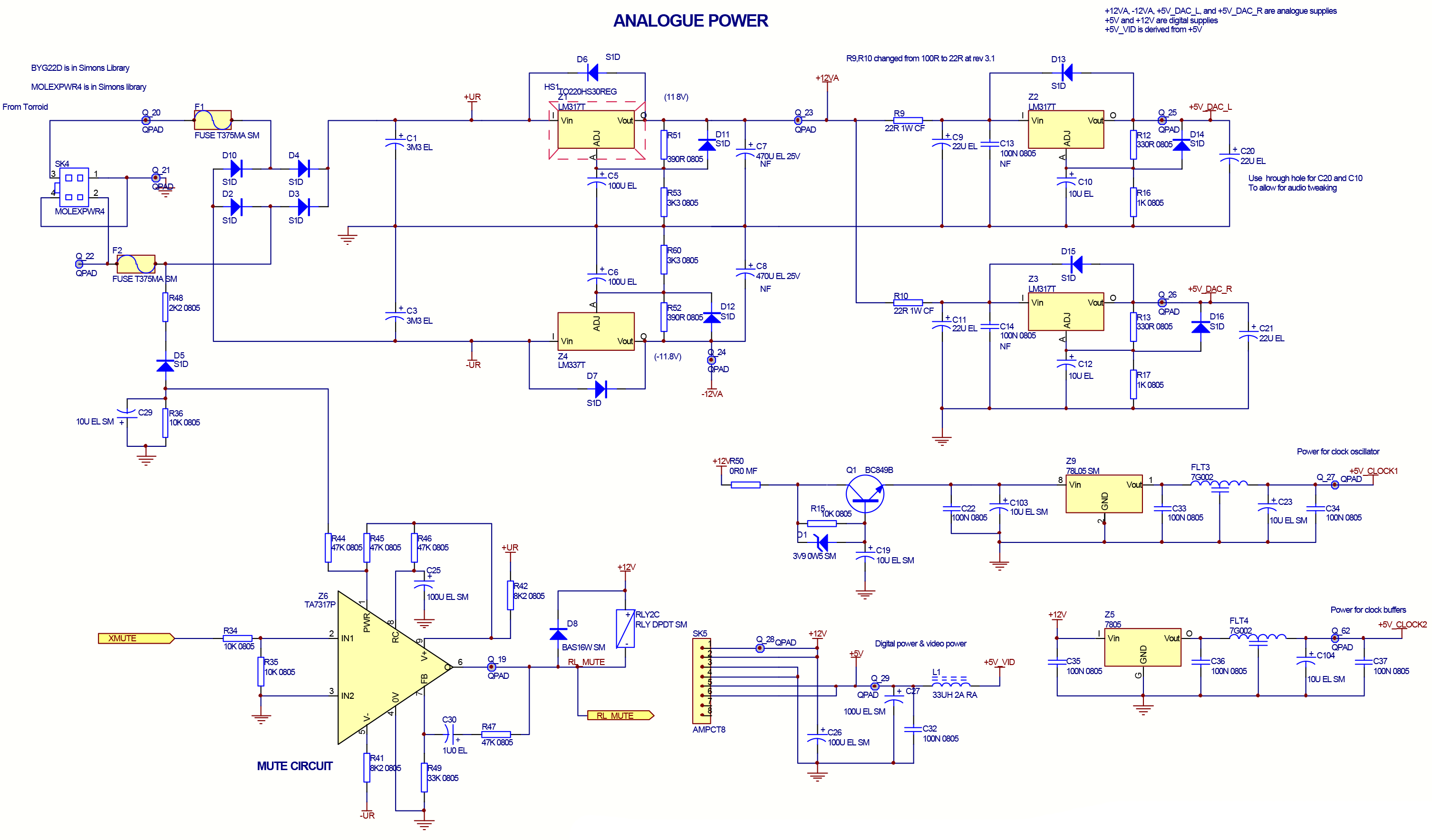

I'll have to check, but I think the ARCAM is using 78xx regs, so I could definitely improve things there with more modern parts. I've got loads of polypropylene, tanatalum and OSCON caps in my stash so I can always make a few improvements there too.
The power supply arrangements in the DV88 could certainly be improved, it uses an LM317/337 combo to provide the +/-12v for the OPA2134s in the output stage, a pair of LM317s to provide +5v to each of the WM7804 DAC chips and a pair of 7805s to power the clock and clock buffer.

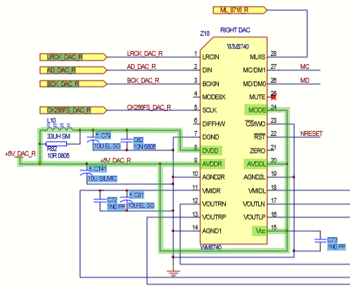

The ARCAM has a single +5V supply for each DAC chip, each regulated by it's own LM317, labelled 5V DAC L and 5V DAC R.
attachment.php
Each DAC chip has four 5v inputs - VCC, AVDDR, ACDDL, DCDD and MODE. I think MODE is just to put the chip into differential mono mode so we don't need to worry about that.
So do you think I should use more than one supply for each DAC chip? If so, how would you arrange the supplies - one for VCC and one for the other three, or give all four their own individual supplies?

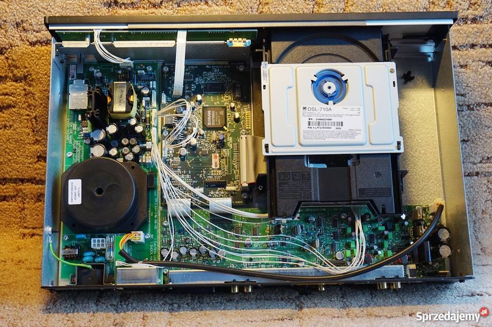

There looks to be plenty of room for adding more elaborate power supply arrangements for the DACs - the bundle of cables running along the bottom from the PSU board to the bottom right corner is probably carrying +/-12V, +5V and GND on it's four pins and the LM317/337s that regulate the supplies for the DACs and the output stage opamps are located on the bottom right. There's a load of space along the right hand side of the case where I could place power regulation and perhaps a small trafo.

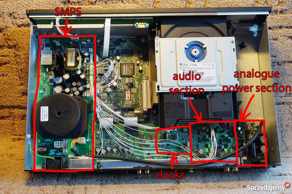

So it doesn't have an SMPS....bonus. unless the black round thing is a dc convertor?
I would definitely suggest adding separate rails to the digital (DVDD) and analogue (AVDD L/R) rails. I see they have a ferrite bead to split these in the Arcam so I don't know how big an improvement this would actually bring, but as you know generally these rails on separate regs is a good thing.

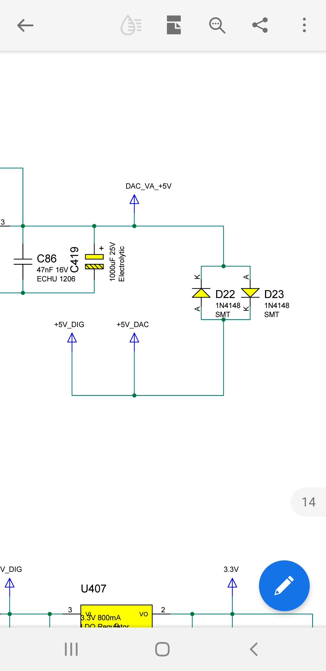

I add the schematic of what CA did in the later dacmagic, not as good as the Arcam by the looks.

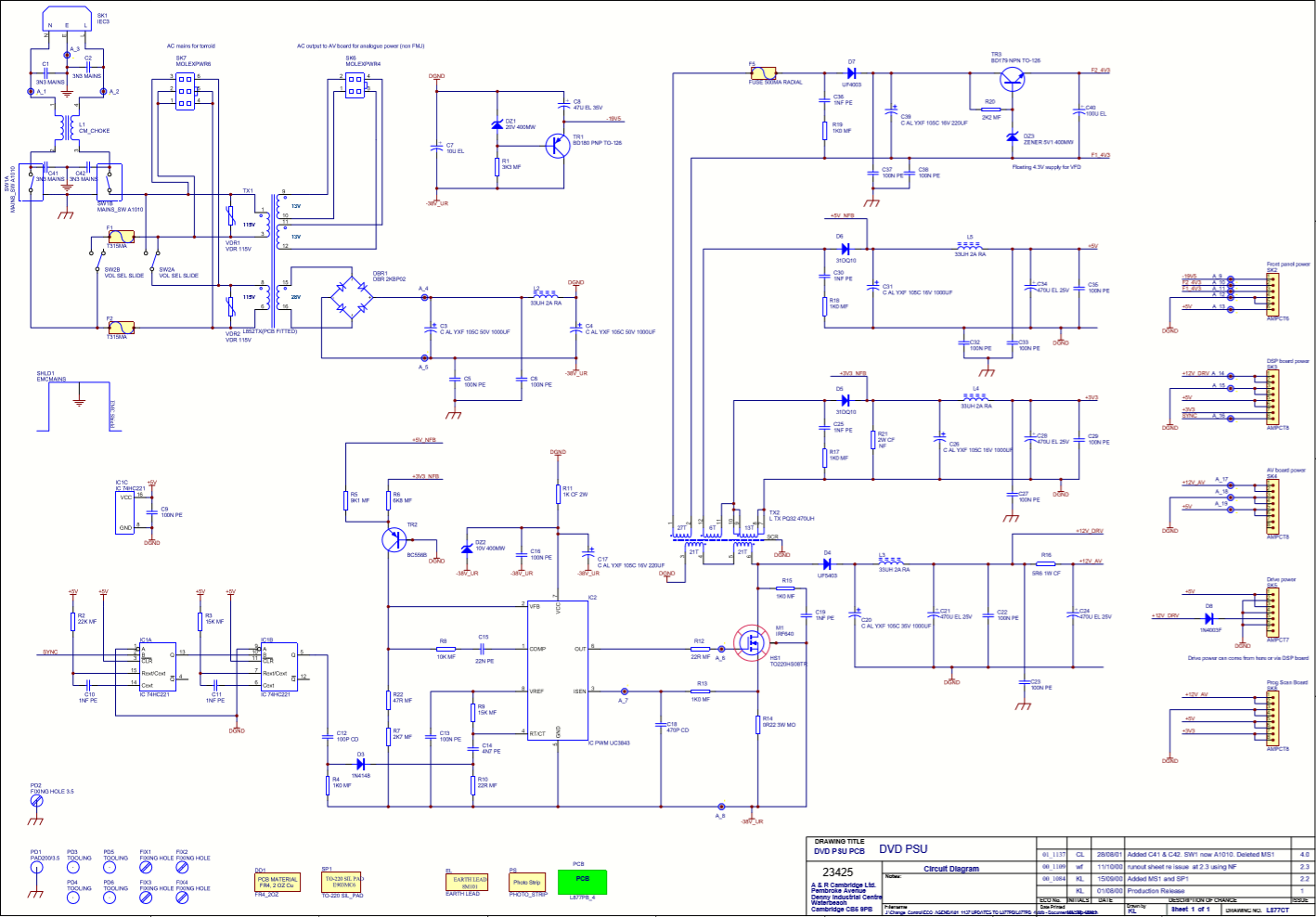

It has an SMPS, the big round thing is a toroidal trafo, this SMPS board supplies +12v to what in the manual is called the analogue power section, which is where the LM317/337s and 7805s are.

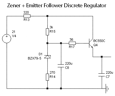

What about using a discrete Zener+emitter-follower regulator such as shown on Werner Ogier's website? He shows noise plots that have a lot less noise than an LM317:
Simple Voltage Regulators Part 1: Noise - [English]

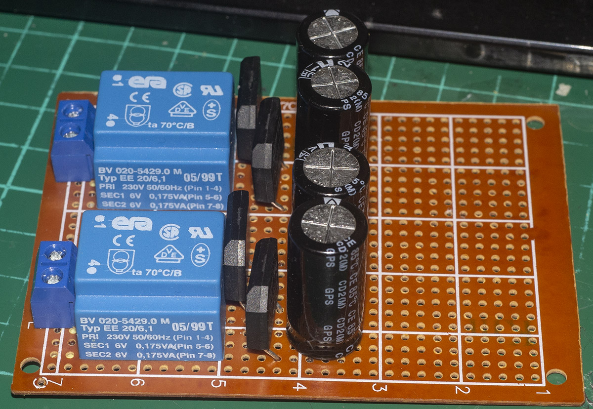

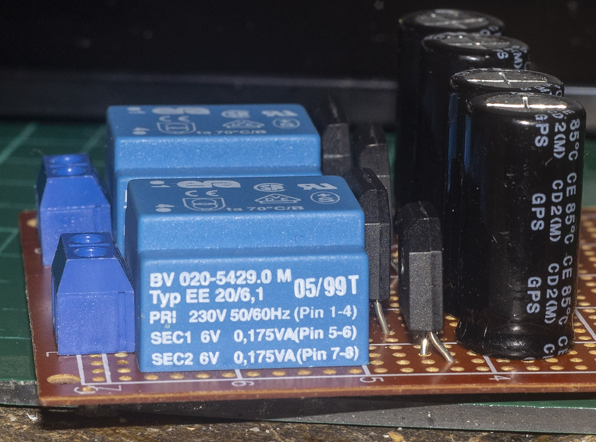

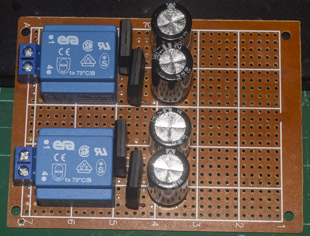

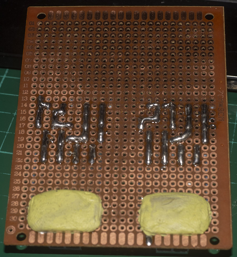

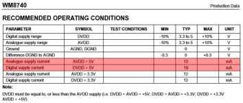

I've built a set of linear supplies for the DAC chips, as small as I could make them, using two encapsulated trafos that each sport a pair of 6v 175mA secondaries giving a total of four 6v 175mA lines on a PCB measuring just 7x9cm (2 5/8 x 3 1/2 inches). I've potted the 250v bit in epoxy putty for safety purposes and used the largest caps I had that would fit - 16v 2200uF as smoothing caps. I haven't fitted any regulators to the board yet, but there is ample room left for them.
So using this board I can provide two 5v regulated lines to each of the two DAC chips.
One thing I might have done better is the rectifiers - I used RBP310 bridges as they take up very little space, but I have read that Schottky diodes have less noise. I suppose I can add a couple of snubber caps to the RBP310s to reduce noise, I honestly don't know how noisier the bridges will be vs a quartet of Schottkys.

Looks nice Ian, just check those trafos give you enough headroom. They won't provide 175ma . 6v and 0.175va is more like 30ma which will then be lowered by approx 40percent once it is rectified.
Someone please correct if I'm wrong.
Nice little psu though. I doubt you will hear s difference with a change to Schottkys. But there are those whom can tell the difference
Oh balls, I misread the label on the trafos, thanks for catching that ****-up.

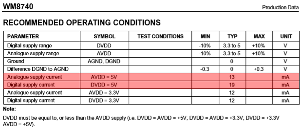

6/0.175=34.28 so my mini trafos are putting out just under 35mA per secondary winding.
Losing 40% of the 35mA to rectification leaves just 20-21mA.
Checking the datasheet for the WM8740, it gives the analogue current consumption as 13mA typical and the digital current consumption at 19mA typical, it doesn't give any max figures for current.
So I might get away with using these trafos, there isn't much headroom.
