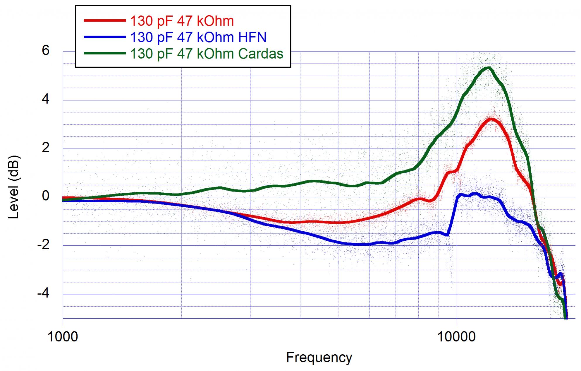

Yes, the accuracy of the sweep affects; but in my hands most of them differ between each other even if I measure amplitude directly. Comparison to some fixed frequencies I can say that some sweeps and wihte/pink noises are better than others. Below is pink noise on three records corrected for slope. Red = Ultimate Analogue test LP, Blue= HFN test LP and Green=Cardas test LP.
So to know, I would say one must measure a lot of records with fixed fr, sweeps, noise and then try to judge from that. Looking at different tests from magazines, one can see very different frequency responses from the same cartridges. Probably they used different records and which one to trust?

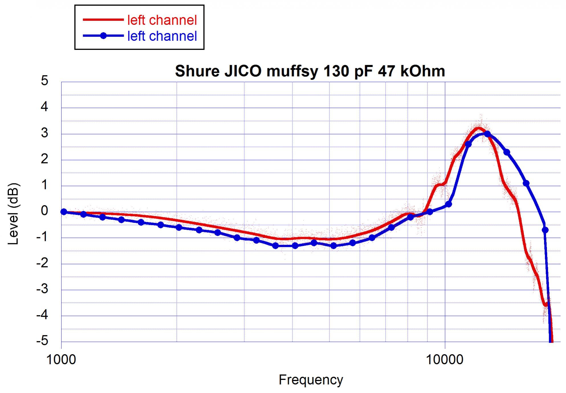

Below is a comparison of pink noise (corrected) with fixed frequencies on the Ultimate Analogue test record. Some differences but are basically agreeing. So a fixed frequencies from trusted records is IMO the best source of reference to evaluate how sweeps and noises perform. My results so far of those I have:
Ultimate Analogue test record: Good fixed f, ok pink noise above 1 kHz
Elipson test record: Good fixed f, good white noise, ok pink noise
Deviations found on these, not acceptable IMO:
Tacet record:
HFN record.
Cardas test record
Ortofon test record

Doesn't the radius of the sweep track come into it? I presume that the various test records have their sweep and noise tracks at different positions on the side.
It would be curious for spots, because there would be many
The more samples available with the same nominal freq the better for f determination. All statistical tools at your hands.
