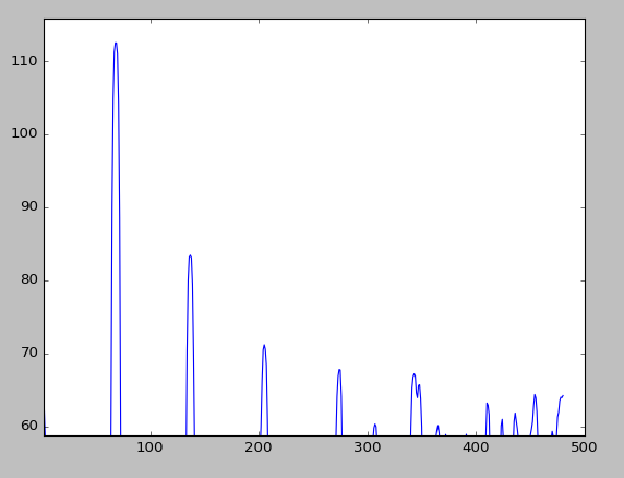

The flat top window maximizes the accuracy of amplitude but gives up a little frequency resolution, here the width is 2-3 bins. The harmonics are still where they should be. This plot is one 10ms slice at around 6800Hz (f/100 on the plot), JP's sweep again. Things get a little tight at the high frequency end, but still looks good here. Work in progress.

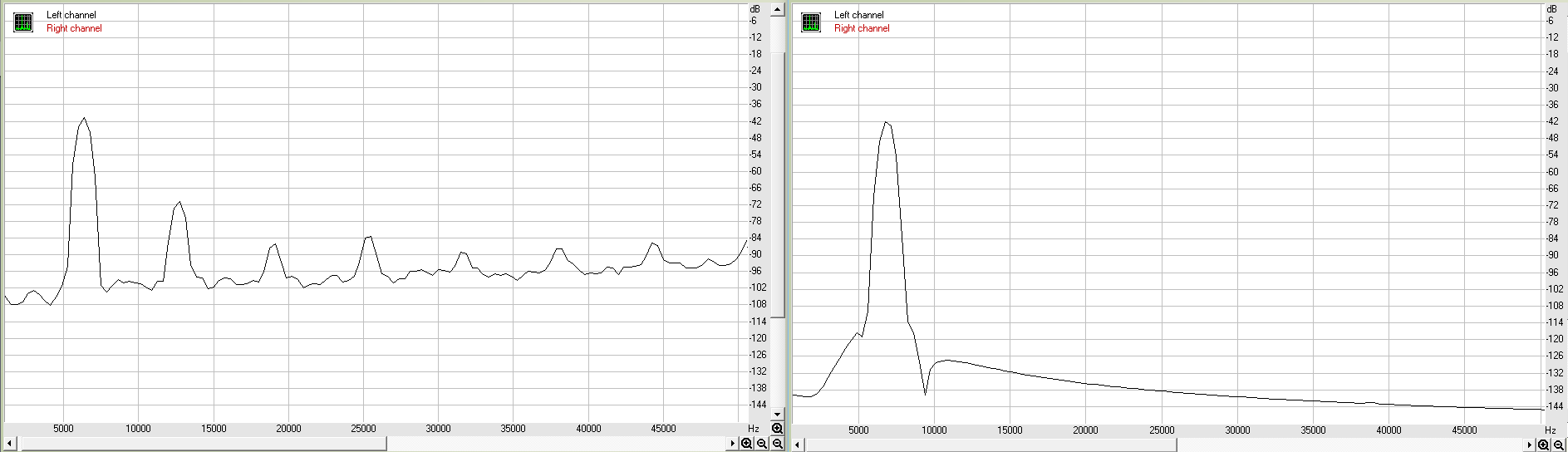

I had an understanding problem to what extend harmonics from a sweep are meaningful, since the signal is never steady but changing in frequency all the time.
Therefore I made a sweep over exactly the same freq. span from 1kHz to 50kHz, over the same time of 28.4 sec with the same 16mV rms as JP's sweep.
From both sweeps I took the same 10msec time slice around 6800Hz as you did.
The first two harmonics from JP's sweep fit perfectly with your image at resp. -30dB and -44dB below the main lobe. Further on there are some differences.
The mathematically generated sweep on the other hand shows no harmonics at all.
So what you are trying to achieve is to really reveal hidden information.
Great idea.
Hans
P.S. Eventually you could also extract the surface noise level from the record as you can see in my images.

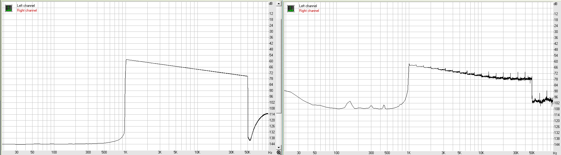

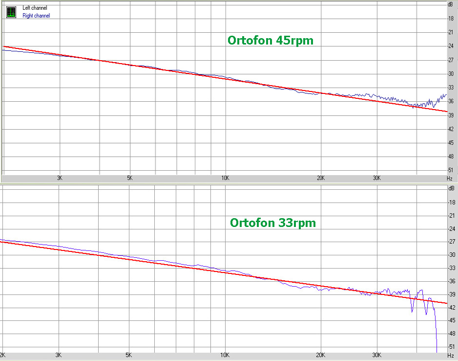

I've played the Ortofon test record at 45rpm, now theoretically going to 67.5kHz.
In the image below, the same channel is shown for 33 1/3 and 45rpm, both going to 50kHz.
The ups and downs near 50kHz in the 33 1/3rpm recording, are now shifted to outside the 50kHz region, that's why I stopped the image at 50kHz, proving to my opinion that those jaggies are to be attributed to the record and not to my cart.
My conclusion is that the CH precision record is very good, but only going to 30kHz and it's not CV recorded.
The Ortofon is CV recorded and of reasonable quality, but I'm not really impressed.
By far the best record seems the one that JP used, CV recorded and flat to 50kHz without anomalies.
Question is whether this record is still avalable ?
Hans

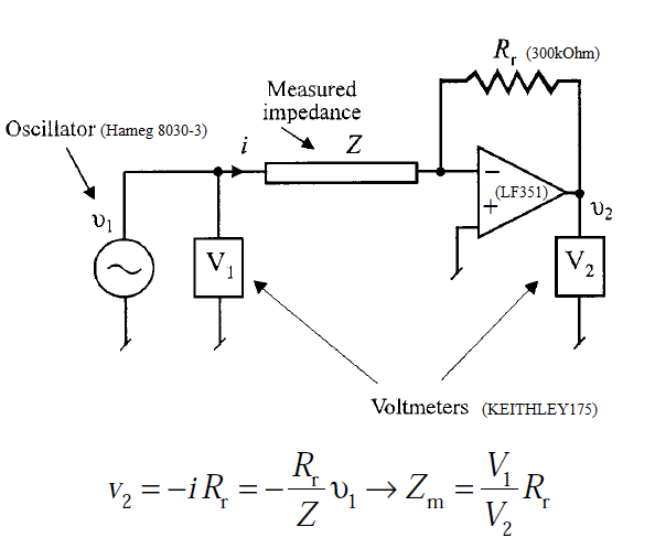

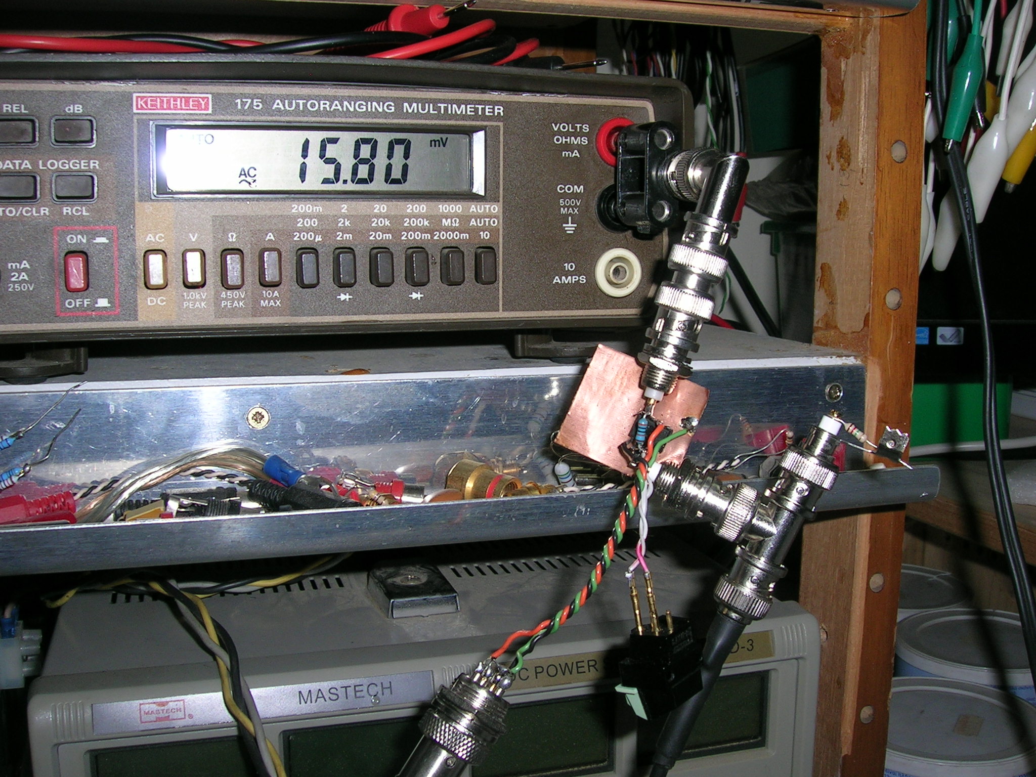

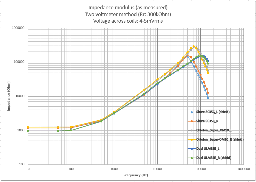

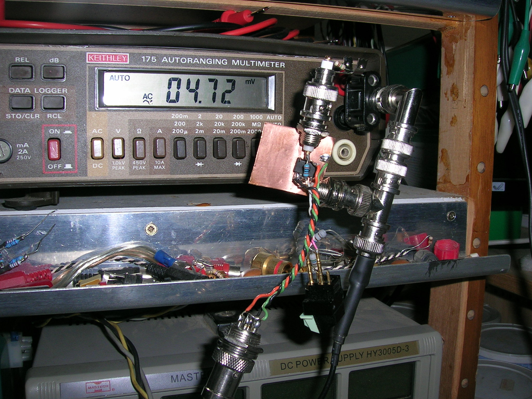

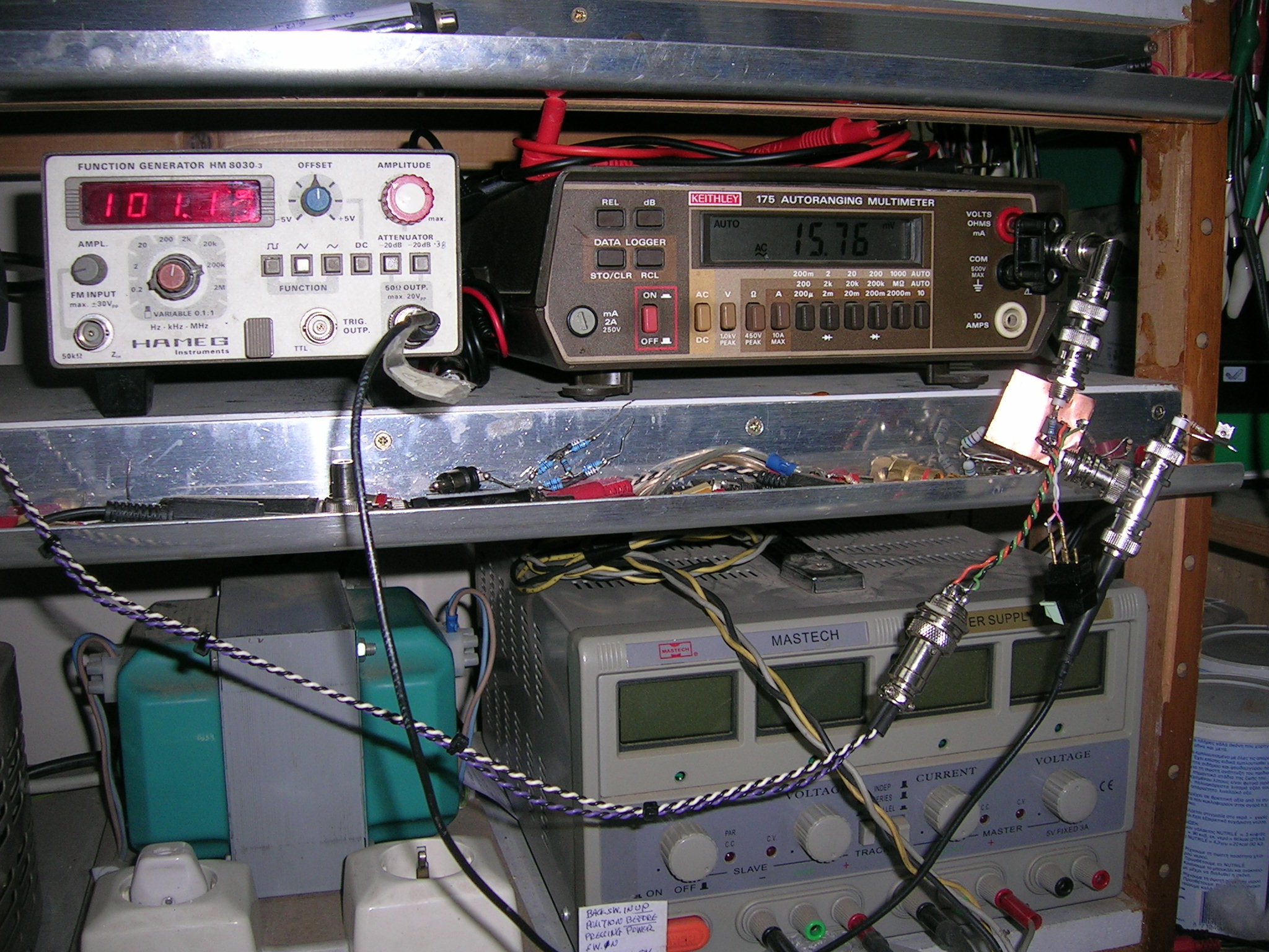

Hi Hans
In a few days I am expecting an EMU-0404 soundcard that Mogens (mkc) kindly has donated to the cause. I hope with this I can provide complex impedance data up to 96kHz.
Meanwhile, I am struggling with a simple diy self balancing bridge to get Z modulus data.
I am manually measuring up to 150kHz (every 10kHz above 10kHz) just to cover the resonance area.
In the weekend I will post results.
Phase data is a problem. Only calculating from Lissajous figures, but this is not that a precise method.
George

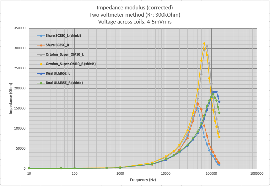

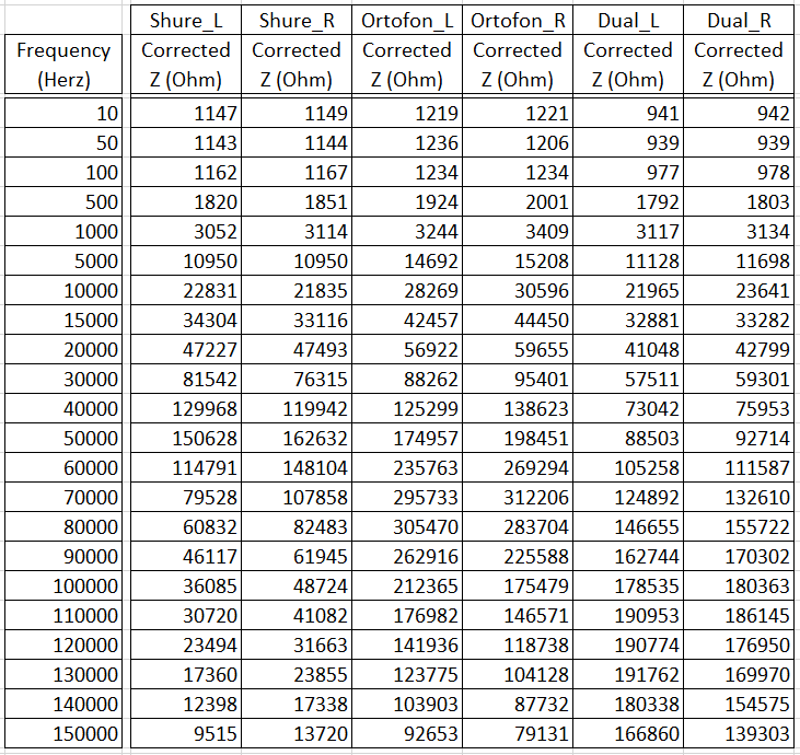

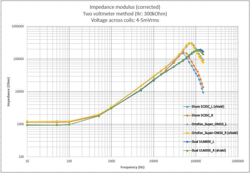

The spot freq "Z modulus" manual measurements for the three cartridges of Bill
George
George
George,The spot freq "Z modulus" manual measurements for the three cartridges of Bill
George
Great job, thank you.
Unfortunately because I need to be able to the extract the complex value of the |Z| you measured, I can't use this info.
Hans
