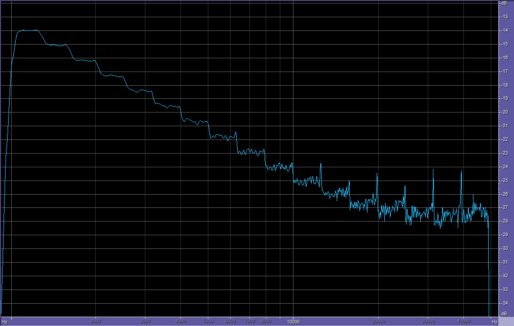

But since FFT bins do collect energy, the energy for a signal with constant amplitude collected in 1/10 of the time is 10*log(1/10)=10dB/decade.
Hans there was never a disagreement, this requires a log sweep (there is no way to know if it is not). The software should be able to correct the slope to avoid the parallax of tilted axes. The overlap and add FFT also has poor rejection of LP eccentricity which varies with FFT length.
It's easy to demonstrate the artifact from LP eccentricity. When you have an off center LP the frequency of a recorded tone will have a minimum and maximum when the eccentricity is tangent to the tone arm. This FM will add to the linear FM of a slow sweep giving a staircase error when you use all the information in the FFT such as the usual overlap and add function in many audio packages.

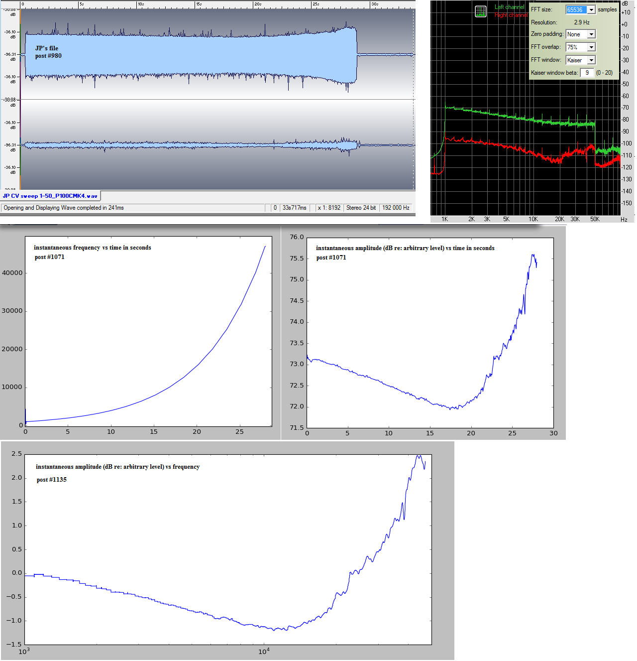

Yes, there are two ways of smoothing uncertainty, simple filtering of noise and fitting the data to a low order polynomial. I don't think we need any rocket science here to get what we need. Frankly I would be happy with the last plot of JP's sweep.
Ah yes.
Everyone would have been happy to manage such a plot (if you mean the one in post #1126)

No #1135 that's real data.

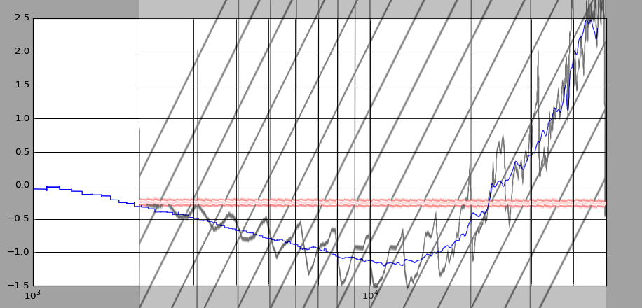

I'm glad we could finally agree on the 10dB/dec FR slope for an exponential sweep.Yes, first try on JP's fairly clean sweep file. I used small (960 point for 96k sampling) FFT's so everything slices up nice and even. The flat top window was a must, all other windows have scallop loss which showed up as noise without fiddling with an overlap strategy. Plot is dB vs frequency, I need to fancy up the titles and axes.
@JP I can PM you the code, I had to "steal" the flat top window from Matlab.
With all respect, the image you showed, level/frequency is very nice, nothing negative about that, but it needs your software to perform and cannot be used in general.

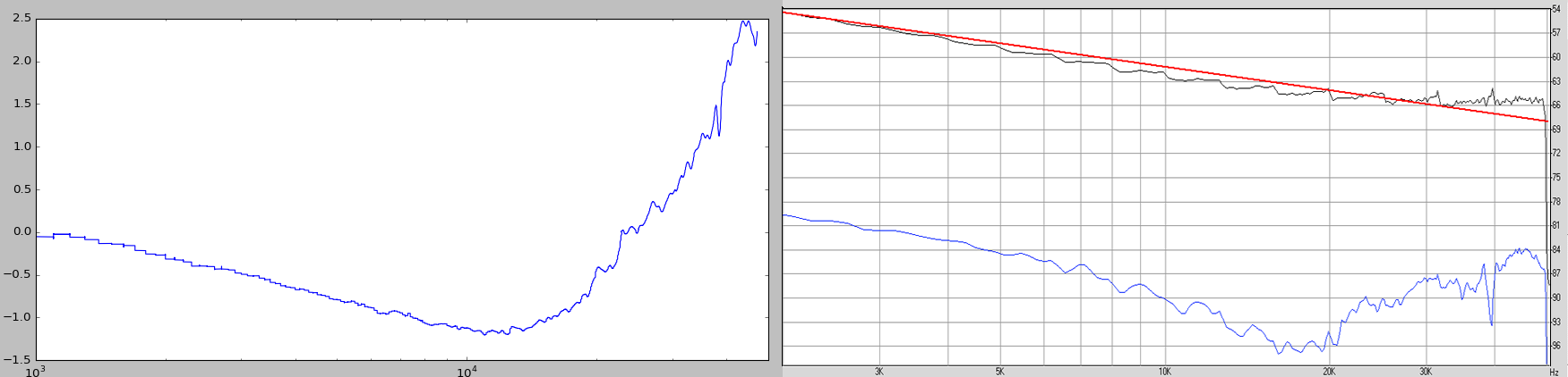

My question in all honesty is, how much more information does your image give compared to the outcome of a general available overlapping FFT program like RMA, that everybody can use, in this case using a 1024Pt FFT.
Comparing deviation of the FR to the red 10dB/dec line to your image, I think results are very close, possibly saving you the time to make images for everybodies recording.
Hans
Hans, could you remove the slope and re-plot on the same scale? My entire plot fits in less than two divisions of the FFT plot and still has very little noise uncertainty. We are looking for things like subtle arm cart resonances, etc. there simply is too much noise and too many artifacts on the FFT plot.
Anyone using Linux or an RPI could run this with no intervention, Windows requires an install of a good Python package, Anaconda is essentially one click after a download and contains all the signal processing packages needed. We did this for the TT speed stability test in the TT thread, something no packages can do.
Another point if you are going to assume an exact log sweep you can simply take small time slices of the time domain response (time now correlates to frequency by assumption) and plot the log of the rms voltage in the slice vs time, no FFT's or processing needed at all. Of course REW etc. don't have a menu choice for that.

Below the image from RMAA projected on your image. It's not possible to export data from RMAA, so I had to do a Photoshop job, but the difference is obvious.
Trend is of course identical, but your image is much smoother.
Question is, to what accuracy do we need this information or can we do with less smoothness?
But again, compliments for the result.
