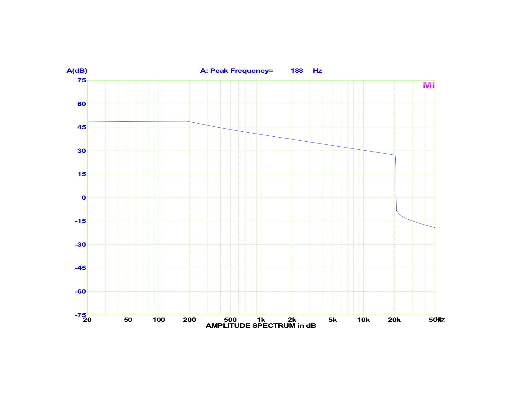

Yes perfectly flat, Hans you are adding a layer of energy per octave processing that is unnecessary and adds confusion. I know RTA's before digital were all fractional octave based but we do not need this anymore.

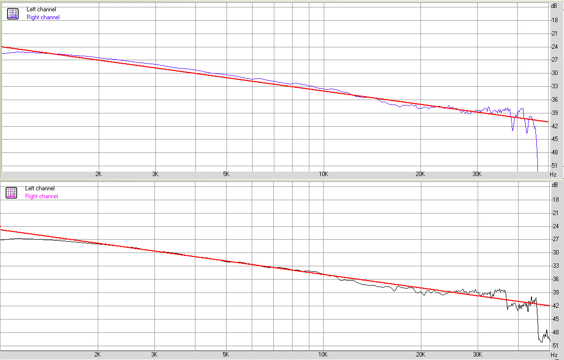

Switching the sound card to 192Khz did not bring anything new.
I now show the FR of both channels against the 10dB/dec ideal line.
Again, deviation is not that large, but not as smooth as the Adjust+ and the CH Precision record.

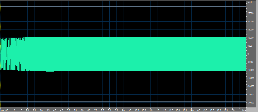

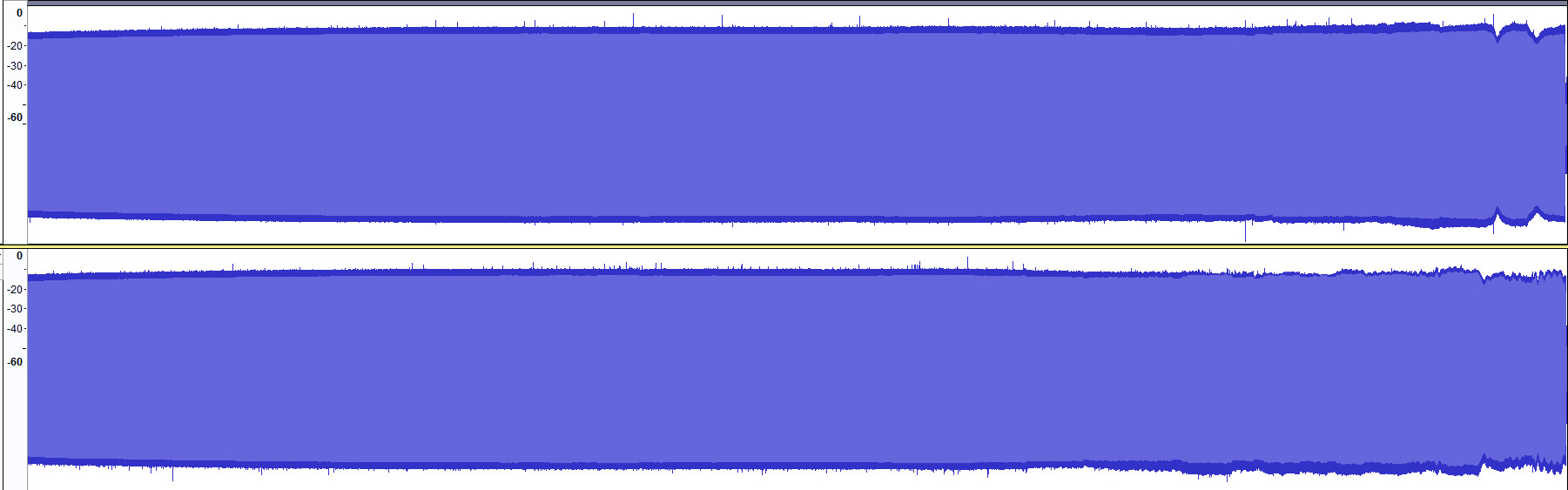

I have also added the time recordings, in case anybody is interested to see them.
You may notice a small gain difference between both channels of 1dB. That's because termination on one channel was 4k and on the other one 1k.
I played a bit with different values, but saw no differences, except in gain.

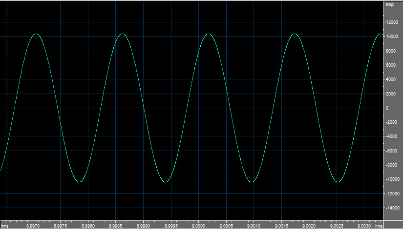

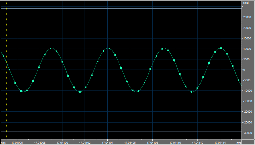

@Hans I hope we can resolve this politely so we can all move forward. Below is your raw data file at ~9sec and near the end (~18sec). The magnitude of both are ~10,300 codes at 16bits. The magnitude is the same, what are you calling the magnitude?

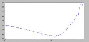

Yes, first try on JP's fairly clean sweep file. I used small (960 point for 96k sampling) FFT's so everything slices up nice and even. The flat top window was a must, all other windows have scallop loss which showed up as noise without fiddling with an overlap strategy. Plot is dB vs frequency, I need to fancy up the titles and axes.
@JP I can PM you the code, I had to "steal" the flat top window from Matlab.

Yes, first try on JP's fairly clean sweep file. I used small (960 point for 96k sampling) FFT's so everything slices up nice and even. The flat top window was a must, all other windows have scallop loss which showed up as noise without fiddling with an overlap strategy. Plot is dB vs frequency, I need to fancy up the titles and axes..
Thx - think this works and has obvious potential. Nice.

Apart from the mathematical generated exponential slope, and the images showing the Ortofon sweep, all having 10dB/dec spectra, I re-show the spectrum of JP's recorded sweep as I did earlier which of course also has 10dB/dec.
No intervention of Audacity or anything else like mysterious added layers of energy, just an FFT taken directly from the .wav file.

Hans it's right there in your time domain plots again (#1133) the amplitude of the sine wave is the same (close) across the entire sweep, this is the magnitude of the waveform. The amplitude at 1kHz is not 3x the amplitude (of the time domain waveform) at 10kHz, is that not obvious????
