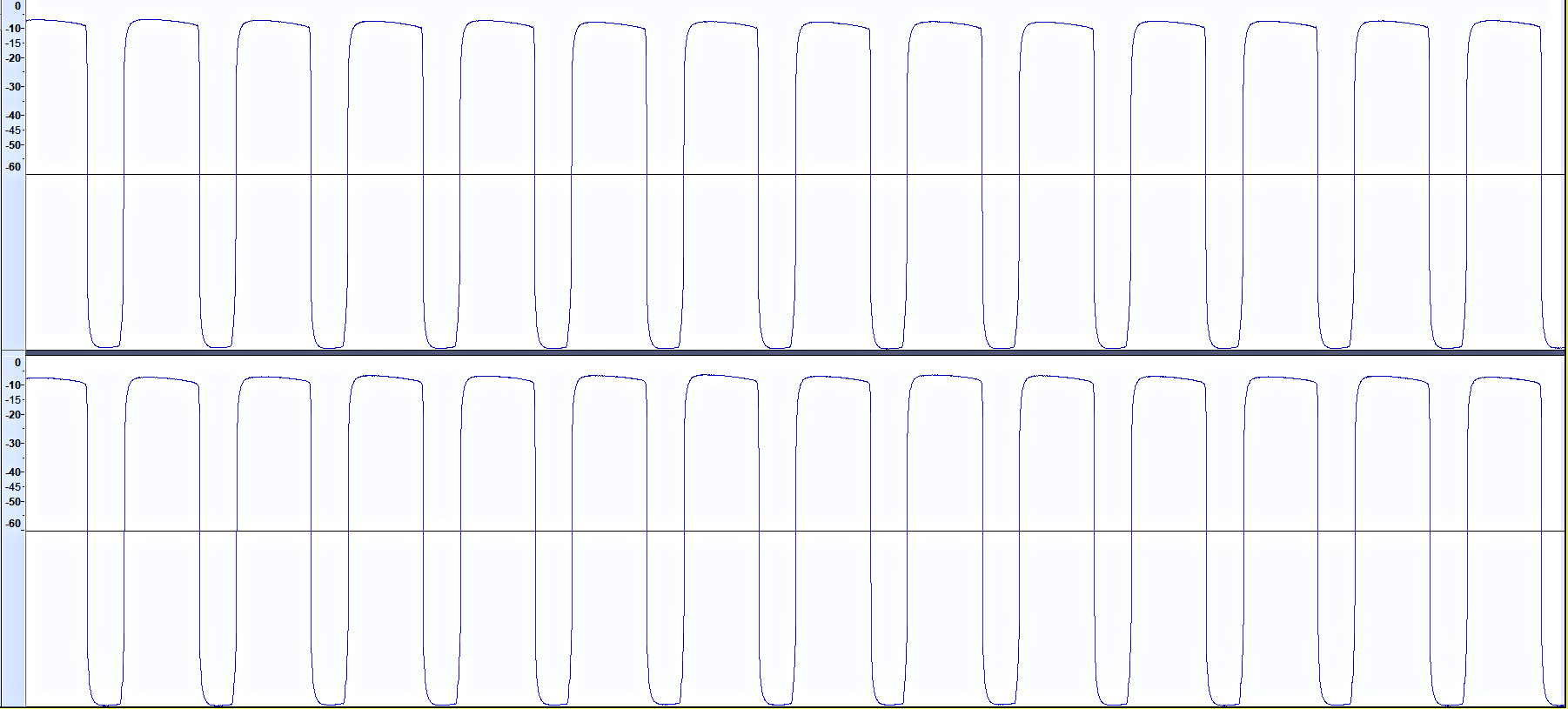

Fresh from the needle the first unfiltered test from the Ortofon record, a square wave.
Looks very nice and clean.
Still working on a 60dB flat amp for the CV sweep.

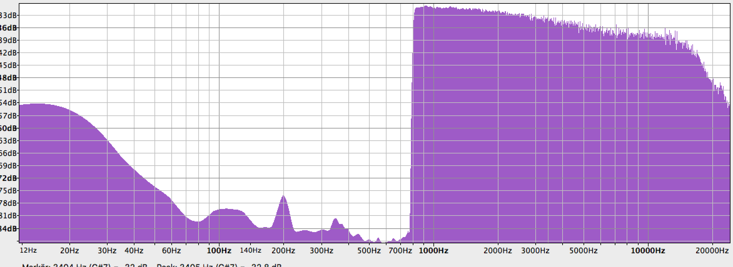

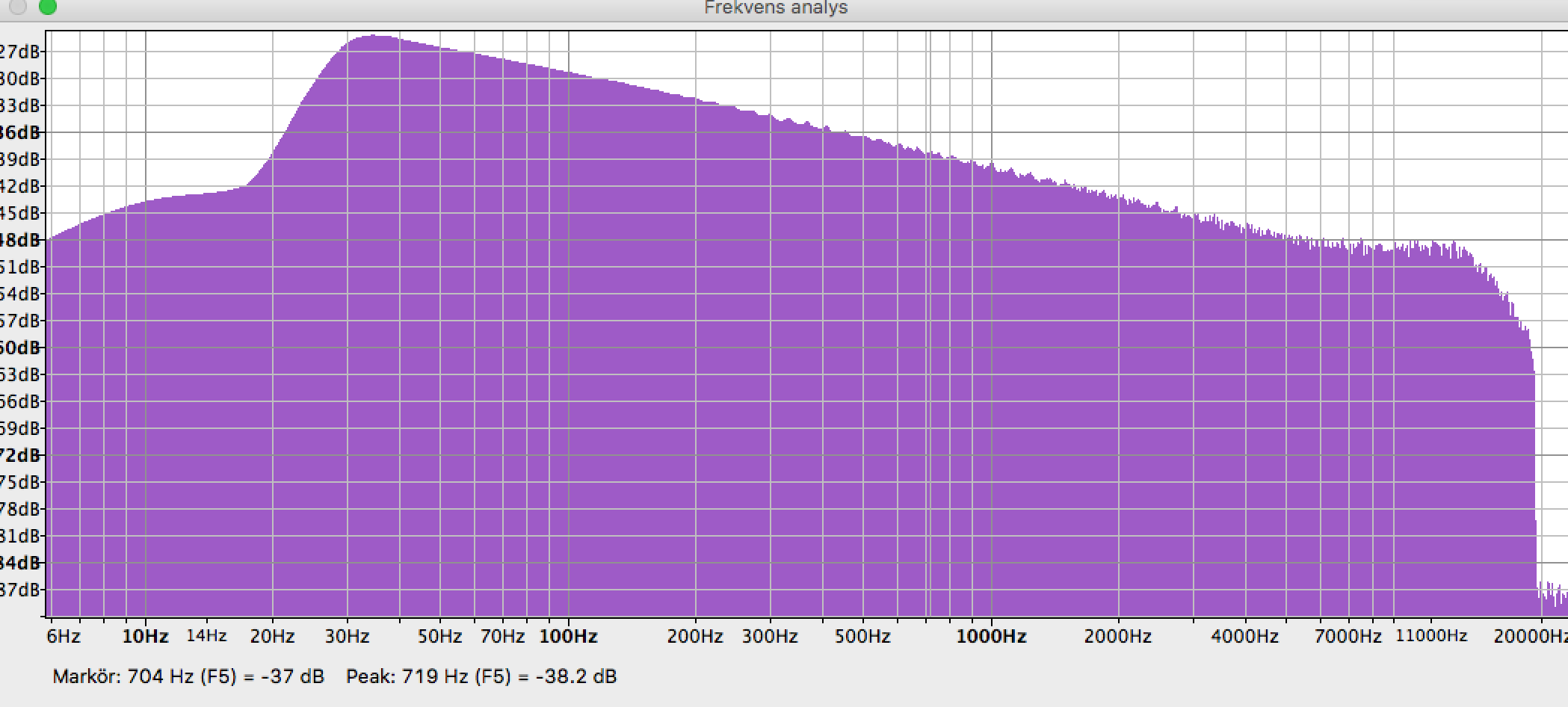

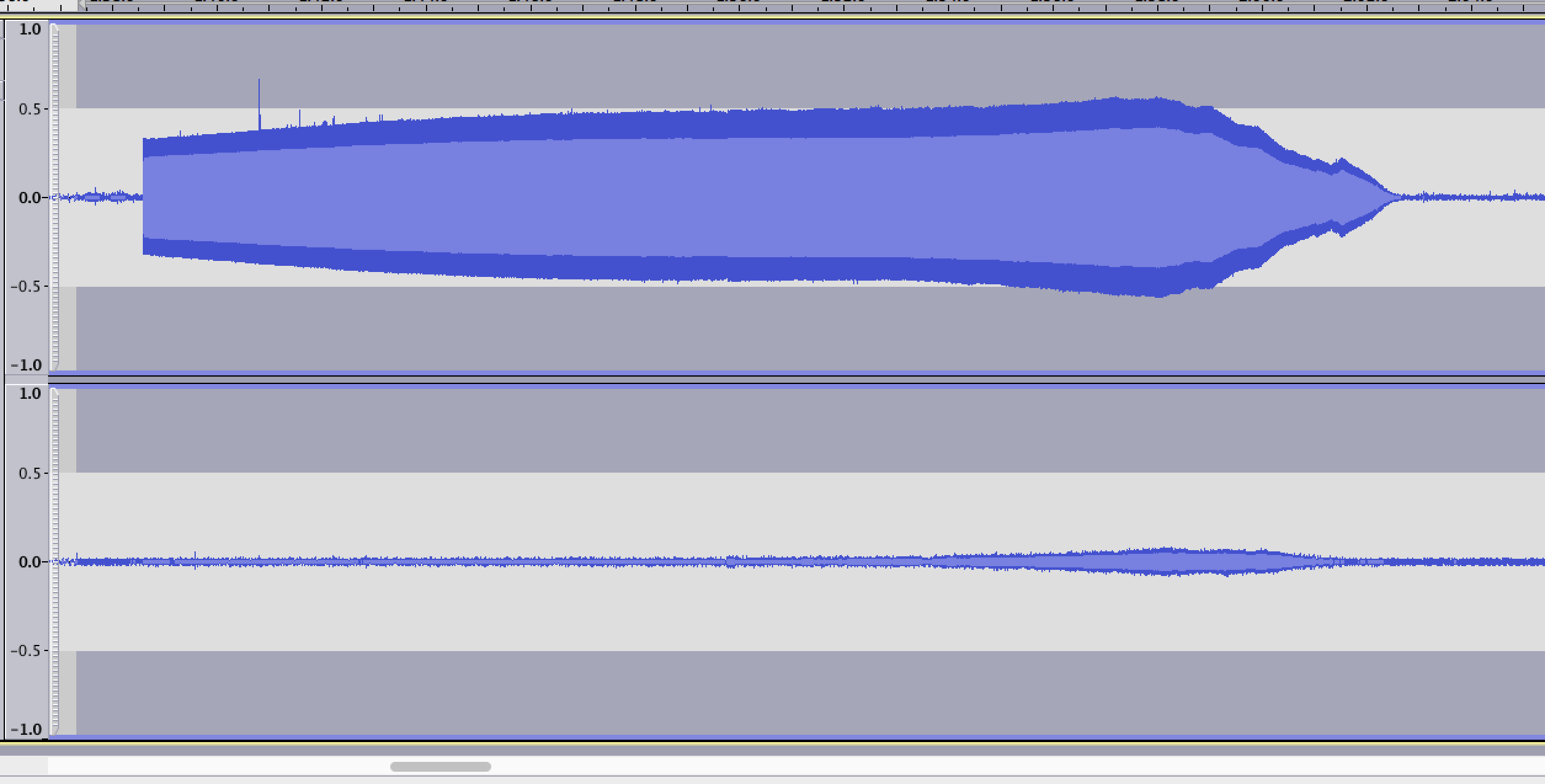

If I compare an FFT of the 30 Hz to 18 kHz sweep on the Elipson, I can see that the slope is 3 dB/octave up to 10 kHz, then the peaking of the resonant stylus shows up. With the Ortofon, I made an electronic compensation for the RIAA and I can see that the response is not at all the same. It has a rising response from 800 Hz to 2-3 kHz.
If I get time I can make the conversion to linear to compare them side by side.

Hi Thomas,
With the Ortofon you have to play through a straight, non Riaa preamp.
Hans
