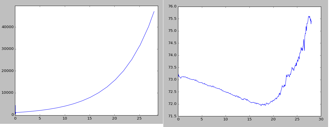

This is JP's sweep presented as instantaneous frequency and amplitude (dB re: arbitrary level) vs time in seconds. This must be the Lenco since the frequency wiggle is very low.
@JP The problem I am have is converting this to amplitude vs. frequency automatically. It is the same code I used for the TT speed plots with filtering set at 10Hz to help remove the tick and pop noise. Another issue is the same one I had before the Hilbert transform (like all transforms) is circular so there is a big jump at the end points due to the sudden frequency change.
I tried binning in 1Hz bins and averaging the amplitude of each point that is within +-0.5Hz but the number of points in each bin varies a lot so I have to keep track of the number and divide at the end. This is a little clumsy so I don't have much to show yet because some sweeps still need hand removal of major glitches.

A few suggestions/comments on these very nice images:This is JP's sweep presented as instantaneous frequency and amplitude (dB re: arbitrary level) vs time in seconds. This must be the Lenco since the frequency wiggle is very low.
@Hans I hope you will stay with us, I don't understand you can take any tool like Cooledit or Audition and sample a small slice of a sweep and get the average frequency and rms amplitude to test the results. I just did they are exactly the same.
1) it might give some extra info when the Y axis for the frequency is logarithmic, this should then result in a straight line
2) it would also be nice to have both curves in one image with two left/right Y axes for level and frequency
3) I have little doubt in JP's super performing cartridge, but the shown level line is what his Cart has produced and not necessarily what's on the record.
A record that is analysed this way should be level validated in some way, preferably by comparing several Carts in the same high bandwidth category.
If not, someone might think with this image that his cart has a dip at ca. 12kHz and a peak at 50khz, which might either be true or not at all.

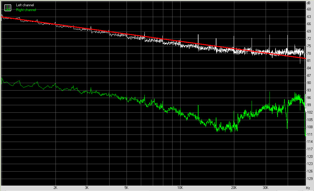

As a matter of fact, level and frequency vs time in Scott's image, taken from JP's Denon sweep, do correspond impressively well with the deviation from the red line in the FFT spectrum.
So before jumping to conclusions about FR you have to know the whole story.

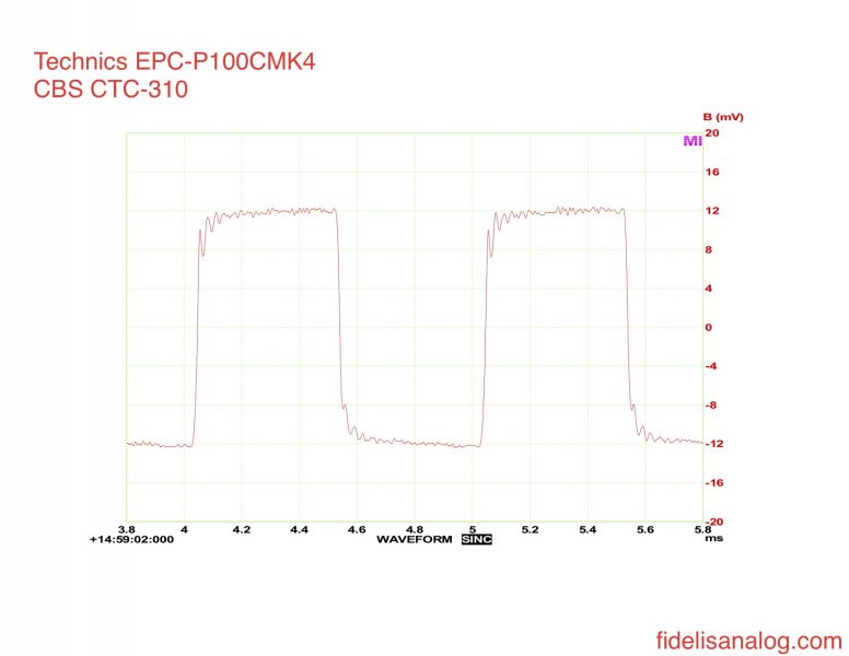

The EPC-P100CMK4 (hope I have that right) is the absolute zenith of the low mass era of MM just before CD came out. 0.055mg effective tip mass with a boron tube cantilever. It also had a trick suspension that was less affected by temperature than Butyl rubber, which became its weak point. A lot of them suffered rubber rot apparently. Truly SOTA when they came out and arguably have not been bettered since.
Yep. P100CMK4 T4P version or 100CMK4 SME.

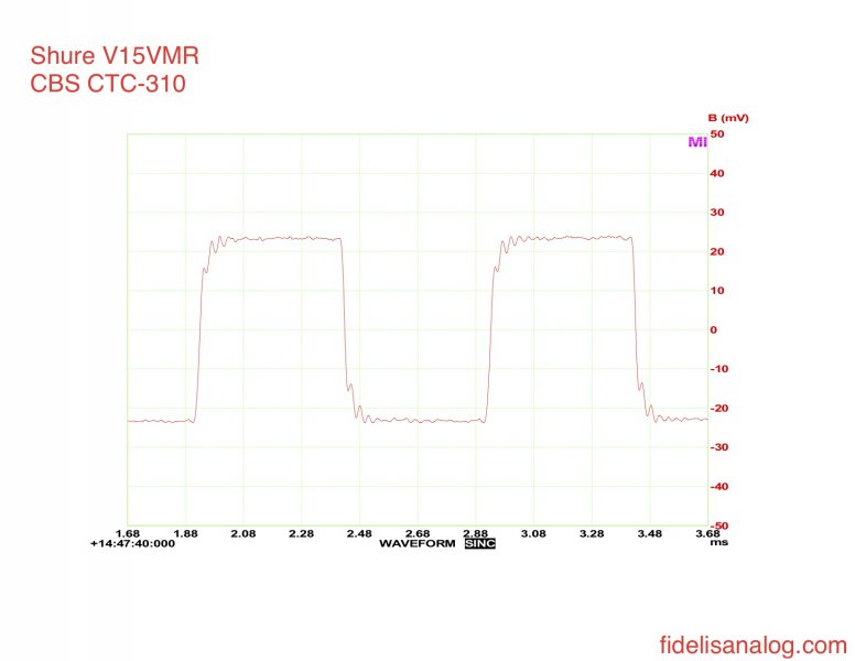

Looks good, IIRC the mid-range droop causes a tilt of the top of the square wave response which shows up for my cart. It should be possible to reconstruct a minimum phase square wave response from the data and compare it to the actual square wave response.
Is that square wave also no RIAA?
Correct no RIAA. This is a Shure V15V/VN5MR.
