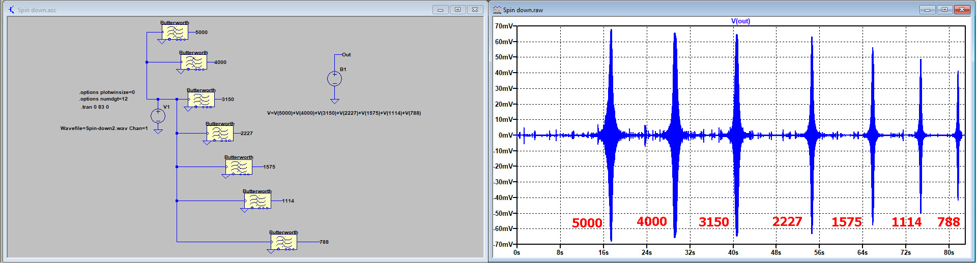

Then please send me your .wav file or be so kind to analyse my .wav file, thereby making it possible to comparing results.No it's not the Hilbert transform yields the instantaneous frequency and amplitude directly, (here 30sec as a 1,323,000 point transform) there are no errors in my measurement. This is the same technique I used to reproduce Lucky's turntable speed circular plot. After some work we got the two to almost lineup perfectly.
I think that if I interpose an RCA to XLR connector on my sound card I can fool it into using the mic pre-amp so now I can easily repeat measurements.
One of both must be wrong because having different velocity errors is conflicting with identical PN curves.
I have shown below what I did.
In LT Spice I made 7 bandpass filters that are fed with the recorded .wav file.
They show me at what moment in time the relevant frequency occurs.
Armed with this time info, I look in the Original .Wav file and measure it's corresponding rms value with LT Spice.
Measuring in the original file at the right spot is probably the most direct way that's possible, no transforms, no calculations, no nothing that can corrupt the results.
Hans

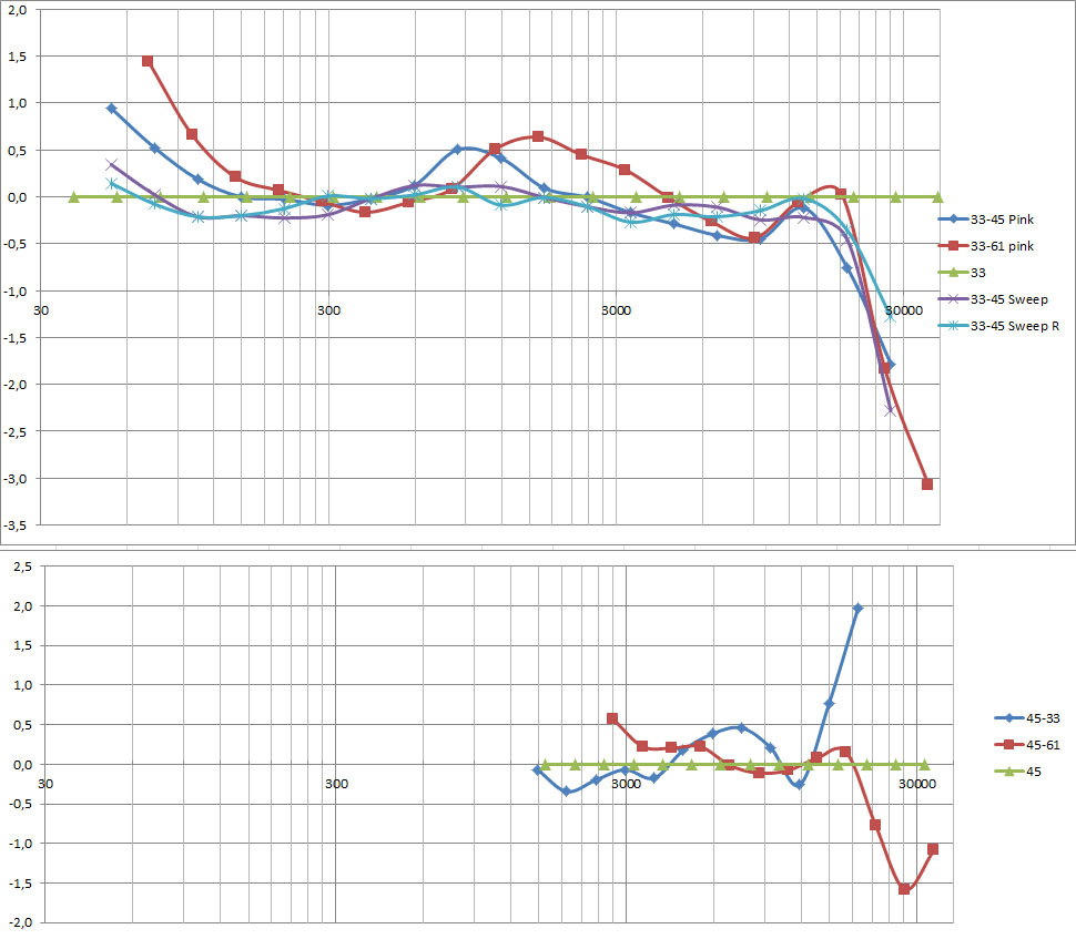

LD,To extend the f range one has to play at higher speeds.
LD
Forgive me to rock the boat every now and then, but that can hopefully lead to seeing things from different perspectives and to new insights.
Higher speeds will extend the f range, but it seems not to be that simple to my opinion.
A few postings before in a posting to Bill I referred to a Philips research article, concluding that from a certain frequency and upwards, interaction starts between tip mass and record material.
This makes that while playing an ideal recorded LP, deviations will occur from the expected frequency transfer.
Only a Cart without tip mass and infinite compliance will be able to mechanically follow the track perfectly without such interaction.
To my opinion, that's what could be seen in the measurements I recently made, showing the deviation from the FR at the intended speed versus the altered speed.
In all cases, for PN as well as Sweep and on different records, the deviation curves are showing a signal getting weaker when speeding up from somewhere above 15kHz with a slope of ca 3dB/oct.
When slowing down the exact opposite happens, with the same slope but now in the upwards direction.
Since this is not random but very systematically, and all with roughly the same slope, there must be some physical reason for this, and this could be very well be said interaction between tip mass and record material.
So I'm afraid that when speeding up LP's in general, reference LP's or not, their transfer curve will undergo the same transition.
What's your vision ?
Hans

Well, at CV acceleration increases with f. So at some limit, either stylus will lose contact with one of the groove walls (mistracing) or something will flex. Whether what flexes is the cantilever or the vinyl surface is very debatable, but IMO it's prob the cantilever.A few postings before in a posting to Bill I referred to a Philips research article, concluding that from a certain frequency and upwards, interaction starts between tip mass and record material.
At increased rpm, CV increases (level) and so does acceleration and this changes f at which the onset of this phenomenum occurs. But it is simply a function of level, there's nothing exotic about the vinyl surface-stylus interaction.
'Tip mass' is a fairly horrible way of expressing mechanical impedance, based on the half-true premise that above a certain f impedance is mostly due to mass. But its derivation doesn't stand scrutiny - usually based on observation of the top mech resonance (which is notably absent from our recent observations), and assumption of a vinyl spring constant.
I would say that tracking high acceleration has little to do with the stylus-vinyl interface, beyond the friction coefficient. This in turn has little do with rpm, as I have demonstrated to my own satisfaction, is supported by the Pardee paper, and classical physics supports.
So whatever deviation you have found probably has no basis in the stylus-groove interface and is more likely to be a simple artefact of altered level at different rpm.

When deviation starting near 20kHz is to be accredited to an altered level at higher rpm, this hot Decca record thereby even going to boiling hot, will then most likely also deviate from the current 10dB/dec at higher rpm.
I'm with you that a FR doesn't have to be a straight line, but when it's not at higher rpm, this curve has to be validated and documented. Who is beyond suspicion to do that ?
So my question again, do you see any possible way how to validate the Denon record, other than playing it with different high bandwidth carts and comparing results.
That record would make life quit a bit easier so it seems.
Hans

Well no, as discussed, level alters too, and more likely to simply be that.When deviation starting near 20kHz is to be accredited to an altered level at higher rpm,
Well there is: (a) Scott's varispeed playback of a sine monotone, simultaneously measuring 'instantaneous' level and frequency using the detector software we conveniently now have. This seems a very good prospect. (b) If the record is based on monotones it can be validated optically, and AFAIK this was the method professionally used back in the day.So my question again, do you see any possible way how to validate the Denon record, other than playing it with different high bandwidth carts and comparing results.
Both are better than statistically combining results from various cartridges and assuming that to be 'absolute', IMO.
