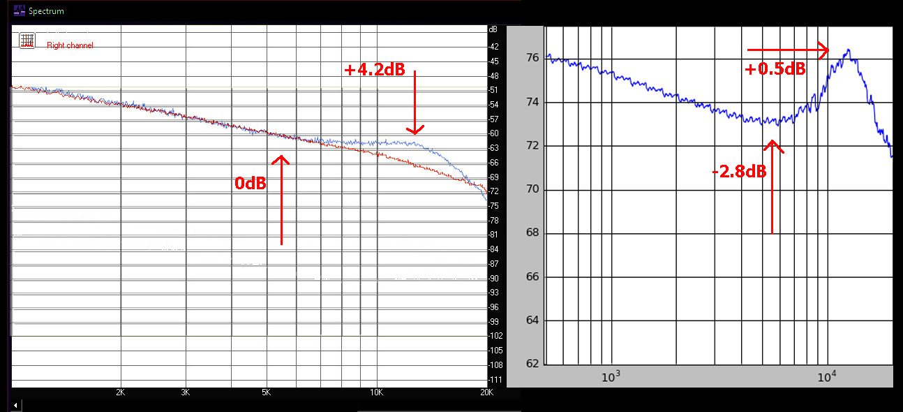

I don't understand, the plot I posted was 76dB at 500Hz and 76dB at 12kHz and 73dB at 5kHz +-1.5dB.
A bit more accurate then my previous said -3dB +5dB, see image below with your plots:
The CV plot was -2,8dB@5.5kHz and +0.5dB@12.5kHz.
The Adjust+ plot was 0dB@5.5kHz and 4.2dB@12.5kHz.
Difference bewtween the two recordings is thus: -2.8dB@5.5kHz and +3.7dB@12.5kHz.
Hans

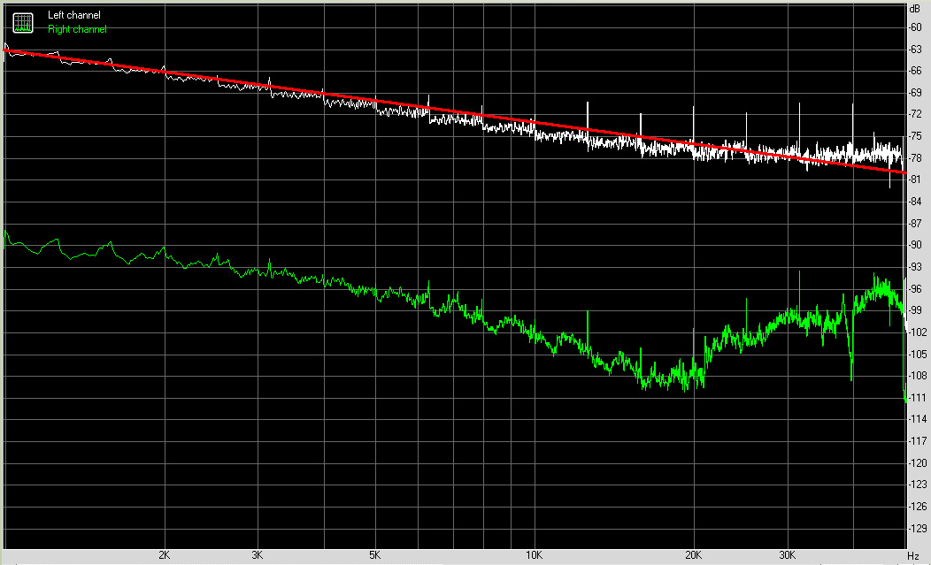

If of interest, here's a 1-50kHz CV glide from a P100CMK4: Dropbox - 1-50_P100CMK4.wav
Denon XG-7002 test record.
Here is the spectrum of your recording, it's ca. +/-1.5dB from 1kHz to 50khz, very nice.
The Red line in the plot shows the 10dB/dec roll down of a logarithmic sweep.
A CV played through a Riaa Preamp should have shown the Riaa curve, true ?
Your recording is 33sec or 18 revolutions.
These 18 occurrences are visible in your recording because of eccentricity or warp.
Hans
What if you ran the CV plot on the same LP and got the same slope as me but no peaking, looks like the difference would be ~ 4.2dB coincidence? In other words we still have apples and oranges, if the CV plot is correct my cart can't possibly get the right slope on a PN track and yours by coincidence matches exactly?
BTW my plots are corrected for deviation from truly log sweep, just to eliminate another confounder.
That's precisely the point I tried to address a few postings before, regarding the strange discrepancy between the two curves.
Cartridge dynamic behaviour
I may be totally wrong, but I thought a CV recording played through a flat preamp should give a flat FR, that was exactly what I asked you in that posting, but no answer.
A logarithmic sweep goes down by 3dB/oct .
So now it seems that it is this log sweep that you have used and the two worlds do come precisely together and match perfectly within 0.1dB to +4.2dB@12.5kHz.
Problem with the discrepancy is completely solved and at the same time we have a nice prove how well the Adjust+ PN corresponds to your CBS record !
No apples and oranges, just apples and apples so it seems to me.
Could you please elaborate what this means. What exact correction are we talking about ? I thought we had solved the discrepancy problem, but now a new ingredient is added.
Hans
