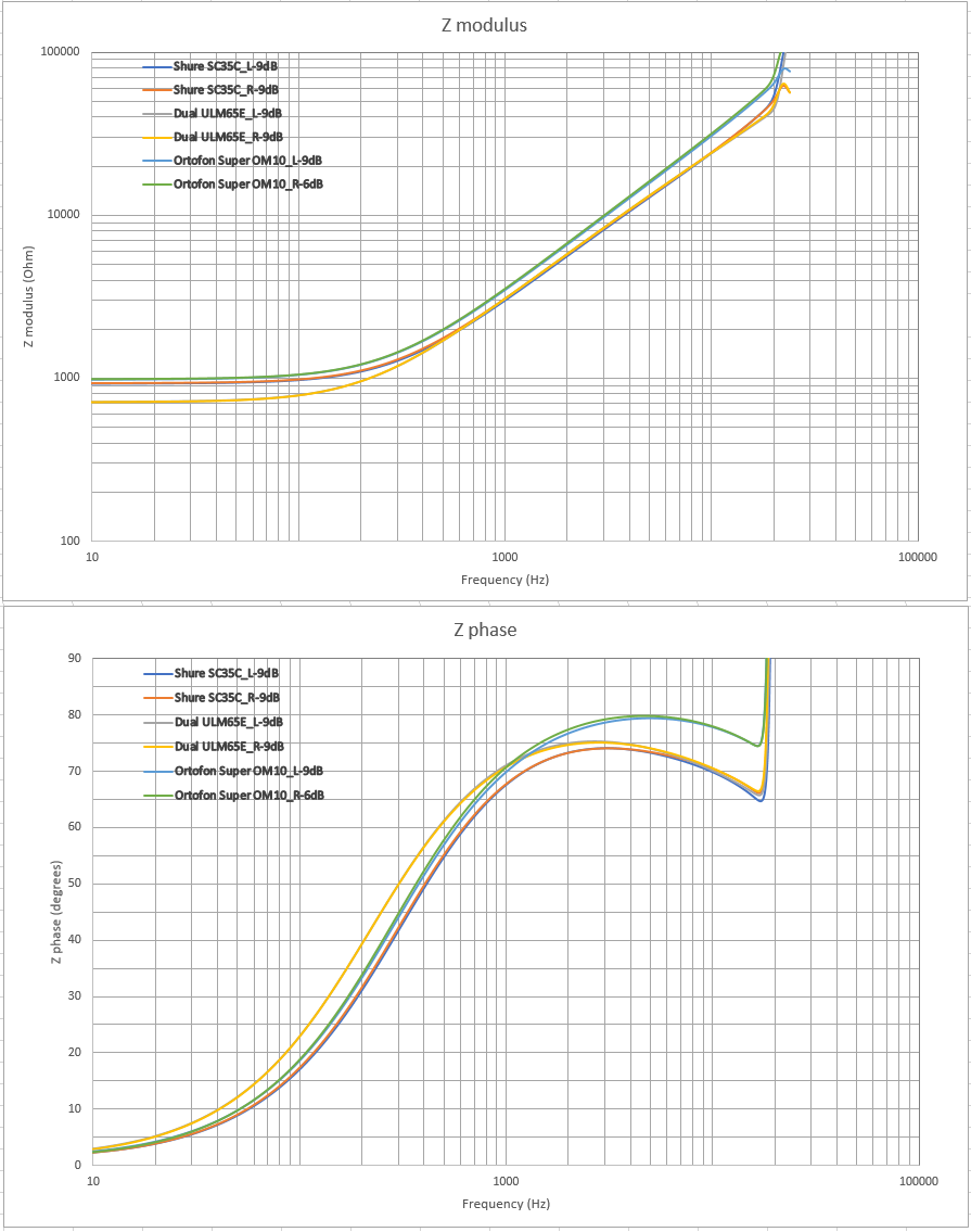

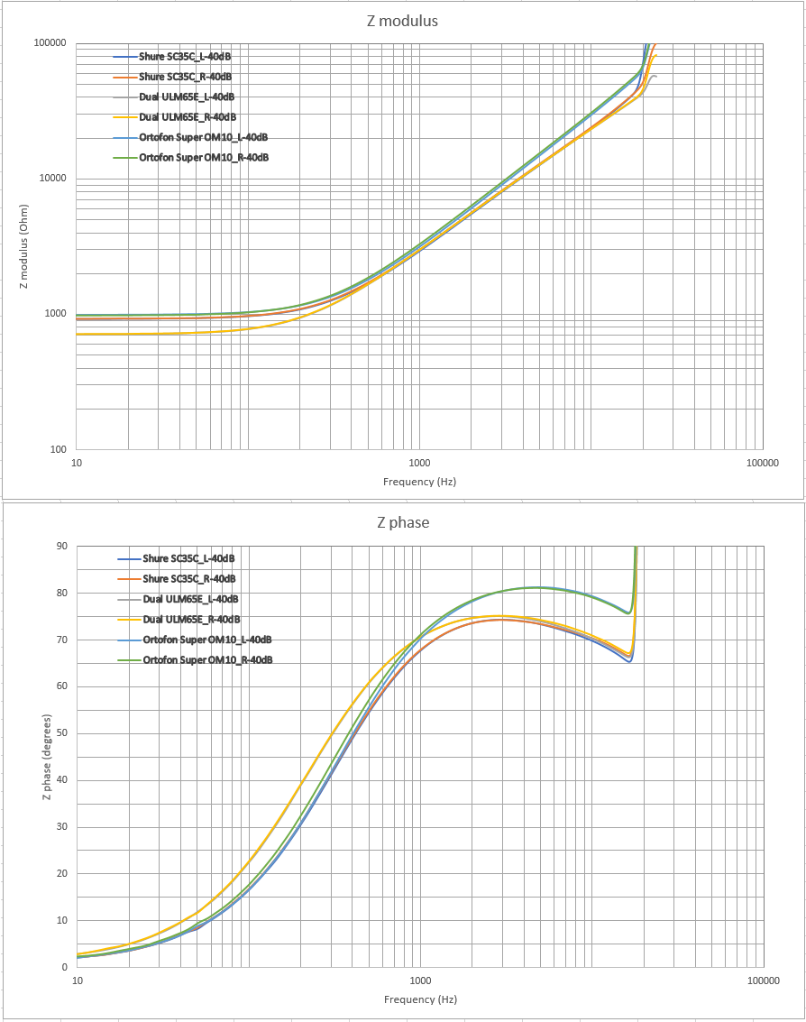

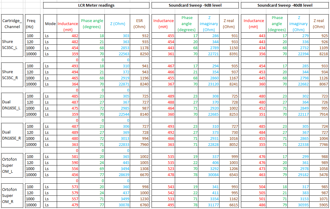

Impedance sweep measurements of the three cartridges.
-9dB=456mVrms across the DUT
-40dB=12.9mVrms across the DUT.
There is good agreement btn results of the sweeps and the LCR meter readings.

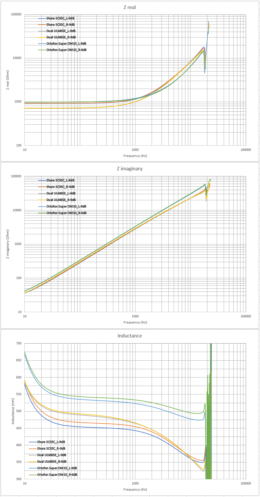

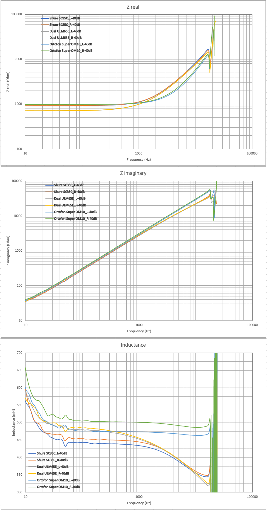

George,
What a fantastic job you did.
I know how much time it takes to get everything properly organized in images and tables.
My question to you is, what in your measuring chain sets the limit in frequency.
The reason I ask is because when trying to construct a model for a Cart, it becomes obvious that the dip in the inductance and hence in the FR around 15kHz is greatly affected by properties in the region from 20kHz to 100kHz.
So would it be possible to get some more data in that area?

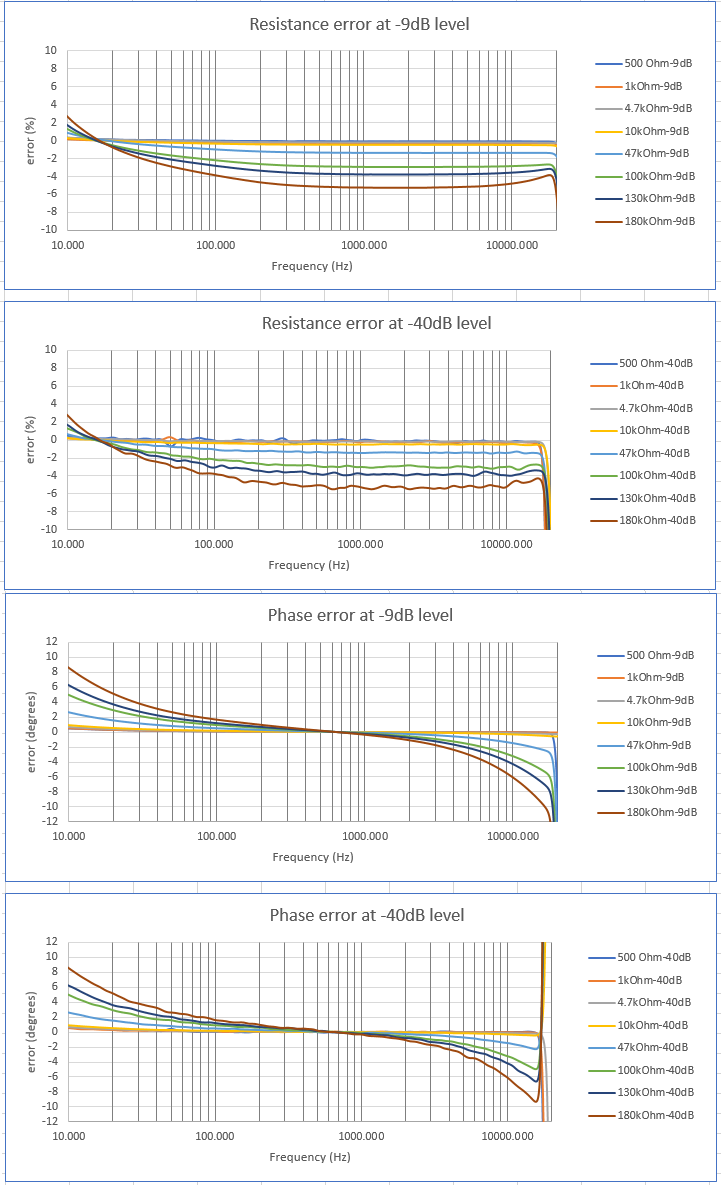

Thank you Hans.
The bottleneck is my soundcard, an aged M-Audio Audiophile USB.
In duplex mode it works only up to 48kHz sample rate.
Thus, theoretical test limit is 24kHz. With weak signals practical limit is around 18kHz, the weaker the signal the lower the frequency limitation.
For the high frequencies I have to revert to manual spot frequency testing. Bench signal generator as a source, monitor the two outputs of the test jig with oscilloscope, log measurements, practice Excel and post (work for next week).
As you understand Bill, what worries you it doesn’t have to do with the cartridges. It is measurement limitation. It does it with the calibration resistors too

It ought not to happen with real resistors R + 0j.As you understand Bill, what worries you it doesn’t have to do with the cartridges. It is measurement limitation. It does it with the calibration resistors too
It think Bill's point is that using phase to determine the 'real' part of impedance doesn't describe reality very well. Self-resonance of the coil, as an LC system, will show phase deviation from pure inductance versus f ie becomes more real toward resonance. But that is not due to 'real' resistance, in the sense it is not lossy and cannot dissipate energy.
I think that could be what is measured here, and showing up as 'reduced inductance'. The crux issue is whether inductance in the sense of 'ability to induct' has been affected, because that is the generator element function. I think it probably isn't affected in these tests: all that happens is energy is passed between self C and self L, and the phase/amplitude response of the LCR system overall is the product of that.
What one needs to do is isolate the 'real' resistance of the coil, probably as a power transfer function somehow ?

Thanks George, thought it might be something like that. I clearly need to build my own rig as well to experiment. I need to go away and look some more at the numbers you have to see what can be picked out. Thank you for doing these.
What can only be measured / calculated this way is the reactance, and only by building a model replicating Re, Im and phase will it become possible to get (or at least approximate) the values of all the individual components.I think that could be what is measured here, and showing up as 'reduced inductance'. The crux issue is whether inductance in the sense of 'ability to induct' has been affected, because that is the generator element function. I think it probably isn't affected in these tests: all that happens is energy is passed between self C and self L, and the phase/amplitude response of the LCR system overall is the product of that.
LD
But the faith of every model is, although very helpful in helping to better understanding things, one can never prove that it is correct. 😀

From almost a few hundreds of Herz and downwards, the inductance shown in your images is going upwards.
I see no physical reason why this should happen, so there may have been some inaccuracy creeped into your test rig.
