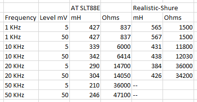

I did some measurements of some vintage MM cartridges I had here with an ESI Videobridge. The Realistic has a resonance at around 32 KHz and reports negative inductance at 50 KHz. The Audio Technica seems to go higher before self resonance.
I measured at 5 mV and 50 mV. At 5 mV the level limits the resolution and accuracy. The only reference inductor I have on hand is 10H, a little too large to be relevant for checking 5 mV vs. 50 mV but its consistent with showing a little less inductance at 5 mV.
if more details are needed I can set up to sweep with an impedance fixture to 100KHz (or with the Bode to 30 MHz).

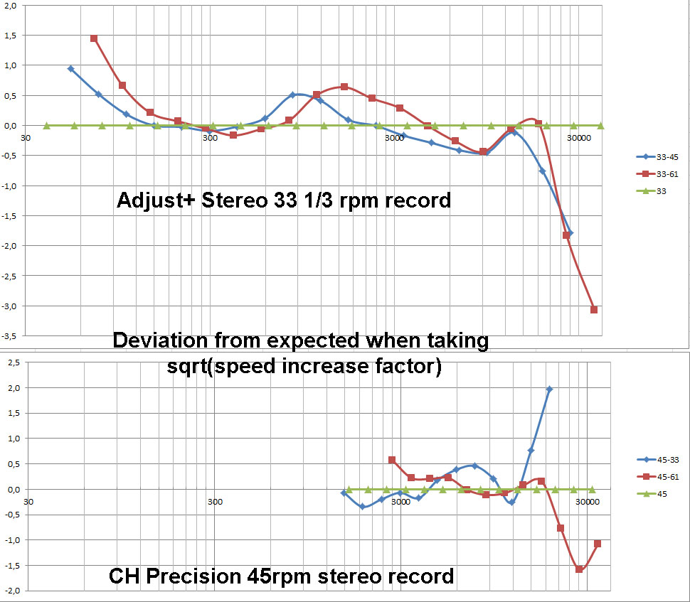

I did a very interesting discovery.
On the Adjust+ record, there are sweeps from 20Hz to 20kHz, resp. in stereo and for both channels in mono.
When going from 33 1/3rpm to 45rpm, the stereo channel has the same pattern as the PN recording, resulting in a level deviation of -1.3dB over most part of the frequency range.
But now it comes: When making the same speed step with a mono signal, level deviation becomes zero !!!
So a stereo signal seems to increase its level with the sqrt of the speed increase factor whereas mono has a direct proportional relation.

Here are again the previous images made with PN, but now corrected for the sqrt of the speed increase and for both records now on the same scale.
Most of the deviation is this time +/- 0.5dB around zero dB.
Images with deviations for the sweep from 20Hz to 20kHz in stereo and the same for a track with only one channel to follow.

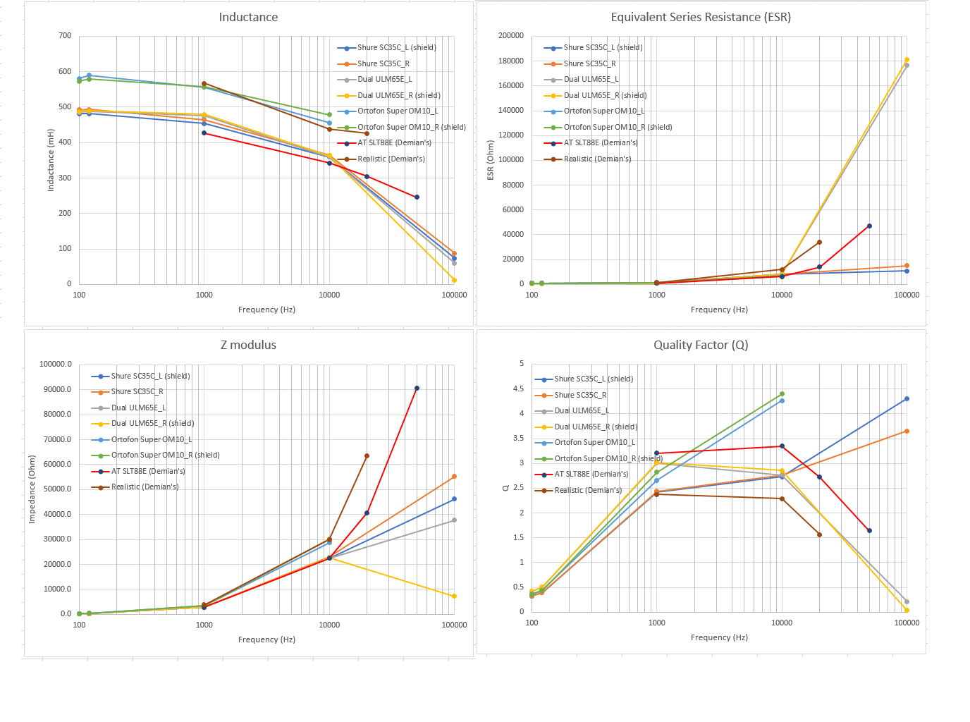

Thanks Demian
I added Demian’s cartridges data into the previous diagrams from my measurements for comparison.
George

Forget for a moment what I thought was going on.
I'm using Right Mark Audio, but this program appears to do some internal level shifting depending on the content, causing that levels are not absolute but only relative.
I should have remembered this, because many years ago I had a similar problem.
The last images, showing a deviation around zero are probably right.
I will try to find another program without this evil.
Hans

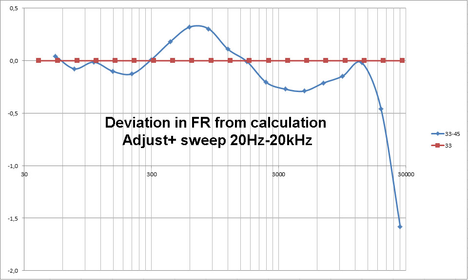

This time I've added the 33-45rpm calculation for the 20Hz to 20kHz sweep from the Adjust+ record.
When shifting the obtained deviation curve to around 0 dB, result is practically the sameas as with PN.
For that reason I have skipped the 33-61rpm calculation.
Since we are looking here at sliding frequencies instead of noise, giving however comparable deviation results, my belief is again that using spot frequencies will unlikely lead to different results.
The only question that remains unproven is the exact level change when changing record speed, because of the nasty AVC function in RMAA.
I accept the most logical conclusion and that LD is right, being that level changes directly proportional to speed.
And Scott, your worry that just another correction function could be needed to compensate for constant velocity errors after having changed the speed, didn't shown up here, but of course that doesn't prove that this holds for all Carts.
Hans

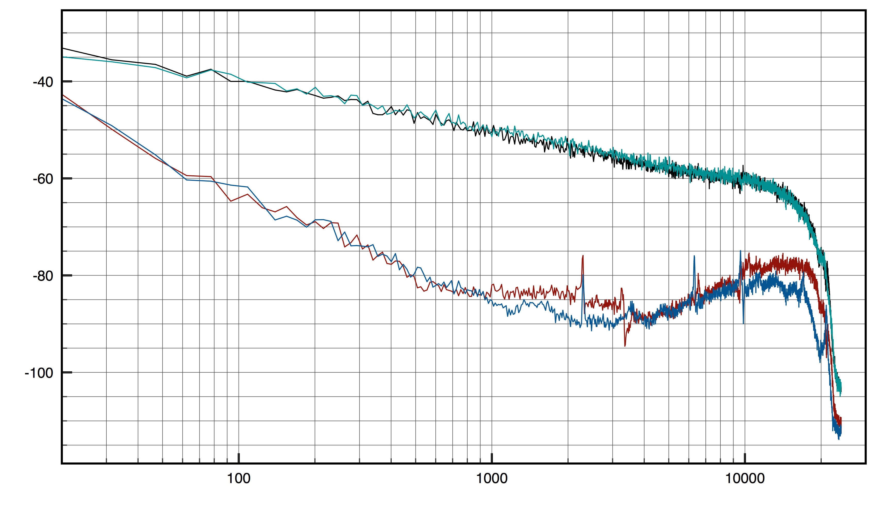

Thomas post with the FFT of pink noise from the Ultimate test LP, made me look back on some older recordings I had made.
With a different cart, things look a bit different (the glitches Scott noticed)
George
I looked up my Hifi News test record Mk1 and made the left and right only pink noise with the corresponding crosstalk. It looks quite normal.
Those spikes in the crosstalk are not normal.
The Hifi News test records have flaws as most of the today available test records have. So I can't say what is normal.
