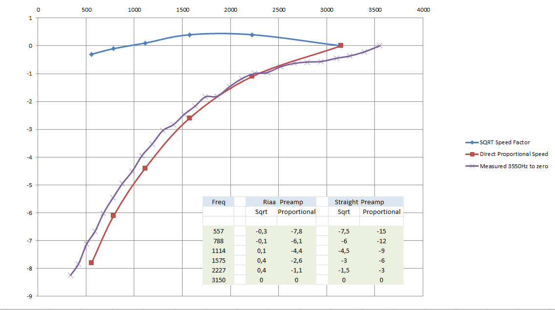

Yes, I let the first track (3150Hz speed calibration tone) on the Adjust + spin down freewheeling from 5kHz to 640Hz and saw no issues.
Scott,
It took me quite some time to get results to within +/-0.5dB while performing this test.
I used the same methodology as before, and calculated the level curve, as well for a square law as for a direct proportional relationship between speed and level.
In the image below the two calculated curves are drawn, together with the measured curve.
Deviation of only +/-0.5dB from the calculated curve proves two things:
1) level is directly proportional to speed
2) the math used to predict this seems to be accurate.
Now I'm still faced with the problem why for all the other measurements, six in total, level has to be corrected by exactly 10*log(speed change).
Hans

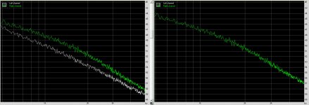

I checked in the most detailed way my calculations, but after all in the end the mysterious discrepancies in level versus rpm, has to be fully accounted to RMAA.
The left side of the Image below has both R channels mixed of 33 1/3rpm and 60.75rpm stereo recordings merged into one stereo track.
On the right side is only the R channel of the original 60.75rpm stereo track.
Both green lines are exactly the same in shape but not in level, although they are one and the same.
Ergo, RMAA is capable of showing the perfect shape of a spectrum, but is not exact in showing the level, sorry George, I'll have to come back on my earlier remark.
I'll try to communicate this again with Maxim Liadov.

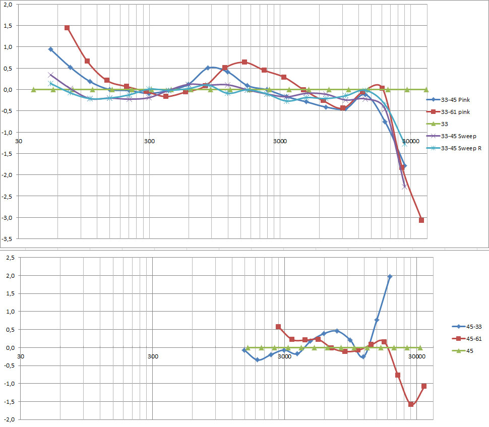

I have now completed my measurements, beginning with the 45rpm CH Precision record at 33 1/3 and at 60.75rpm, with Pink Noise.
Next I have measured the 33 1/3 Adjust+ record with Pink Noise at 45rpm and at 60,75rpm.
From the same record I have measured a frequency sweep from 20Hz to 20kHz at 45rpm, and as a last step I have measured a track only modulated on one channel, with the same sweep.
Results with these sweep signals are even closer to the predicted level, almost to within +/-0.25dB.
In all cases, the result is that deviation from the calculated curve versus the measured curve is within +/-0.5dB up to 20kHz.
One thing is remarkable: when speeding up a record, levels above 20kHz are becoming louder as expected in all tests, PN and Sweep, and going the other way down from 45rpm to 33 1/3rpm, the high frequencies are dropping in level vs expectation. No idea why.
I see no further reason with this Cart to add any additional correction for constant velocity errors and that was the primary objective of these tests.
Hans
