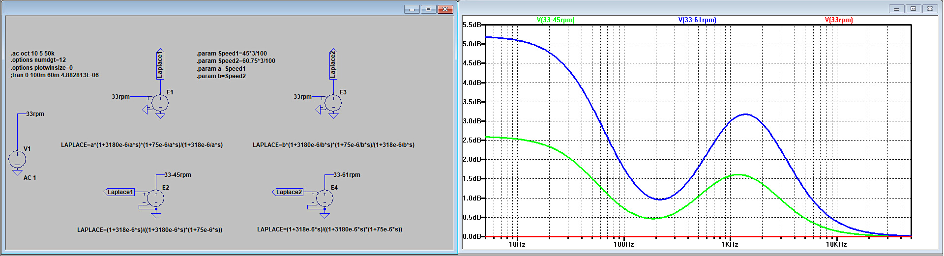

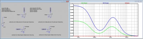

I adjusted Level in the same ratio as the change in rpm, resp a and b in the image below.
And Mapping the old Riaa into the new Riaa was done accordingly with the same a and b.
a= (45)/(33 1/3) and b = (60.75)/(33 1/3)
So I think I did everything the way it should have been done.
Hans

You are applying Riaa in the digital domain, aren’t you
In that case it wouldn’t seem to be any problem for you to digitally remap the Riaa time constants when changing speed. After that, all that remains according to LD is a fixed level shift over the complete spectrum.
Or are you referring to something else with “extra correction”
In that case, what could be the reason for and the nature of this extra correction ?
Hans

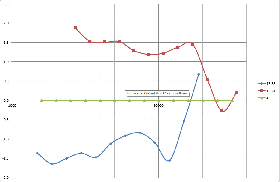

This is the first set of results, in this case taken from the CH Precision measurements.
What I have done:
1) Measured the 45rpm levels at 1/3 octave intervals starting from 2Khz up to 25.4kHz.
2) Calculated the new frequencies for 33 1/3 and 60.75rpm from the used frequencies at 1) by multiplying /dividing them with the factor 1.35.
3) Added to the measured level values in 1) the calculated change in level when going resp. a factor 1.35 to 33 1/3 and 60.75rpm.
In this change the exact Riaa has been mapped, plus the assumed change in level as a fixed number, in this case resp -2.6dB and +2,6dB.
The result is what can be called the "expected level".
4) Measured the levels at resp 33 1/3rpm and 60,75rpm, and calculated the difference with regard to the expected level.
Example: At 45rpm the level at 4kHz is -59.2dB.
4kHz becomes resp 2936Hz and 5400Hz when going to 33 1/3rpm and 60.75rpm.
Expected level change because of A) Riaa and B) 2.6db in speed caused level change will be resp -0.7dB for 33 1/3 and 0.4dB for 60.75rpm.
Measured level at 2936Hz is -58,5dB and -60.3dB at 5400Hz.
Level difference from expected at 33 1/3 Hz is: -59.2dB-0.7dB+58.5dB =-1.4dB
Level difference from expected at 60.75rpm is: -59.2dB+0.4dB+60.3dB =1.5dB
In the image below, these differences between measured and expected are visualised.
The only variable in this is the level change. The measured values and the Riaa mapping are as exact as they can be.
It becomes obvious that the expected level change of 2.6dB when changing speed 1.35 times, is not correct.
The two images with an accuracy of within +/-0.5dB, are almost complementary to each other, making the probability that they are correct quite high IMO.
For the most part of the frequency range, deviation is ca 1.5dB.
Is this part the constant amplitude part of the spectrum ?
And from above a certain frequency, where deviation drops rapidly to zero
the constant velocity part ?

Hans, this would be a lot easier with spot frequencies.
The theoretical basis here is that the pink noise is really pink, the RIAA pre-emphasis is exact, the pre-amp's RIAA is exact, and the cartridge is perfect. There are too many degrees of freedom to isolate where the problem resides.

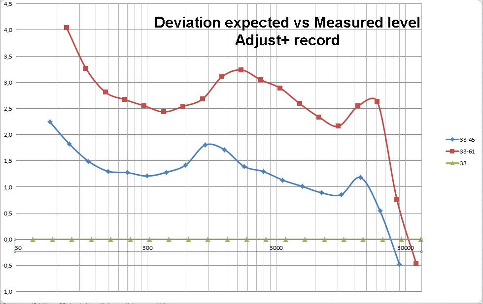

Here are the results for the Adjust+ record.
This time going resp from 33 1/3 to 45 and 60.75rpm.
Procedure is the same as for the CH Precision record, but now with 1/2 octave steps.
The same thing happens here, for most part of the frequency range, level doesn't go up by 2.6dB and 5.2dB for both speed steps, but only half that amount with ca 1.3dB and 2.6dB.
Only at the high end of the spectrum. the deviation in expected versus measured level goes to zero.
Hans

I did use spot frequencies, 1/3 octave apart, didn't I ?Hans, this would be a lot easier with spot frequencies.
To my opinion Pink Noise plays no part at all in this case.The theoretical basis here is that the pink noise is really pink, the RIAA pre-emphasis is exact, the pre-amp's RIAA is exact, and the cartridge is perfect. There are too many degrees of freedom to isolate where the problem resides.
I just pick a frequency, measure the level, map that frequency to a different rpm, map the Riaa and adjust level with the factor of the speed change and finally compare this calculated level with the measured level.
With white noise the procedure would have been exactly the same.
I would be glad to hear if and where my assumptions are wrong.
Therefore. the only variable that remains to my best knowledge is the level, where it becomes clear that the level does not change as assumed as a fixed value to the same amount as the factor in speed change, but over a large part of the frequency range it's closer to the Sqrt of the speed change factor.
Hans
