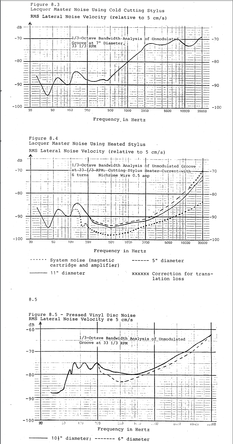

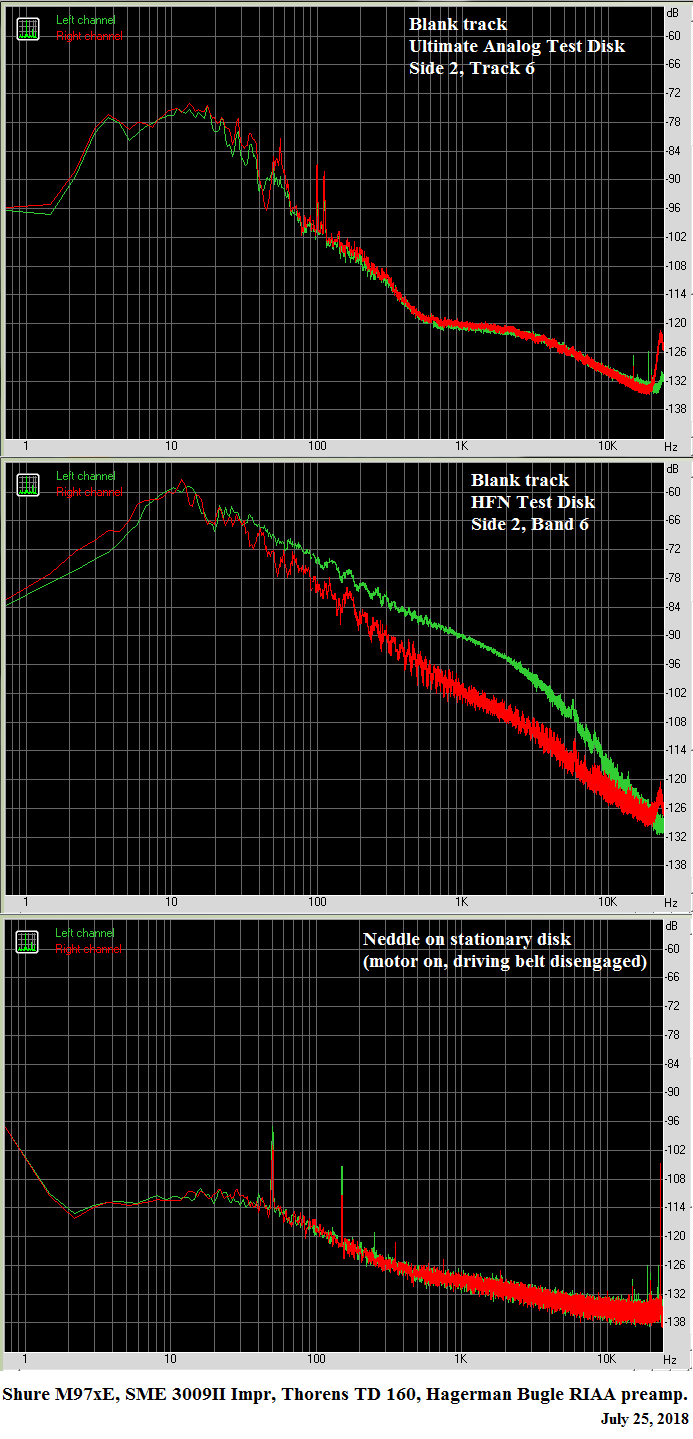

What I can offer you so far is the following.
Starting with the assumption that noise from the LP is flat, after Riaa compensation it will have to follow the Riaa curve.
See first attachment from the same Ortofon paper, surface noise not exactly flat.
Then some recordings of mine. Even for blank groove noise spectrum, we are at the mercy of the various Test LPs.
I can’t find my flat recordings now, I have to make some new.

In the Ortofon paper chart for vinyl pressing George posted above, the shape of the noise versus f curve fits fairly well with scaling by rpm. There is then also the expected level difference in playback level between inner and outer radius tracks, which roughly scales with rpm even for surface noise. I suppose this suggests groove surface roughness/tribology is what it is when the record was made: playback reproduces this and is not the limiting factor?

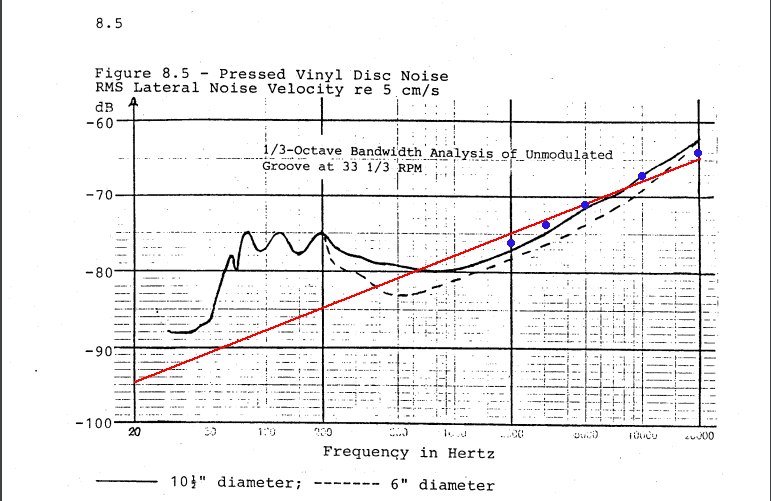

George,
Thank you for making this info available.
Fig 8.5 concerns the pressed vinyl version, so I concentrated on that one.
Surface noise is shown in 1/3 oct bandwidth, resulting in an upgoing spectrum with 10dB/oct.
I have drawn in red this 10dB/oct line, showing that from a few hundred Herz up to 20kHz, surface noise is flat within a few dB.
I have painted in blue dots the results of my recent measurements, the same data that was also used in the table.
Results conform very well to each other as can be seen.
Hans
P.S. My assumption was that no Riaa de-emphasis was used at play back.

The Ortofon cutter chart noise measurement more or less confirms what we know - that surface noise spectrum is dominated by roughly a 1/f flicker law below a few hundred Hz, and is otherwise dominated by a white-ish noise floor at some cross-over point.
All of which is statistically random, and subject to crest factors etc etc.
If RIAA playback is used to play back a silent groove, this will all be subject to RIAA deemphasis curve which mostly aggravates the 1/f noise content and suppresses the hf content.
There shouldn't be cutter-induced deviations in the f domain, because there should not be cutter modulation in a silent groove. Anything that is left over and permanent in the groove prob either arises from the lathe table, or cutter screw. But seems to be dominated by 1/f noise at lf and white noise at mid/high f whatever.
