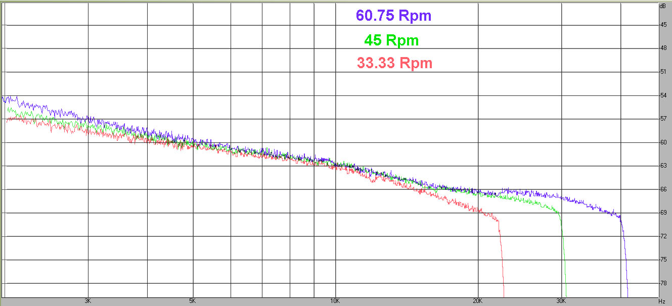

Take 20kHz and 27kHz from a Pink Noise spectrum at 45rpm.
With PN, output level at 20kHz and after Riaa will be 1.3dB higher than at 27kHz.
Before Riaa level of 20kHz will be 1.3dB below 27kHz.
Now play this record at 33 1/3 rpm and 27kHz will become 20kHz but at a 1.3dB* lower level before the preamp, just as the original 20kHz at 45rpm.
But because of the Riaa correction, with 2.6dB less attenuation at 20kHz, it will show up at 1.3dB above the level it had before at 27kHz.
So the original 27kHz at 45rpm, now being 20kHz at 33 1/3rpm, has been transformed into exactly the same level as 20kHz at 45rpm..
And since there is no level change, 20kHz at 33 1/3 should show exactly the same level as 20kHz at 45rpm.
*The prove for the above is that from 10kHz and downwards, the curves for 33 1/3, 45 and 60.75rpm are lying on top of each other, see image below, all being recorded at the same Fs, FFT setting and amp gain.
That they are drifting apart towards 2kHz has everything to do with the wrong pre-emphasis, see second image, but when corrected for this deviation, they are exactly on top of each other
So when seeing that curves are no longer on top of each other, which is most prominent the case with 33 1/3 vs 45 rpm from 10kHz to 20kHz, only the Record can be blamed for causing a different output and not the level dependency of the Cart.
Hans

A correction to my posting concerning the level change.
When the record goes from 45rpm to 33 1/3rpm , level before Riaa does not drop by 1.3dB but by 2.6dB.
But the Riaa curves does two things:
1) attenuation at 20kHz is 2,6dB less than at 27kHz, bringing the level to 0dB, but
2) the pre-emphasis error is also causing an extra boost.
So that the curves are on top of each other has everything to do with the pre-emphasis error, but in fact the level of the signal is indeed a bit lower at 33 1/3 rpm as at 45 rpm for the same frequency , bit only some 1.5dB.
It is hard to believe that such a small change in level, leads to such a large difference between the 33 1/3 and the 45 rpm FR curve.

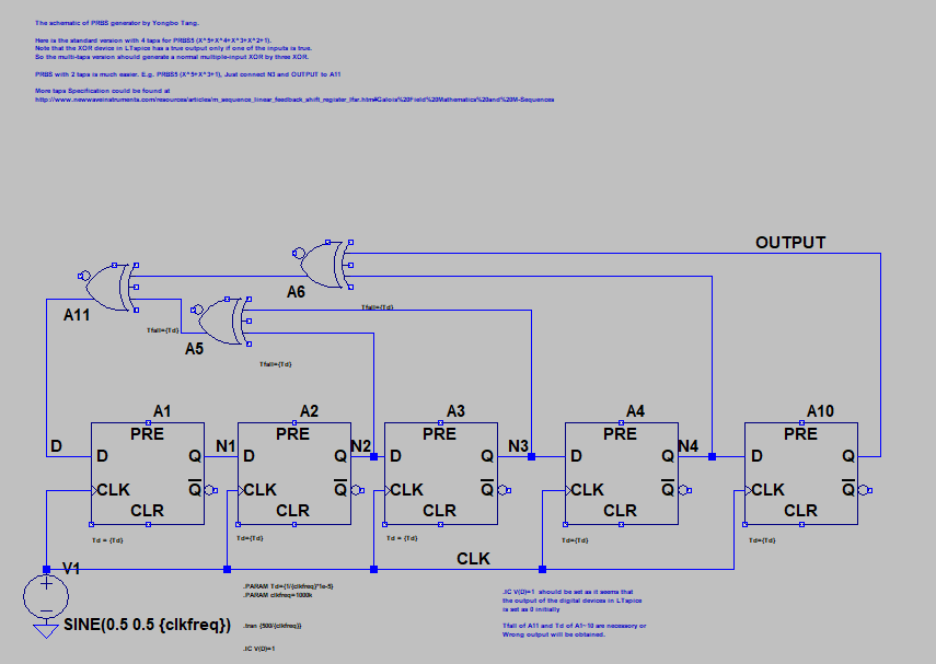

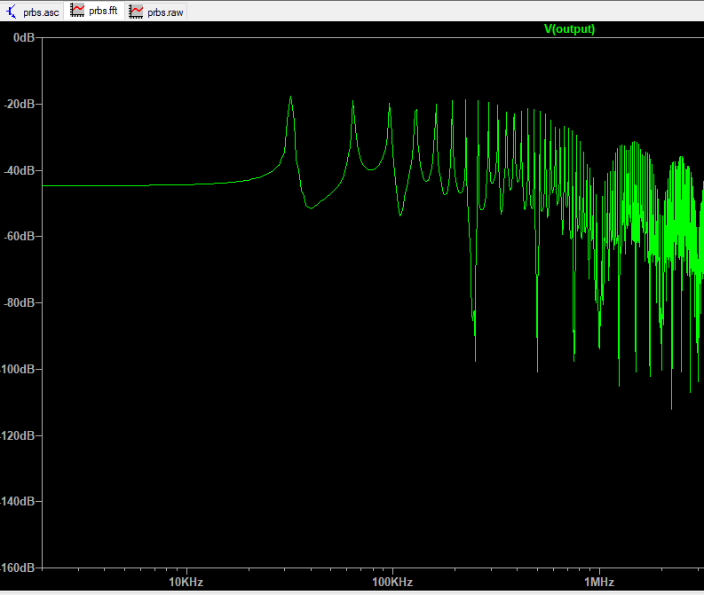

I took a look at a simple 5 stage PRBS white noise generator, common a few decades ago with a low pass to make pink noise.
You can see a serious glitch at around 30kHz
A different clock or shift register length would move the glitch wherever you want it

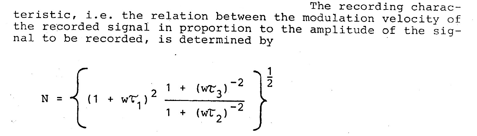

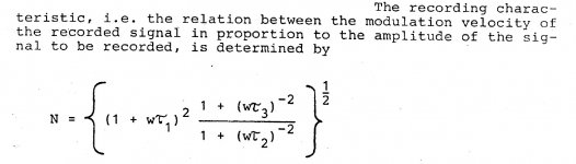

In a link given by George, I found the info below from an Ortofon record cutting machine, showing a sqrt ratio between modulation and signal amplitude, see image below.
Don't know what that equation defines, but whatever it is a dimensionless correction constant? Seems to be some frequency compensation, and the sqrt term cancels. If all the terms in tor are zero, the constant is one. I think this is a red herring, probably.

From the fourth link
Cartridge dynamic behaviour
George
Thx George, that's a good read anyways. Interesting that cutter feedback gain was controllable via a pot...…….one would think, by design, there was an optimal setting.
Anyways, that equation simply describes RIAA compensation gain as a function of f, in different form from what's usually presented. The three time constants are the poles and zero from RIAA emphasis/deemphasis.
I'm sure that equation is a red herring.

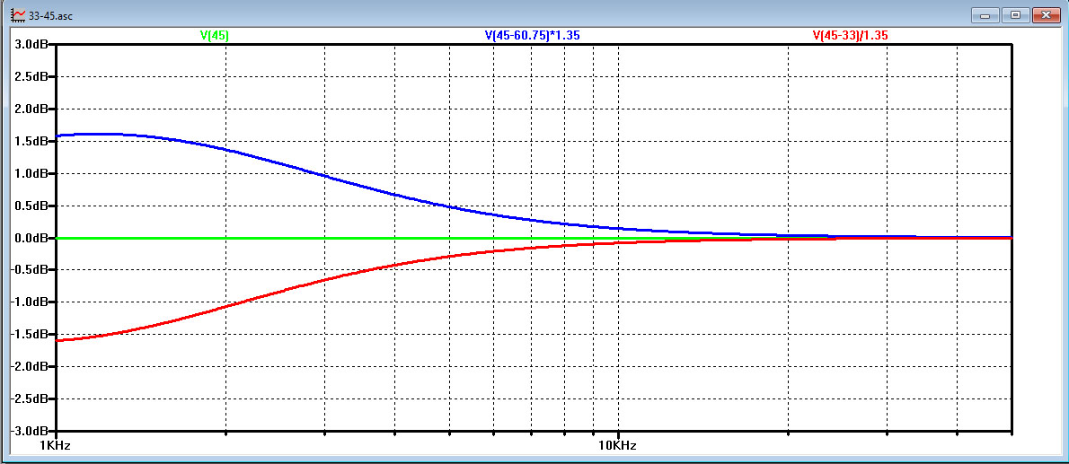

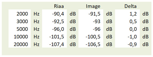

That was also my line of thinking and that was the reason why I made a correction #847 to my previous posting in #845.
But's let's face the facts:
1) the recorded images in #845 from 5Khz to 10kHz are on top of each other to within +/-0,5dB, all taken with exactly the same settings and being reproducbly within tenths of a dB.
After correcting for the Riaa Pre-emphasis error, also shown in #845, they are within +/-0.5dB from 2kHz to 10kHz.
2) The Riaa curve between 7.4kHz and 10kHz, goes down with 20dB/oct, so when shifting 10kHz down by a factor 1.35 to 7.4kHz, Riaa will attenuate this downshifted frequency 2.6dB less after shifting.
3) In a Pink Noise spectrum 7.4kHz lies 1.3dB above 10Khz
-Said image shows that the new 7.4kHz at 33 1/3rpm came up by 1.3dB within 0.5dB on the same level as 7.4kHz at 45rpm. (3)
-Riaa boosted the new 7.4kHz by 2.6dB (2)
-The only remaining 3rd variable is now the reduction in output level because of reducing the speed by a factor 1.35.
So to get the final 1.3dB lift after first being boosted by 2.6db by Riaa, level reduction by playing at a lower speed can only be 2.6-1.3 = 1.3dB.
Resolution of the images are to such a degree, that when level reduction would have been 2.6dB instead of 1.3dB, this extra shift of 1.3dB would have been clearly visible.
However this is not being the case.
So could it be that it is power that goes down by a factor 1.35 and not the output voltage ? In that case we would have solved the problem.
On top of that, I cannot neglect that for a record-cutter "the relation between modulation velocity and the recorded signal in proportion to the signal to be recorded" shows an obvious sqrt relation, why is that ?
To say this to be a red herring, seems a bit simple. 😀
Hans

Hans, both your plots of surface noise (#817,#820) show a break at 10k from a constant slope, can you calibrate with a constant velocity sweep and none of these math corrections?
What I can offer you so far is the following.
Starting with the assumption that noise from the LP is flat, after Riaa compensation it will have to follow the Riaa curve.
That's why I compared both, after having brought Riaa to the same level at 5kHz.
