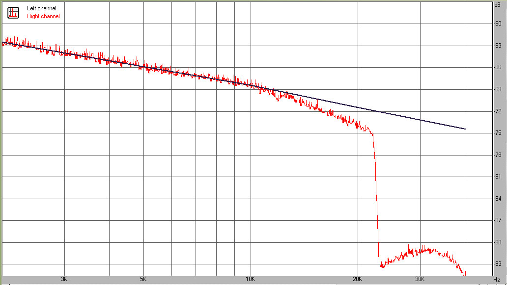

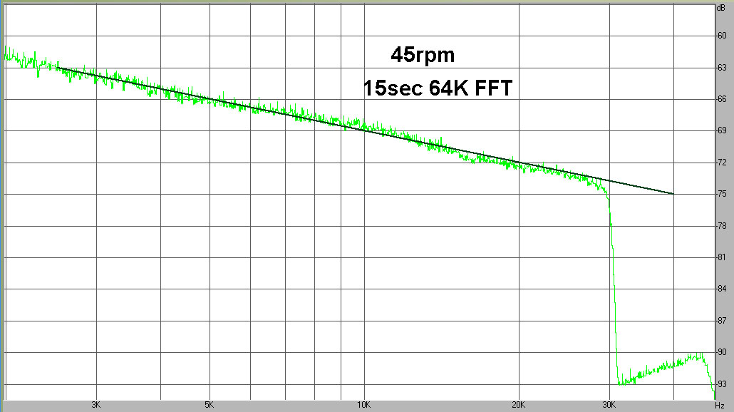

I have checked everything again, but results with the CH-Precision record are very repeatable.
Instead of a 16K FFT, I have now used a 64k FFT to get even more detail in finding eventual resonances, but with no effect.
In all three speed versions, I have drawn a black line belonging to the -3dB/oct pink noise rol off.
This line is already corrected for the deviation of the wrong Riaa time constants when playing at 33 1/3 and 60.75rpm.
The 45rpm version is almost perfect within +/- 0.5dB.
The 60.75rpm version isn't too bad either, but showing +1dB lift at 30kHz.
But what really bothers me is the 33 1/3 version that starts going down from 10kHz at 6dB/oct instead of 3dB/oct.
I expected this to be a piece of cake playing a 45rpm record at 33 1/3 rpm, but for some reason this does not result in the expected curve.
Can anybody explain this behaviour when playing at 33 1/3 rpm ?
Hans

The 33 1/3 rpm Adjust+ LP gives a perfect image at 33 1/3 rpm.
The 45 rpm CH Precision record gives a perfect image at 45 rpm.
It is almost as if a record only performs correctly when played at the intended speed.
Just a coincidence ?
Scott,The plot thickens.
You once made a .wav filled with white noise, by starting with a flat complex conjugate spectrum and taking the inverse FFT.
This was performed with a 64K FFT.
When calculating the spectrum from the .wav file with another FFT length, the result was inferior.
Could it be that a similar situation is the case here when playing synthetically created pink noise on a different speed.
Both companies, Adjust+ and CH Precision confirmed to me that it been a hard challenge in getting things right after several attempts.
So it was obviously not just as simple as: create a noise file and put it on the record.
Fact is that the measured results do not conform to the expectation, unless played at the speed that the record was meant for.
Just another mystery ?
What's your opinion on this, thickening plots do not seem to apply.
Hans

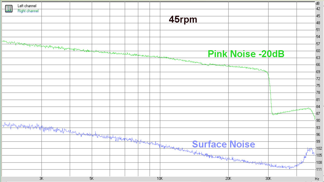

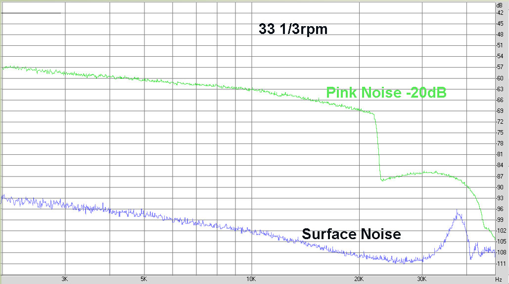

Pink noise at 45rpm versus 45rpm surface noise from the same record, displayed on the same scale.
As it seems, surface noise is in al cases >35dB below signal level, so I don't think it can play any role at all, do you agree ?
Hans

Thanks Hans for the fast factual response!
The level difference wouldn’t support the scenario.
But the decisive evidence is that in both replay speeds, the surface noise btn 7kHz-30kHz drops by 6dB/oct. No change there.
So my scenario is wrong.
