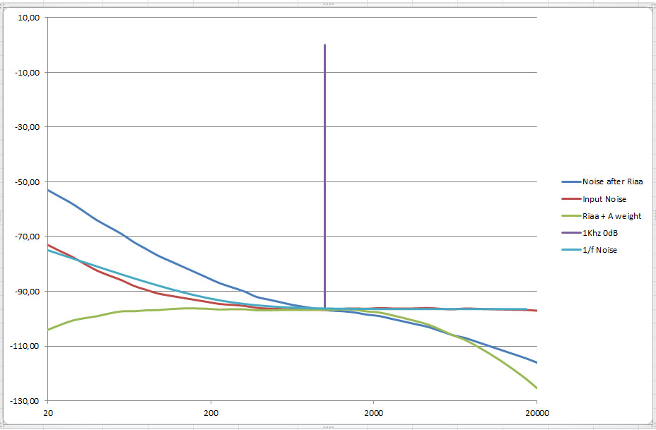

so I don't think it can play any role at all, do you agree ?
Yes, I would also think the surface noise a high frequencies would have a flat spectrum. It looks like there is a slight break at 10k, coincidence? Another scenario these guys went back and forth to correct for some speed related component of tracing error, need LD on this one. In that case sweeps might show the same anomaly.

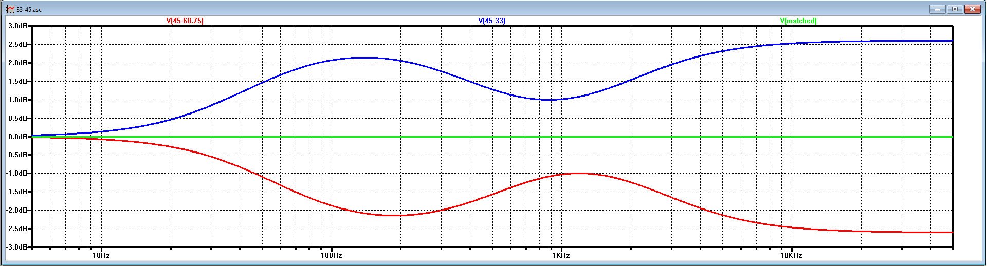

Riaa pre-emphasis errors, caused by playing at different speeds, were corrected in the black line in the images at #808.Except RIAA pre-emphasis is there for just that reason. The sampling artifact (33 play of a 45 is essentially re-sampling at a lower frequency) is appealing but I don't see it acting the way it is. It's also worth exploring if the sinc() response correction has anything to do with this (if the noise is actually digitally generated).
Image below shows the calculated deviation that's being used for drawing the black lines.
The sinc correction tip is an interesting one. The question is though at what frequency the digital noise file was created. To get >30kHz on the calibration record, it must have been at least 96kHz.
To correct for the sinc attenuation while reconstructing a 96kHz file, correction at 30kHz should be ca. 1.5dB .
Now playing such a file at lower speeds, would result in overcorrection, resulting in a curve going upwards instead of downwards.
That's the opposite of what we see.
I'll try to find out what sample frequency was used on the calibration disk and how this can possibly interfere with the results.

Correct, surface noise has an 1/f character, and after a few hundred herz it's flat, however after being Riaa processed, its going down.Yes, I would also think the surface noise a high frequencies would have a flat spectrum. It looks like there is a slight break at 10k, coincidence? Another scenario these guys went back and forth to correct for some speed related component of tracing error, need LD on this one. In that case sweeps might show the same anomaly.
The image below shows how surface noise compares to 1/f noise and what it does after Riaa.
Hans

Since the surface noise is >60 times smaller as the composite noise, it only contributes for 0.001dB to this composite noise, because:
20*log(1^2+(1/60)^2)=0.001dB
In other words, surface noise plays no role whatsoever.
Hans

The correct pink noise we seem to have this far, when records being played at their intended speed:
A) from a 33 1/3 Adjust+ LP, producing pink noise from 20Hz to 2kHz within +/-0.5dB and
B) from a 45rpm CH Precision disk that's also correct within +/-0.5dB from 2kHz to 30kHz.
Playing the CH Precision record at a higher speed, means that a correction has to be made to correct the bump between 20kHz and 40kHz, see:
