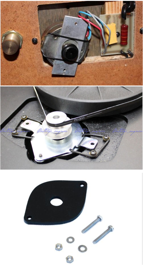

Scott re vibrations
I would suggest to start with the electrical part of your ac motor.
Find the optimum operating voltage and the optimum phasing capacitor value for minimum motor vibration.
Use a stethoscope or a screwdriver touching your ear or a piezo disk on oscilloscope as vibration sensors directly on the motor (motor can be dismantled from the TT)
Then target the vibration path from motor to plinth, to platter, to disk.
1. You have to add some compliance between the motor and the plynth.
Suspending the motor with a small rubber belt as Rega has done is easy and very effective, better than the rubber grommets.
2. Add some compliance between platter and disk.
Use a softer platter mat. Make one from a piece of velvet fabric, it’s good.
You can search ebay for felt, silicone or sorbothane mat.
Note. A soft mat does change the playback sound, makes it softer. Test with a record having lute, classical guitar, piano. Notice mostly the attack of a note.
Motor suspension and driving belt softness/tension also affect the sound in that respect but less than what the mat does.
I think you won’t have to go further than this.
Technical curiosity may drag you toward difficult paths (building another plinth with different materials, making a separate housing for the motor away from the TT plinth ect). You will risk becoming an audio fetishist. 😀
George

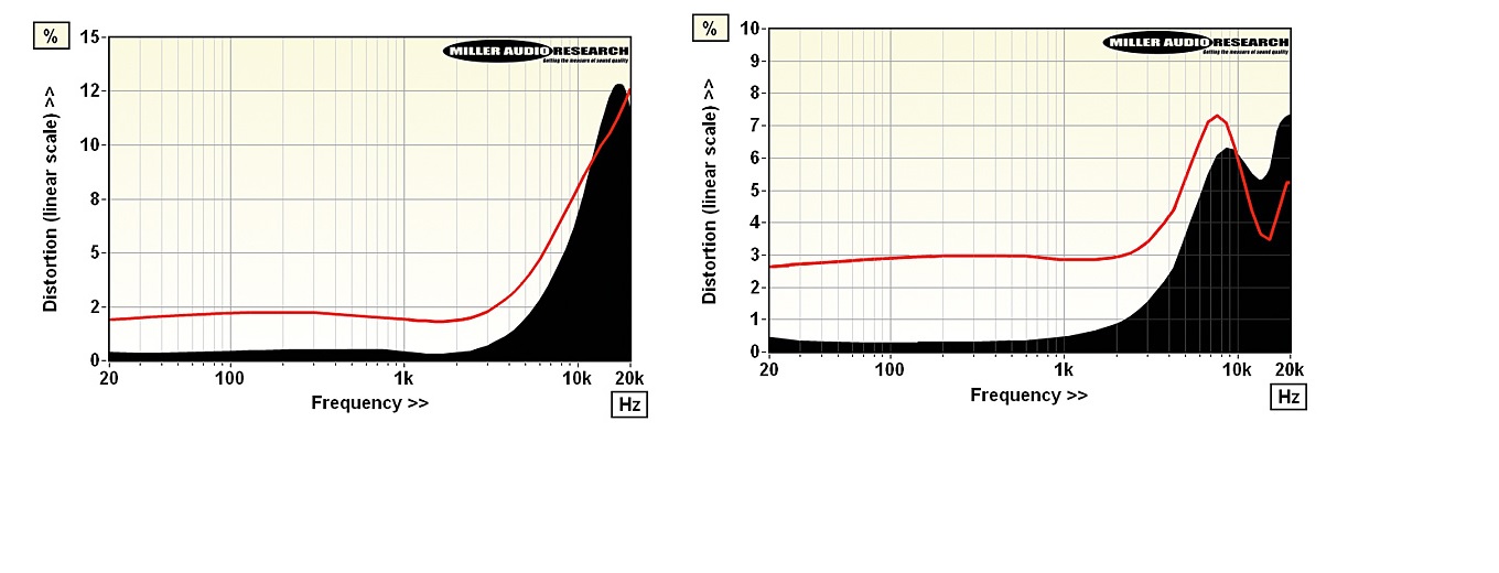

@LD: It would be comforting if all the cartridges showed similar peaks. The fact that they don't does suggest to be a resonance showing up. Another string to pull on at some point.
I'm a bit lost.
If we mean the peaks c. 3kHz/9kHz/? series that Scott and Hans found in crosstalk, I have not seen those before and that seems to be a widespread test record issue.
The series of peaks that runs c 15-25kHz/40-50kHz/? is almost certainly cantilever self resonance IMHO. This does vary between carts and shows up on all records in principle. I suppose it could happen at lower f, but that would not be good, though colourful...….
LD
Hans: thank you. Will pm as soon as I get on the computer without my little helper!
LD:LD: was referring to the fact that the miller measurements show a distortion peak at 6-7kHz which might infer a resonance at 12 or 18kHz. The Jo #5 shows this peak at a much higher frequency. Something doesn't quite stack up.
Ah, got it. You mean the DS-W2 report: there's much about that looks plain odd and not in a good way...………………..
I suppose it could be cantilever impedance dip at 6-7kHz...…….whatever it looks like mistracing/mistracking around that band, recovering at higher f. But the f response looks weird too...…..??
Those carts don't track too well, do they ? Should have a two horse race on measurements versus the S-120 😉
LD
Scott re vibrations
Thanks all good ideas but the motor is 24V AC no mains. I have a good miniature accelerometer to scope out were it's coming from, and I'm thinking some lead sheets and Ed's double sticky tape might help. 😀
Attached might explain a bit more what I was getting at. This is the Kiseki blue vs EAT Jo 5. Source Miller audio research.
The Kiseki is a 5x120um (Gyger?) and the EAT is 8x40um (shibata?) so both should be as low as tracing distortion can get. Haven't had a chance to adjust the graphs for scale differences so it should be noted up front that they both have about the same distortion at 8kHz but after that behave very differently.Also odd is that the kiseki has a very un-MC like frequency response with a peak in output lining up with the dip around 15kHz. .
If the diamond is pulling 500G in this test I can help thinking of a metal ruler held against a table and being twanged, although an epee is probably close to it 🙂.
Now PM usually puts in a comment about these peaks being due to extended frequency response, so I can only assume he's measuring 2nd to 4th harmonic in this test. But without more information on the measurement setup this is guessing. Something interesting is shown there, just not sure what at the moment.
Do you know if they measure both channels? And what test record they use? I can surely see differences in the HF region that is not consistent between channels.
The Gyrodec is indeed beautiful. I wish I had bought one when they were only £700. I did visit them once to get some spares for a transcriptor I got for a friend.
@Thomas The filled black is Lateral red is vertical. No data on test record etc.
I ended up buying a special kit from the local importer (Henley here in the UK) that included a new belt, some rubber washers etc for about $35. I fitted them and there was a substantial drop in the noise.
Mine is the same with belt off and motor running so first line of attack is motor mount. The chance of me doing $3000 + for anything audio is nil, just my upbringing, my father's creed was don't pay anyone good money for something you can do yourself and don't pay interest on anything.
If the motor is a synchronous two coil (four wire out) , all the suggestion for the main’s motors is applicable to it too.
Alternatively, a new world of possibilities opens up 😀
YouTube
George
Scott, try using a sound card to help with the noise identification and analysis. In the Project case more pliant rubber motor mounts and a new type of belt dropped the noise about 15-20 dB.
Loosening the motor mounting screws also helped ( the motor was suspended on thick rubber bands IIRC - these were not changed in the upgrade kit).
You’re an engineer, you could of course remove the motor and mount it off board - just ‘sayin 🙂
