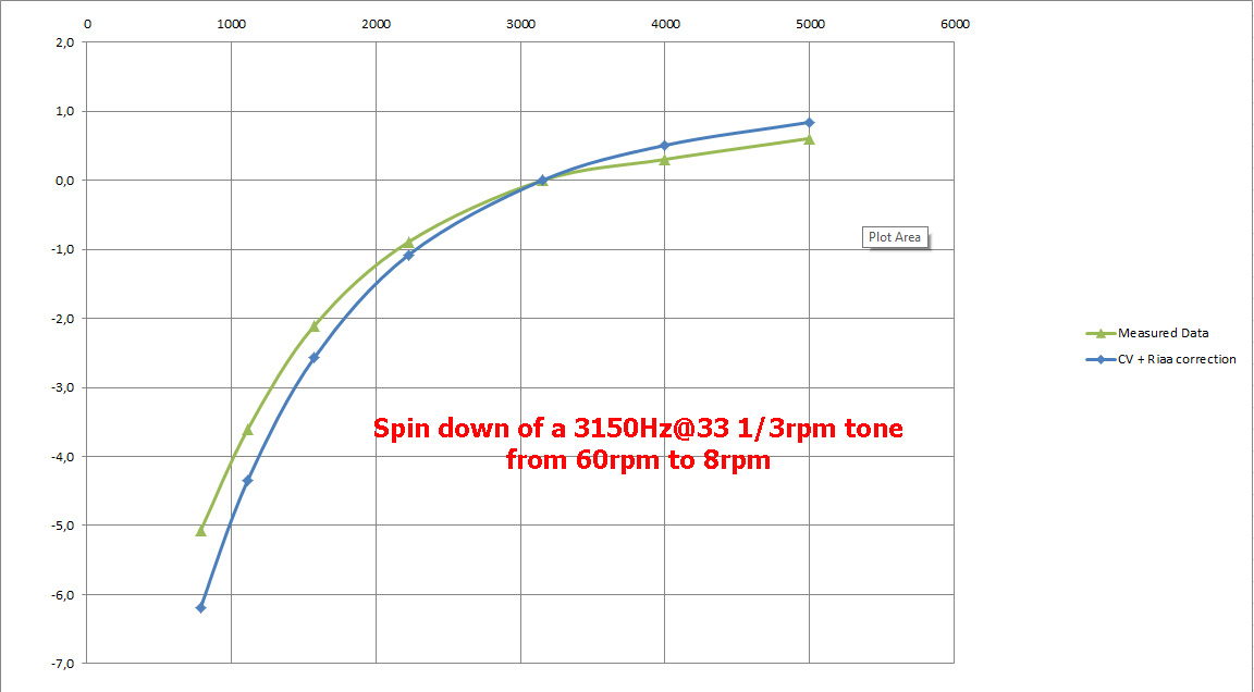

Scott made a spin down from an 3150Hz@33 1/3rpm tone starting at a much higher speed and measured from 5Khz and downwards.
He reported a velocity error of 2-3dB at 5kHz.
On the other hand, our PN spectra from the same record matched perfectly from 1kHz to 6kHz.
For that reason I made the same spin down, this time from 60.75rpm downwards, now also starting my measurements at 5kHz.
The image below shows the measured data versus the calculated curve, being corrected for velocity and Riaa.
There is no such deviation of 2-3dB visible at 5kHz, and since it is difficult to measure this with a reasonable precision, there must have some error slipped into Scott's measurement/calculation.
Because having the same PN curve from 1-6kHz, but having a difference in velocity errors of 2-3dB at 5kHz, simply do not match.
Hans
P.S. The 30.1Mb .wav file used for making the spin down image is way too large to post it here, so send me a PM if you want it.
No it's not the Hilbert transform yields the instantaneous frequency and amplitude directly, (here 30sec as a 1,323,000 point transform) there are no errors in my measurement. This is the same technique I used to reproduce Lucky's turntable speed circular plot. After some work we got the two to almost lineup perfectly.

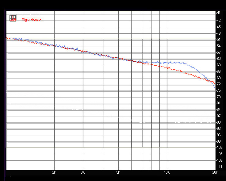

Han's this is the 1k to 20k section of the Adjust + sweep on side B my cart has the mid-range dip the PN can not be flat. The pre-amp is ~ +-0.1dB to RIAA. I used my pre-amp here this is an almost perfect match to the flat CV sweep on the CBS disk.
